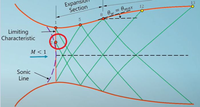

I have a question concerning the example in lesson 6 ((288) Method of Characteristics — Lesson 6 - YouTube) on how to calculate the flow field of a CD nozzle with MOC. The lecturer starts in this example with point 2 that is situated in the throat of the CD nozzle. When I try to start my calculation at this point it fails, as the characteristic line is perpendicular to the flow. In the example the characteristitc line is not perpendicular but has a certain angle. How can I find this angle?

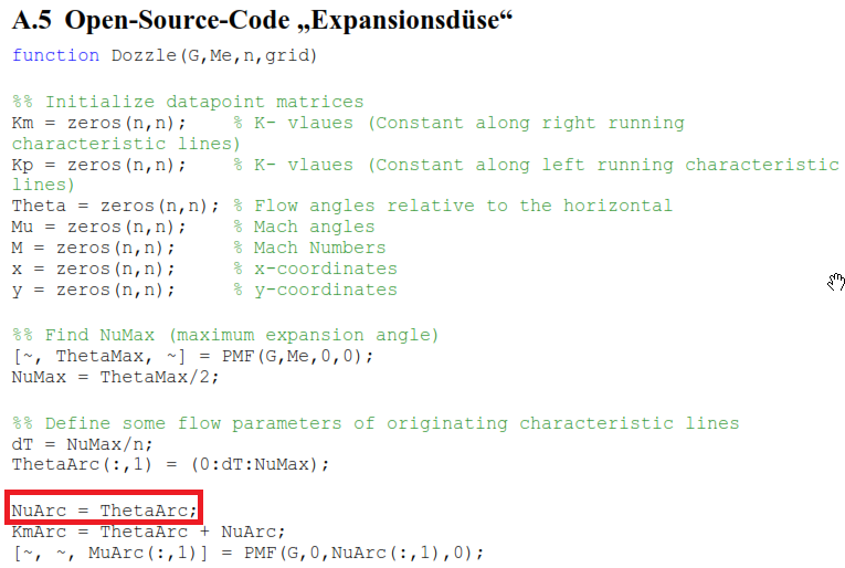

In the further course nu of point 5 is calculated by using the characteristic line C+ of point 3 and theta 5 of the expansion arc. I would assume, that theta and nu are already known on the expansion arc as they have the same value. I've also found this assumption in an open source NASA code
If this assumption is correct wouldn't it be much easier to start the calculation with the characteristic lines on the expansion arc?

Characteristic Line Angle at the Nozzle Throat (Point 2):
- In the MOC method, the characteristic lines represent the direction of the flow velocity. The angle of the characteristic lines at the throat (Point 2) is influenced by the geometry of the nozzle. The angle can be determined by considering the local slope of the nozzle wall at that point. If the characteristic line is perpendicular to the flow, there might be a geometric consideration or a simplification in the example.

- Your assumption that θ and ν have the same value on the expansion arc is correct. This is a common assumption and simplification in certain flow situations. The angle θ represents the nozzle wall angle, and in expansion regions, it's often assumed that the flow follows the nozzle contour, making θ and ν equal.
Starting Calculation with Expansion Arc:
- Starting the calculation with characteristic lines on the expansion arc is indeed a valid approach. It might simplify the calculation and provide a clearer starting point. However, the choice of starting point can depend on the specific requirements of the problem or the preference of the analyst.
