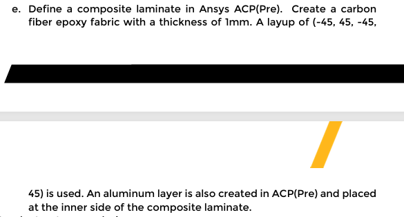

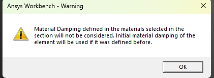

      Hi everyone, I am practising implementing the composite overwrapped pressure vessel example in the above listed course. My simulation model however does not seem to run and gives the following error:

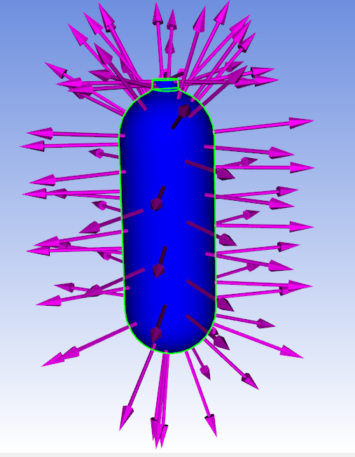

      I could imagine this is due to how I have implemented the ply layers, but am not 100% sure as I followed everything else identical. Once creating the fabrics and and activating the orientation I get the following:
      I applied 5 ply layers using the orientation described in the video file:
      1. Aluminium
      2. Carbon epoxy (-45)
      3.Carbon epoxy (45)
      4.Carbon epoxy (-45)
      5. Carbon epoxy (45)
      The order follows from my understanding that the first layer should be aluminium as per the task description (and because the orientation points outward) and then the respective carbon epoxy layers.

      This warning is triggered primarily for layered or multi-material elements (for example SOLID185 layered, layered shells, or similar composite formulations) when both of the following are true: (a) the section definition references multiple materials with damping defined at the section-material level, and (b) the underlying element formulation is coded to take its damping coefficients from the element material pointer MAT rather than from the section materials. In this case, MAPDL determines Rayleigh/material damping from MAT, so any damping you defined on the section materials is ignored and the “initial material damping of the element” is used instead.
