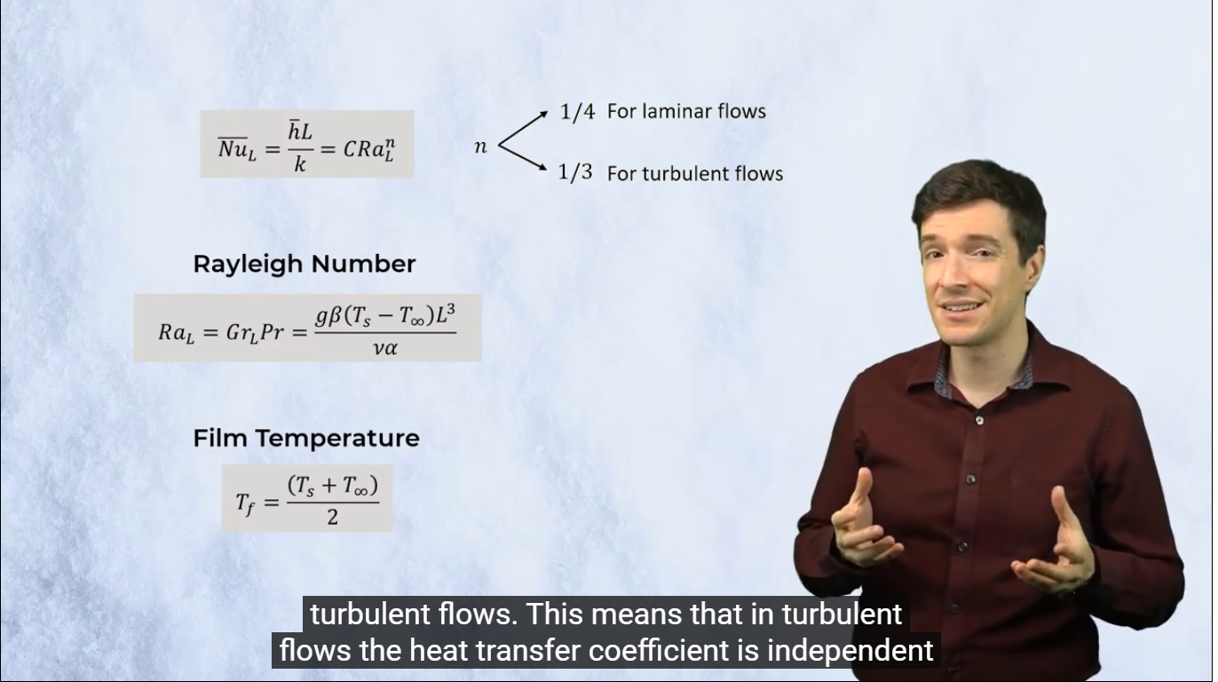

In the External natural convection video, Natural convection course the instructor is saying that "In turbulent flow, the HTC is independent to body characteristic length" (PFA)
June 14, 2021 at 2:08 pmKarthik Remella
AdministratorHello It is the Nusselt number which is linearly proportional, not HTC. To obtain HTC, you will need to use the definition of Nu number. The L in the Nusselt number definition and L on the RHS will cancel and you will observe that HTC is actually independent of the length scale.

June 14, 2021 at 3:57 pmAbubakar
SubscriberThank you, very much sir. Understood mathematically any physical reason why in turbulent flow HTC doesn't depend on characteristic length? TIA
