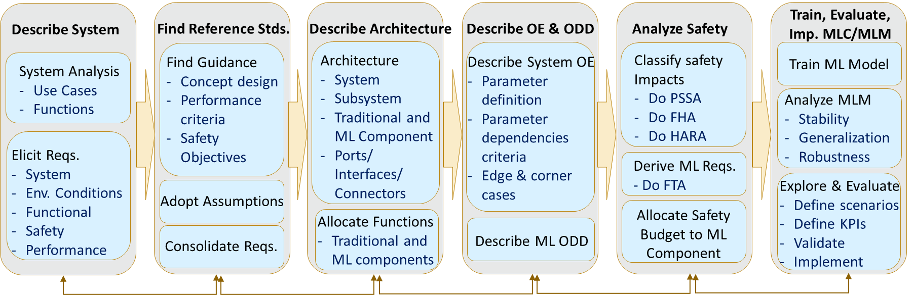

      As the pathway towards AI/ML certification moves forward, the know-how already applied and proved in different domains can be adapted and new techniques developed to provide support. In this perspective, well-known techniques, like for instance Model-Based Systems Engineering (MBSE), simulation and code generation, can play as building blocks to support methodologies applied to conduct the activities of the AI/ML safety lifecycle.
      Indeed, the lifecycle for AI/ML design and development is iterative, incremental and methodological support is required to follow it. Figure 1 shows the distinctive phases of a Digital Engineering MBSE (DEM) method proposed by Ansys (part of Synopsys). The phases of the method can be conducted and adapted according to the development cycle per domain (road vehicles, aerospace, maritime) thus having multi-domain approach.
      Figure 1. Method for design, development and validation of AI/ML-based systems
      The proposed method provides guidance to develop the following design products:
      • System description. Analysis of Uses Cases, System Functions, and their refinements, including AI/ML functions/components (e.g. ConOps). The analysis allows to structure requirements according to different categories: system, environment, functional, safety and performance.
      • Guidance for applicable standards and requirements. The know-how and recommended practices from existing guidelines and standards are summarized in templates which guide the design and validation of the AI/ML system and the elicitation of requirements to be fulfilled.
      • Architecture Description. Design of the overall System Architecture including classical SW/HW and the components integrating AI/ML-algorithms.
      • ODD Description. Description of the Operational Domain (OD) at System level, and the Operational Design Domain (ODD) at AI/ML Component level, including ranges of ODD parameters and the data probability distributions. This phase allows analysis of the OD and ODD dependencies as well as edge and corner cases (data input singularities).
      • Preliminary Safety Assessment. As a distinctive characteristic in mission-critical systems, the Preliminary Safety Assessment helps to determine safety budgets for the overall System and derive requirements to constrain error rates produced by AI/ML components. Techniques like PSSA, FHA, and FTA are leveraged for that purpose.
      • AI/ML Algorithm Characterization. The characterization is conducted in two phases. The first phase covers analysis of the standalone AI/ML algorithm, to validate sensitivity and robustness properties. The second phase relies upon scenario-based testing of the System integrating the AI/ML algorithm, by simulation of logical and concrete scenarios involving ground truth and environment participants as per the OD and ODD. The simulation evaluates safety and autonomy KPIs and other trustworthiness indicators to ensure requirements fulfilment.
      • Generation of Executable Code. Once the AI/ML algorithm has been characterized and fulfils its requirements, executable code can be generated from the AI/ML model via a transformation that preserves AI/ML model characteristics and complies with classical development standards.
