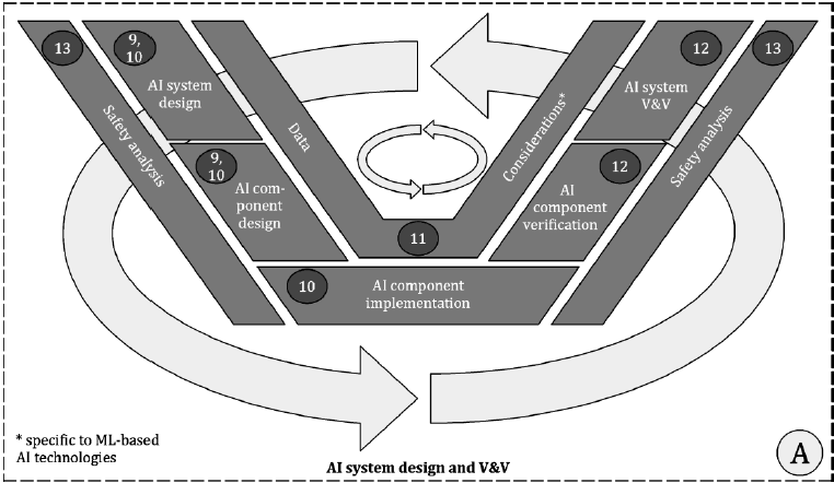

Key components of ISO/PAS 8800
Clause 6 – AI within the context of road vehicles system safety engineering and basic concepts. Along with scope and terminology, this clause positions ISO/PAS 8800 in regard to existing safety standards, namely ISO 26262 and ISO 21448. It also provides a first classification for AI/ML error categories.
Clause 7 – AI safety management. It defines the safety AI/ML lifecycle for design and development, starting at encompassing system level. The clause incorporates an iterative V-cycle covering design, development, validation and verification of the AI/ML system and component(s), including data-related considerations. The AI/ML lifecycle covers integration of AI/ML algorithms into the encompassing system and operation in real context, as shown in the figure below (borrowed from ISO/PAS 8800).
Clause 8 – Assurance arguments for AI systems. A distinctive trait of ISO/PAS 8800 is that the AI/ML lifecycle begins with assurance argumentation. This phase shall identify all AI/ML specifics, considering the context of usage, categories of evidence, and roots of truth to anchor evidence. The assurance argumentation supports the structure for demonstration of safety (i.e., the safety case). It also provides a foundation for requirements to be elicited and to ensure quality attributes such as correctness, sufficiency, and consistency.
Clause 9 – Derivation of AI safety requirements. Derivation of AI/ML requirements can follow a combined top-down, bottom-up approach. Regarding top-down, existing safety techniques, for instance HARA, FMEA, and FTA, can be tailored from encompassing system level towards AI/ML component level to derive requirements incorporating system level considerations (e.g., relying upon FuSa and SOTIF analyses). As for bottom-up, AI/ML related properties, namely generalization, robustness, explainability, etc. are considered to determine their applicability during requirements derivation. Derivation of thresholds in AI/ML requirements specification is of utmost importance.
Clause 10 – Selection of AI technologies, architectural and development measures. It provides recommendations for selection of AI/ML technologies, considering the features of each AI/ML category and which properties they contribute to support. It also recommends deployment of measures to increase confidence in the usage of AI/ML technology according to known errors or limitations.
Clause 11 – Data-related considerations. This clause contains a specific lifecycle dedicated to dataset development. The dataset lifecycle covers different phases: from safety analysis, requirements, design, implementation, verification, validation, up to maintenance. A comprehensive list of data-related properties is provided to be considered during requirement derivation, e.g., representativeness, fidelity, completeness, traceability, etc.
Clause 12 – Verification and validation of the AI system. It includes reference processes to conduct verification and validation of the AI/ML system and components. A variety of testing methods is suggested to conduct validation including, but not limited to, synthetic test case generation, expert knowledge, robustness testing, etc. Recommendations are also provided regarding AI/ML integration and verification, including applicable techniques, like probabilistic testing, scenario-based testing and usage of synthetic data environments.
Clause 13 – Safety analysis of AI system. This clause focuses on techniques that can be applied or adapted to analyze safety of the AI/ML system. The techniques in scope comprise, but are not limited to, FTA, FMEA, STPA, ETA, HAZOP, Bayesian networks, etc.
Clause 14 – Measures during operation. Measures during operation need to be identified to achieve continual, periodic re-evaluation of the assurance arguments (safety case). This activity shall assess remaining uncertainties in the implementation, unveil unexpected operation behavior, and facilitate early identification of evolutions in the Operational Design Domain (e.g., data drifts). This phase of the AI/ML lifecycle may include periodically collecting data and information from the AI/ML system operation (e.g., via monitoring), and analyzing collected data (e.g., incident analysis). Technical safety measures are elicited accordingly to comply with safety argumentation (e.g., retraining the AI/ML algorithm).
Clause 15 – Confidence in use of AI development frameworks and software tools used for AI model development. This clause introduces processes to increase confidence in tools used in the AI/ML lifecycle including both traditional software tools and AI-based tools, with a focus on data-related processes. This clause shall still be consolidated by upcoming standards, e.g., ISO 22440.

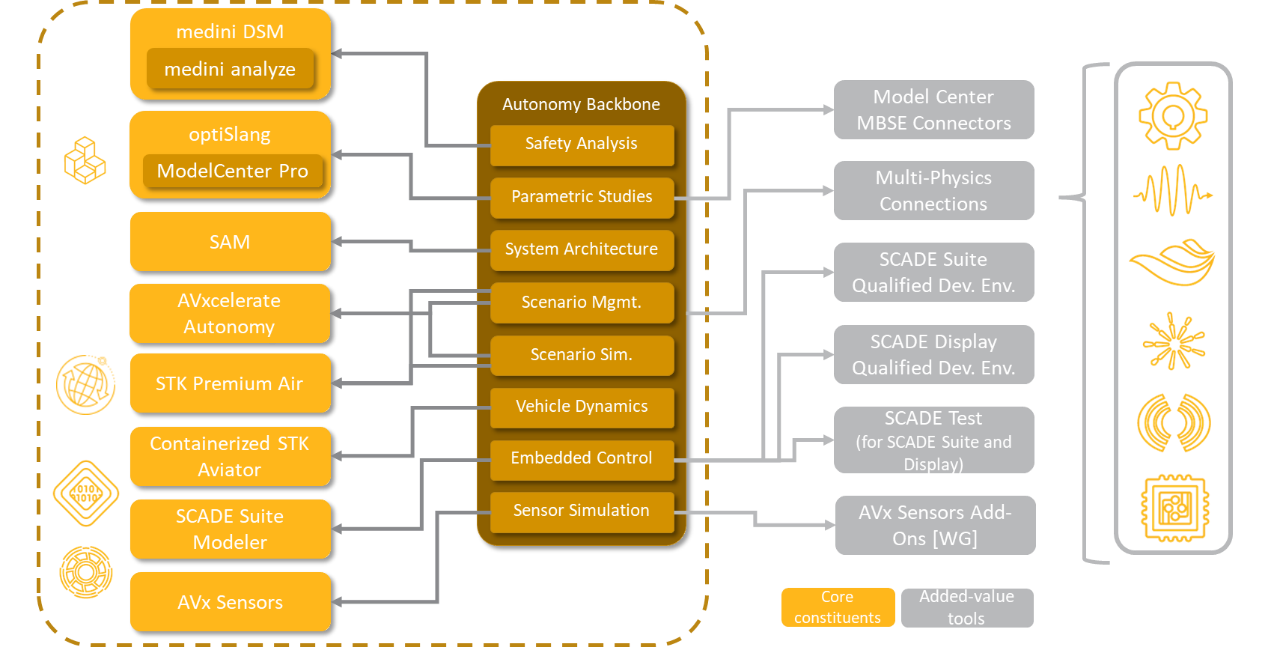

Ansys Suite Core Tools
The distinctive features of the Ansys suite are summarized inline:
- medini analyze: Systems, HW and SW modeler implementing analysis methods for safety (HAZOP, HARA, FHA, FTA, FMEA) and cyber-security (TOE, Attack Tree, TARA) according to standards.
- SAM: SysML v2 modeler for Systems Architecture, Use Case, Activity and Requirements engineering.
- SCADE: Environment for reliable and safe embedded SW modeling, verification, and code generation, compliant with aeronautics, automotive, railway, nuclear and general industries safety standards.
- DSM: The Digital Safety Manager drives optimization of the safety-process acting as a central hub to gather data, managing resources, planning, etc. for systems, HW and SW development projects.
- AVx Sensors: Simulation engine including a catalogue for sensors-perception simulation and capabilities to evaluate Autonomous systems.
- optiSlang: Environment for parametric designs studies, process integration & automation. Provides AI/ML and non-AI/ML based algorithms for e.g. Sensitivity study, Optimization or Robust Design and connects those to tool chains of engineering tools.
- AVxcelerate Autonomy: Cloud-based simulator, including compositional workflow and interfaces with optiSlang and AVx Sensors, able to evaluate autonomous Systems/SW performance and safety-related indicators based upon Open-Scenario format.
