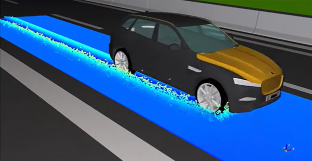

/SPH Freeze Outside Region

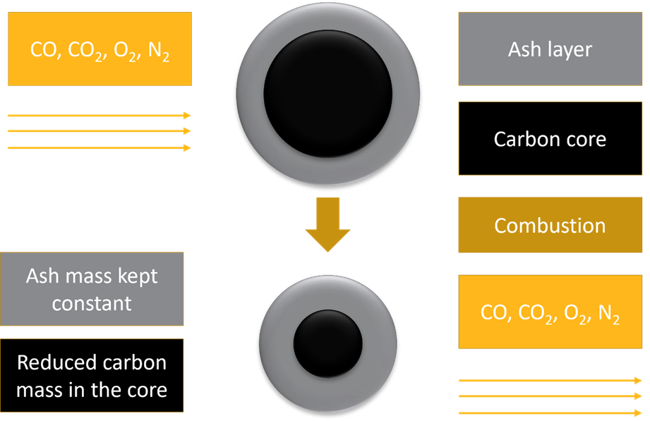

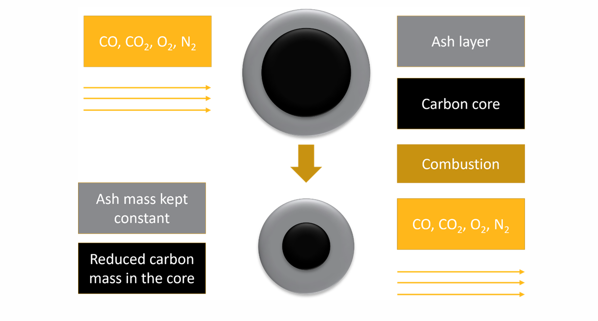

Reduces the computational cost of simulating projects by freezing and disabling from calculations the SPH elements that are outside a defined Region of Interest (ROI)./CFD Particle Combustion Module
The CFD-Coupled Particle Combustion module enables you to consider the reaction of coal particles during combustion, with two parallel reactions,
and
To understand more about the CFD Particle Combustion Module watch the:

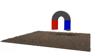

/Electromagnetic Coupling Module
The Electromagnetic Coupling module enables you to add electromagnetic physics to the simulation, such as:
- Electrostatic forces for particle-particle and particle-boundary interaction;
- Charging and discharging effects on particles due to contact with boundary surfaces;
- Field forces on charged or dipole particles immersed on electric/magnetic fields.

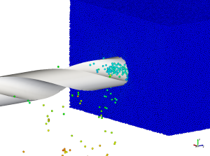

/Bond Model
This module is designed to simulate the behavior of agglomerate materials by using a model which bonds particles together using cylindrical, massless, spring-dashpot connections. These bonds can be broken at any time if the tensile or shear stresses exceed prescribed values. Also, the module creates bonds for particles recently unfrozen by the “Particle Freeze Outside Region” module.

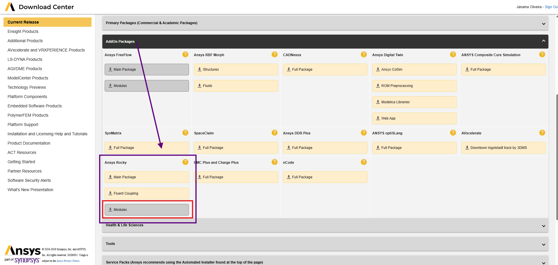

Each module has its own Documentation that explains its usability and provides technical details of its implementation.Download Package: To download the modules, scroll down to Add-ons Packages, and in Ansys Rocky click on SDK and Modules to download all modules available
Download Installation Guide: To learn about each available module and access installation instructions, download the Add-ons Packages, and in Ansys Rocky click on Installation Guide.
