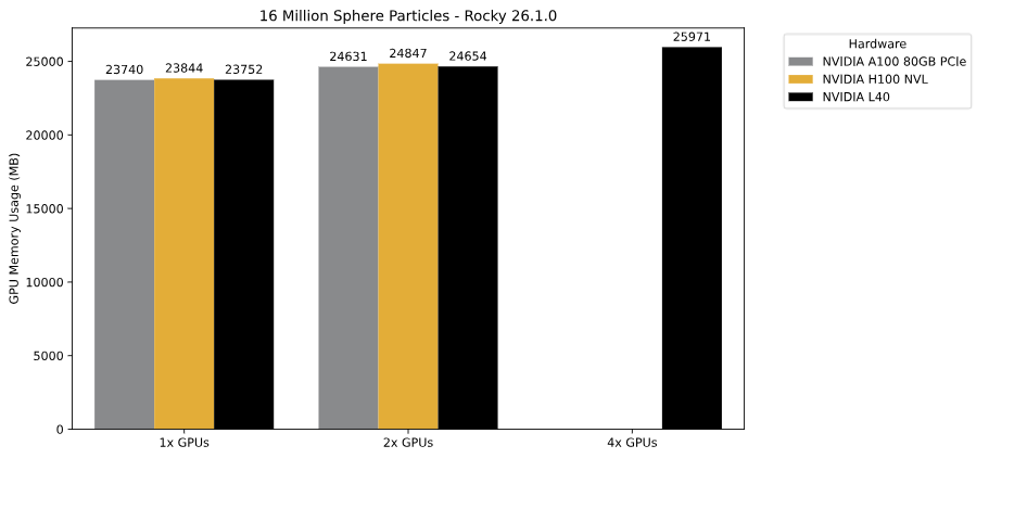

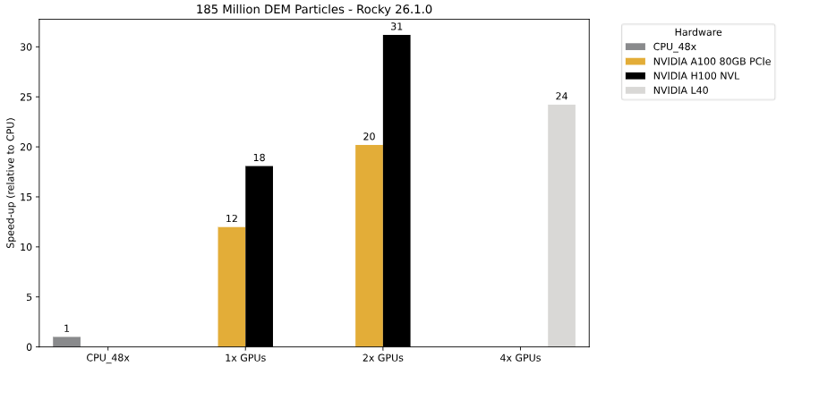

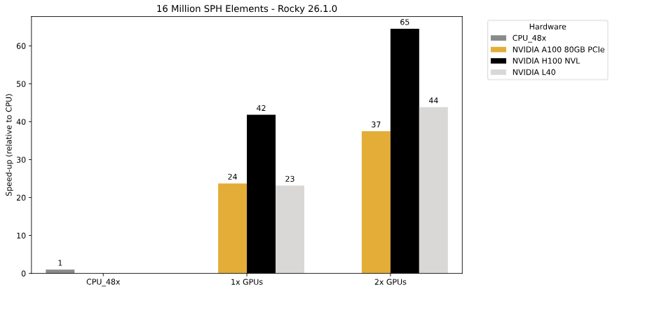

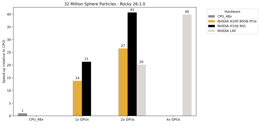

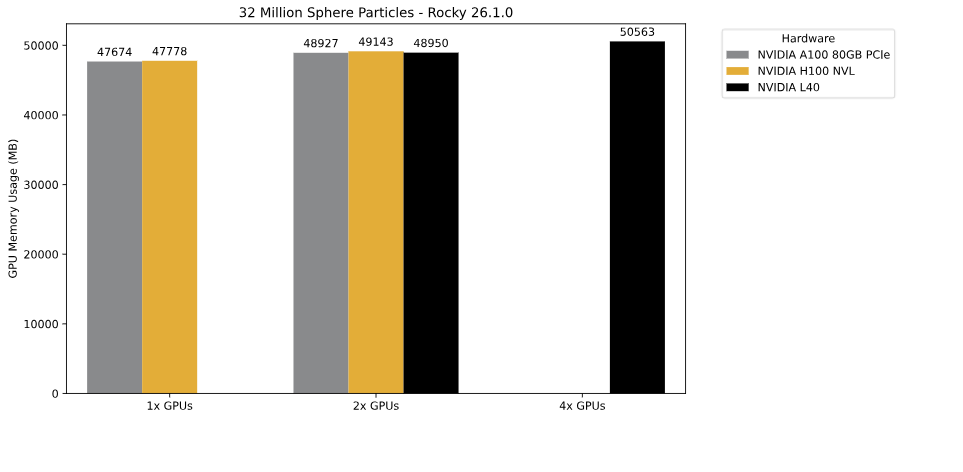

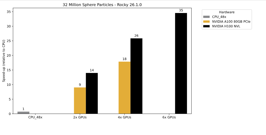

      Performance Benchmark
      To better illustrate the gains in processing speed that are possible for common applications, a performance benchmark of a rotating drum (Figure 1) was developed. Multiple runs using different criteria were evaluated as explained below.
      Figure 1 – Rotating drum benchmark case.
      Criteria 1: Particle shape
      Two different particle shapes were evaluated at the same equivalent size (Figure 2):
      • Spheres
      • Polyhedrons (shaped from 16 triangles)
      Drum geometry was lengthened as the number of particles increased to keep the material cross-section consistent across the various runs.
      Figure 2 – Sphere (left) and 16-triangle polyhedron (right) particle shapes used in the benchmark case.
      Criteria 2: Processing type
      Four different processing combinations were evaluated:
      • CPU: Intel(R) Xeon(R) Gold 6542Y @ 2.90 GHz on 48 cores
      • 1 GPU: NVIDIA H100, NVIDIA A100, NVIDIA L40
      • 2 GPUs: NVIDIA H100, NVIDIA A100, NVIDIA L40
      • 4 GPUs: NVIDIA L40
      Criteria 3: Performance measurement
      Two measurements were taken at steady state to evaluate performance:
      • Simulation Pace (speed up), which is the amount of hardware processing time (duration) required to advance the simulation one second. In general, a lower simulation pace indicates faster processing. The simulation speed up metric is used considering the CPU pace as reference.

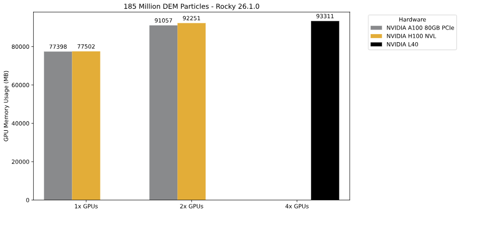

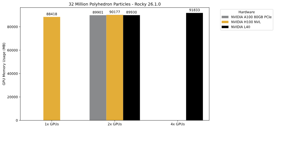

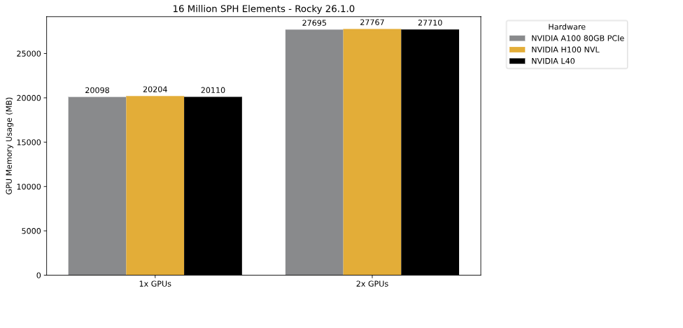

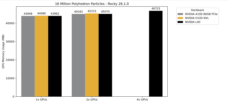

      • GPU Memory Usage, which is the amount of memory being used on the GPU while processing the simulation. In general, a lower memory usage allows for more particles to be processed, and/or more calculations to be performed.

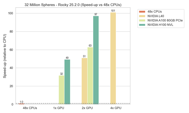

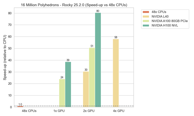

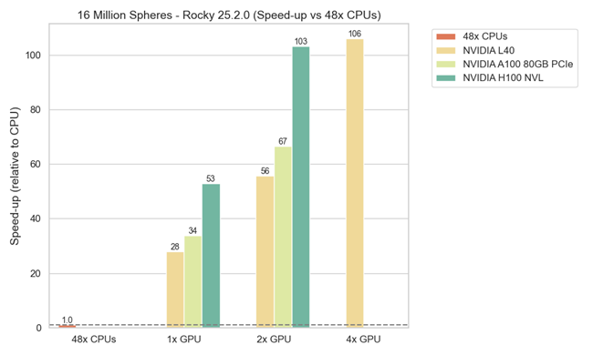

      Benchmark results for Ansys Rocky 2026 R1

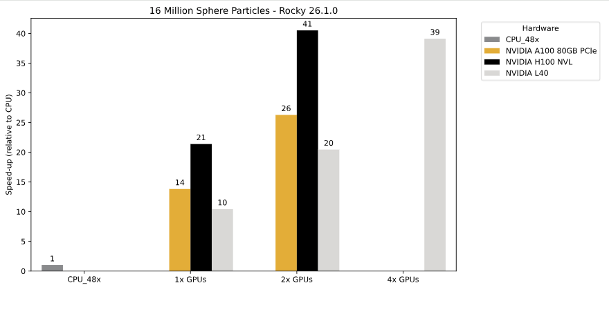

      GPUs Tested in Ansys Rocky 2026 R1

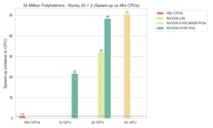

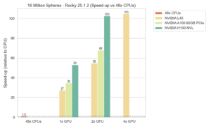

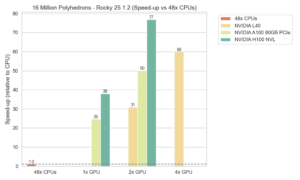

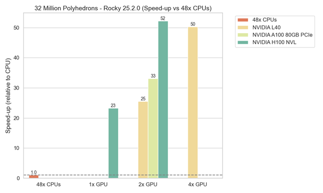

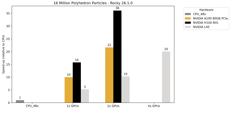

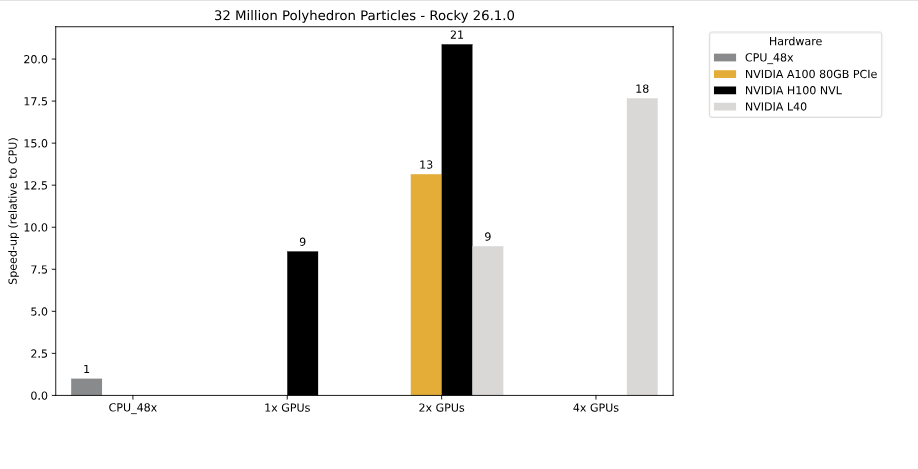

      Relevant conclusions on simulation performance
      The following plots, from Figure 3 to Figure 6, show the performance gains for spheres and polyhedrons for different numbers of particles, using different models and numbers of GPU.
      • Rocky’s latest CPU simulation enhancements significantly reduced execution times when running on standard processors. Compared to previous releases, the GPU speed-up is lower, but still significantly high.
      • The performance gain running in GPU or multi-GPU is significant. You can achieve the same result in a multi-GPU simulation up to 41 times faster than 48-cores CPU. Using one GPU
      • Excellent scalability and efficiency were observed for all GPU cards tested.
      Figure 3 – GPU speed-up based upon Simulation Pace (compared with CPU 48x cores) achieved using 16 million spheres.
      Figure 4 – GPU speed up based upon Simulation Pace (compared with CPU 48x cores) achieved using 32 million spheres.
      Figure 5 – GPU speed up based upon Simulation Pace (compared with CPU 48x cores) achieved using 16 million polyhedrons.
      Figure 6 – GPU speed up based upon Simulation Pace (compared with CPU 48x cores) achieved using 32 million polyhedrons.

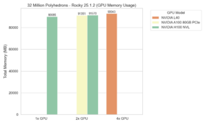

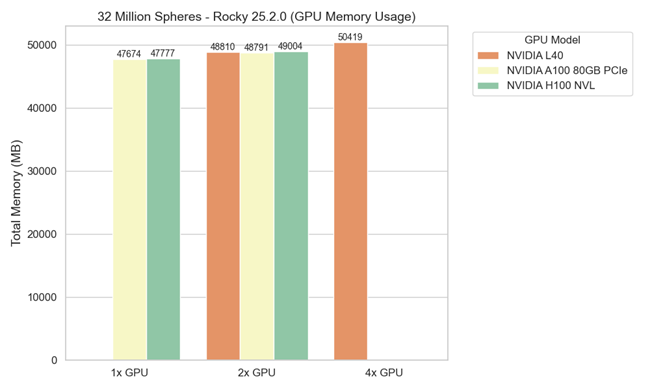

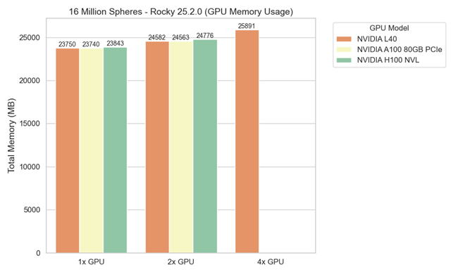

      Relevant conclusions on GPU memory consumption
      From Figure 7 to Figure 10 the GPUs memory usage is shown for spheres and polyhedrons for different numbers of particles using different models and numbers of GPUs.
      • For the case with 26 million sphere particles, simulations takes total memory consumption is, approximately between 23GB and 26GB. For 16 millions polyhedrons the range of GPU memory used is from 43GB to 46GB.
      • Considering the simulation with 32 million sphere particles the GPU memory usage is from 47GB to 50GB, approximately. For 32 million polyhedrons the total memory consumption is up to 90GB.
      • Ansys Rocky can simulate 32 million polyhedrons using 90GB of GPU memory, in other words this means that 90GB could be used to simulate about 185 million spheres particles.
      Figure 7 – Total GPU memory consumption using 16 million spheres.
      Figure 8 – Total GPU memory consumption using 32 million spheres.
      Figure 9 – Total GPU memory consumption using 16 million polyhedrons.
      Figure 10 –Total GPU memory consumption using 32 million polyhedrons.

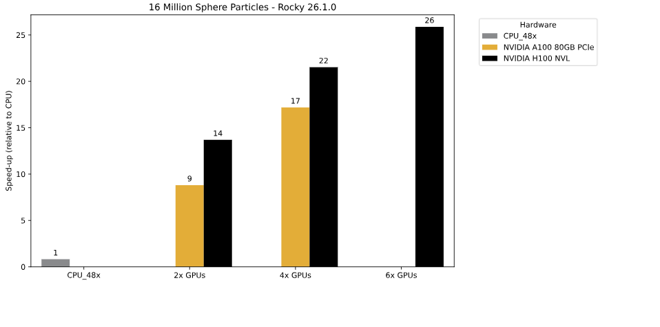

      Figure 11 and Figure 12 show the speed-up for 16 million and 32 million sphere particles. The results for 4x GPUs and for 6x GPUs are those runned in two and three nodes, respectively.
      • For the A100 card the scalability and the efficiency are great. For the H100, results are good, the performance can be improved by simulating a problem with more particles. Then, the solver will utilize more GPU memory and memory bandwidth. In other words, for a 16 million particle simulation, the memory bus in 4 H100, makes the CUDA cores waste too much time to exchange information.
      • The speed-up for 32 million sphere particles shows an improvement in H100 efficiency. As stated in the previous item, more particles more GPU memory and more memory bandwidth. As consequence, less memory bus when running simulations with 4 H100, less time to communicate between CUDA cores and efficiency improvement.
      Figure 11 – GPU speed-up based upon Simulation Pace (compared with CPU 48x cores) achieved using 16 million spheres.
      Figure 12 – GPU speed-up based upon Simulation Pace (compared with CPU 48x cores) achieved using 32 million spheres.

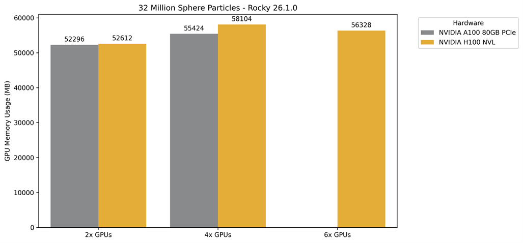

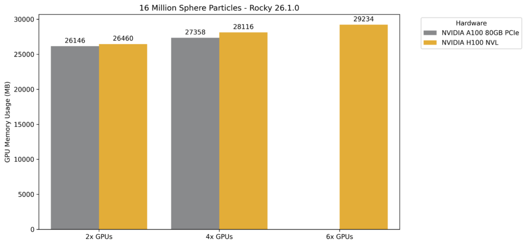

      Figure 13 and Figure 14 show the memory consumption for the cases with 16 and 32 million sphere particles.
      Figure 13 – Total GPU memory consumption using 16 million spheres.
      Figure 14 – Total GPU memory consumption using 32 million spheres.

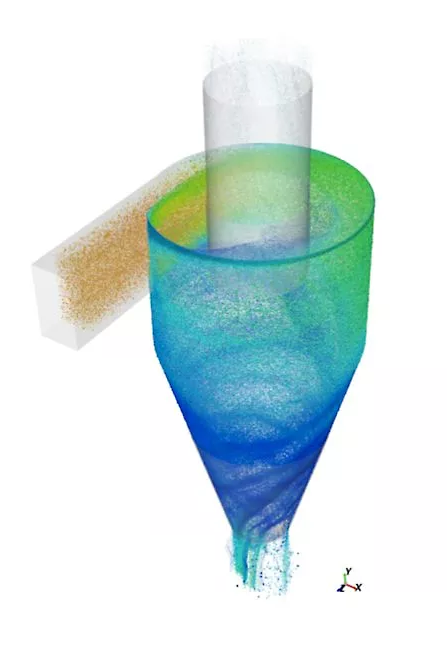

      To analyze the performance of the CFD-DEM coupling, a cyclone separator problem was developed, see Figure 15. As stated in the previous section, the coupling evaluated is a 1-way coupling. Here, the Ansys Rocky solver plays a more significant role in overall simulation performance.
      Similar to the DEM benchmark, multiple runs were evaluated to gather information to assess Ansys Rocky.
      Figure 15 – Cyclone benchmark case.
      Criteria 1: Particle details
      In the present problem the DEM phase is modeled by spheres particles. The discrete phase has about 185 millions of sphere particles. The size is a Particle Size Distribution as follow:
      Diameter (d) Cumulative (%)
      5.0 x 10-5m 100%
      4.1×10-5m 97.5%
      3.2×10-5m 91.75%
      2.3×10-5m 77.52%
      1.4×10-5m 44.48%
      5.0×10-6m 30%

      Figure 16 shows the speed-up for the cyclone separator simulation using different combinations of GPU models and numbers.
      • The results show a performance gain very interesting GPU performance. In a single GPU run it is possible to gain a speed-up about 18 times against a CPU run with 48 cores.
      • For multi-GPU the same result can be achieved 31 times faster than using 48 CPU cores.
      • The results show a great speed-up and good scalability and efficiency for a CFD-DEM simulation. Note: consider that this CFD-DEM simulation is processed with information from an external solver of Rocky (Ansys Fluent). Therefore, in this case data from Fluent needs to be passed to Rocky, which diminish the scalability and speed-up of Rocky.
      Figure 16 – GPU speed-up based upon Simulation Pace (compared with CPU 48x cores) for CFD-DEM simulation.

      In the cyclone separator analysis there is 185 million of sphere particles. Here, the sphere particles follows a PSD, as explained before. Figure 17 shows the GPU memory usage for the present case.
      • The case use data from Fluent to coup with Rocky. However, the memory usage shown here concerns mostly to Rocky.
      • As you can see the memory usage for multi-GPU (around 92 GB) is 17% higher than single GPU (around 77GB).
      Figure 17 – Total GPU memory consumption for the CFD-DEM case.

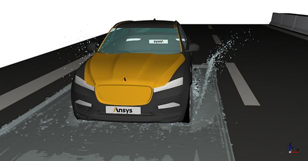

      Criteria 1: SPH elements
      To assess the performance of a Rocky SPH simulation we use a vehicle driving through a water puddle (car wading). The fluid is model using 16 millions of SPH elements and all geometries have about a total of 32 million triangles.
      Figure 18 – SPH car wading simulation.
      Figure 19 shows the performance speed-up for the IISPH solver in Ansys Rocky.
      • The results show a huge performance gain of running a SPH simulation in a GPU. In the worst-case scenario, compared to a run in 48 CPU cores, you can reduce your simulation pace with one GPU in 23 times, approximately.
      • The multi-GPU results also highlight the benefits of running SPH in a GPU, with two GPUs you can achieve a time reduction about 65 times compared with a 48 CPU cores.
      Figure 19 – GPU speed-up based upon Simulation Pace (compared with CPU 48x cores) achieved for the SPH simulation.

      Figure 20 shows the GPU memory usage for the SPH simulation within Ansys Rocky.
      • A SPH simulation with 16 million SPH elements can be performed in just one GPU. Theoretically, it will be possible to run a case around 35 million SPH elements in 80 GB card, such as NVIDIA H100 NVL and NVIDIA A100 80GB PCIe.
      • The maximum GPU memory consumption is about 27 GB in two GPUs. This result indicates that the SPH solver inside Rocky can be employed to analyze many complex problems.
      Figure 20 – Total GPU memory consumption for the SPH simulation.
