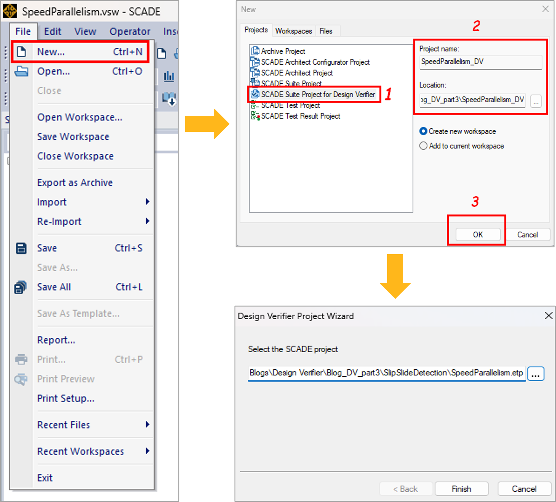

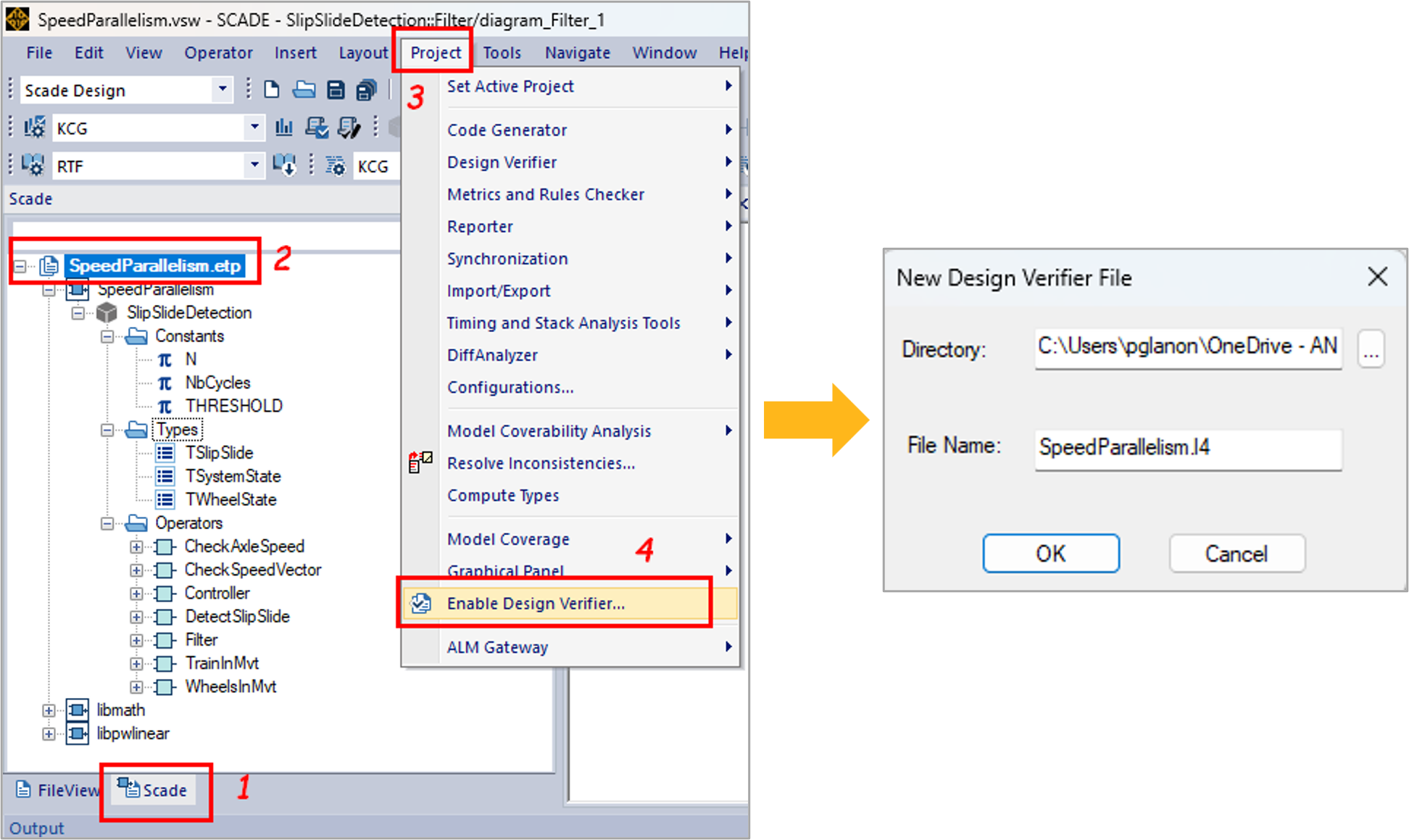

To enable SCADE DV, you can either create a verification project, which uses the design project SpeedParallelism as a library or you can directly enable SCADE DV in the design project and create a package for the verification modules.
If you choose to create a verification project, then you should follow the steps illustrated by Figure 3:
- Go to the File Tab and click New (or Press Ctrl+N).
- From the New Panel, go to the project Tab and select SCADE Suite project for Design Verifier.
- Fill in the name and the location path of your project and click OK. Note that during the creation of your project, you can choose to link the project to an existing workspace or automatically generate a new one.
- Select your design project and insert it as a library in the newly created project.
In case you prefer to enable SCADE DV in your design project instead of creating a verification project, then you should follow the steps illustrated in Figure 4:
- In the FileView or ScadeView Panel, select the active Scade project.
- From the Project tab, click “Enable Design Verifier”
- In the popup window, click OK and verify that filename.I4 is created.
Note: When you enable SCADE DV on your design project, you need to insert manually the built-in library “libverif” which consists of utility blocks for specifying verification properties. Moreover, once SCADE DV is enabled, you will get the Design Verifier view, where you can specify proof objectives and verification strategies. In the fourth step of the verification workflow, we will see how one can specify user proof objectives and verification strategies.
Figure 3: Creating a SCADE Suite project for Design Verifier

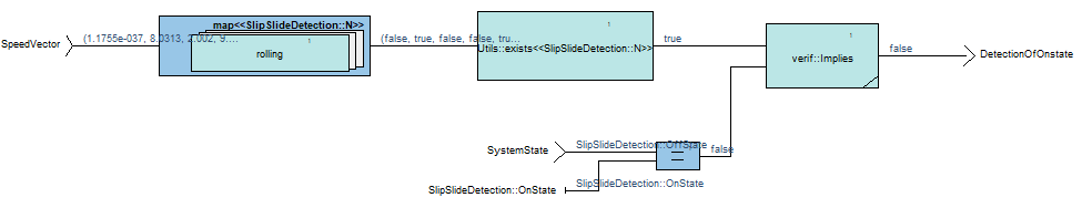

Now that the verification properties have been defined, they can be specified in SCADE. For example, let us consider the subsequent property of the functional requirement #Req1 as specified in Table 2:
Property “On Detection”: If there is an axle whose speed is greater than the minimum speed threshold then the controller is On.
This property describes a logical proposition A => B where:
- A is the part of the proposition which loops over the axle speed vector and checks if an axle speed is greater than the minimum speed threshold.
- B is the part of the proposition which checks that the slip slide detection system is enabled.
Figure 5 illustrates the Scade description of the property “On Detection”. The blocks surrounded in yellow and red respectively describe A and B and the logical implication “=>” is described by the built-in block “implies” of the SCADE DV library “libverif”.
Figure 5: Specification of property “On Detection” in SCADEAll the properties for our application example can be defined using the same modeling principles and the built-in blocks available in the SCADE DV library. Figures 6, 7 and 8 respectively depict the Scade description of the properties “Slip Detection“, “Slide Detection” and “Parallel Speed“.

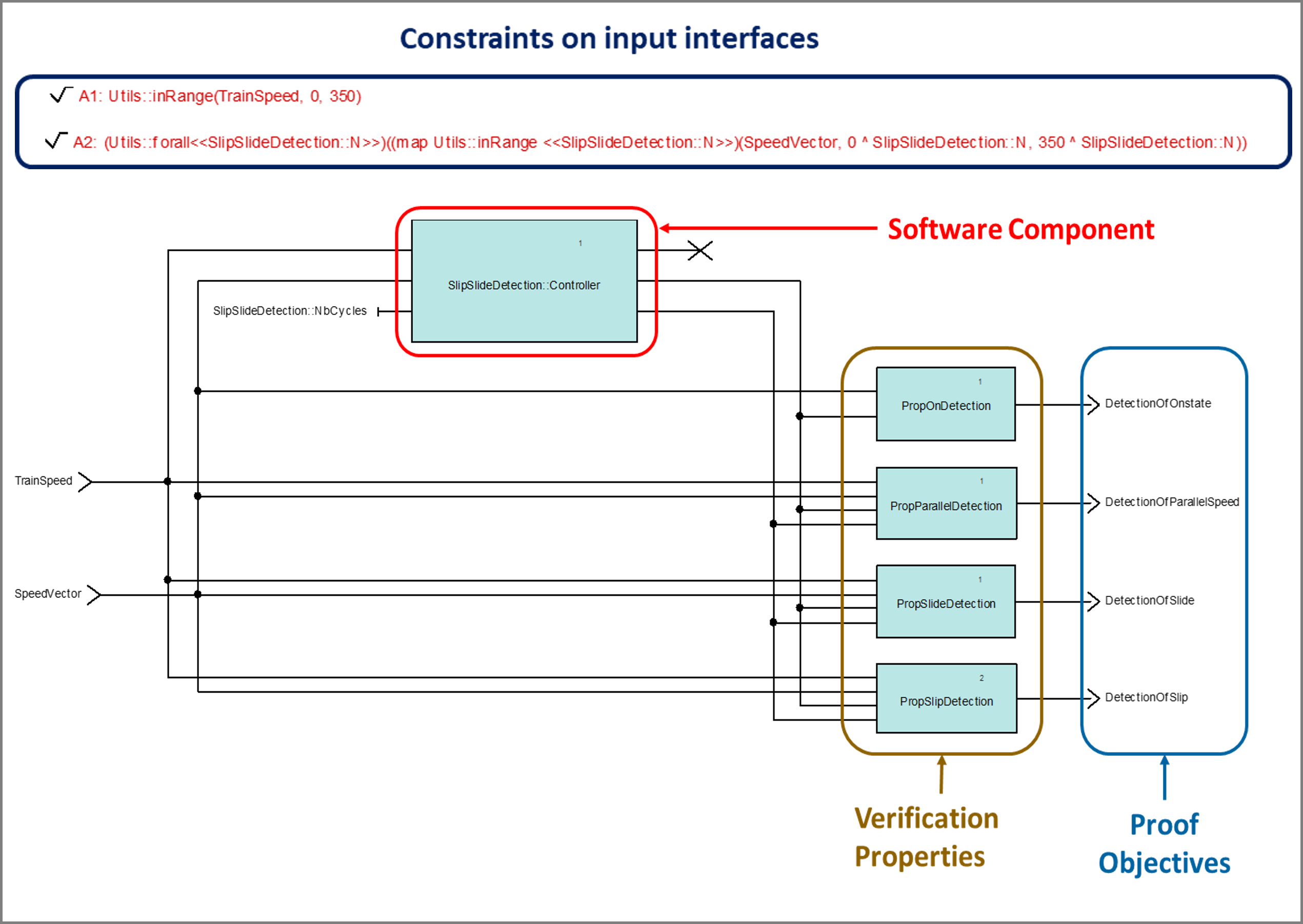

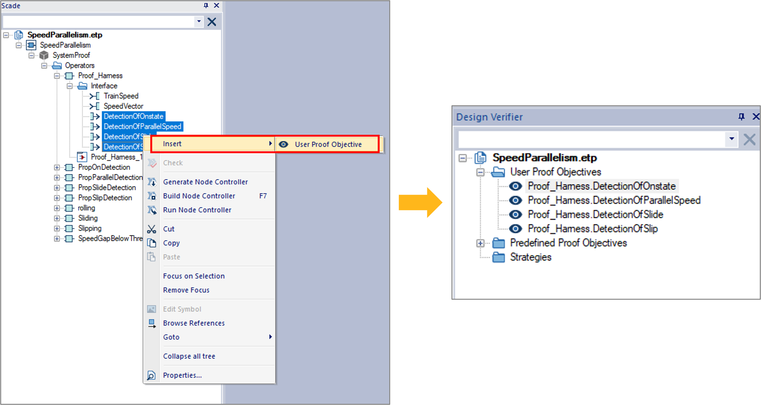

Step 4: Specify user proof objectives
Once the verification properties are specified, you need to define proof objectives. Proof objectives can be defined in a proof harness. A proof harness is a SCADE operator used as wrapper to combine the software component under verification and the properties that shall be satisfied. Figure 9 illustrates the proof harness for our application example where the four verification properties take as input the interfaces of the slip-slide detection software component. The outputs of the properties are proof objectives which are passed to the model checker as Boolean constraints. Considering these proof objectives, the model checker will try to prove that properties are always true.
Note that in a proof harness, you can also constrain the definition domain of your software’s input interfaces to avoid considering values that are known to be unreachable in your software design. This will add an execution context to your verification and will reduce the exploration space of SCADE DV’s model checkers.
In our application example, we constrained the definition domain of the train speed, and the axle speeds to fit within the [0; 350] range.
Figure 9: Proof harness for slip-slide detection softwareNow that the proof objectives have been defined, you can pass them to the model checker as shown in figure 10. For this purpose, you need to select the proof objectives from the SCADE design view and insert them as user proof objectives. Once they have been inserted, you can explore the Design verifier view to check the new proof objectives.

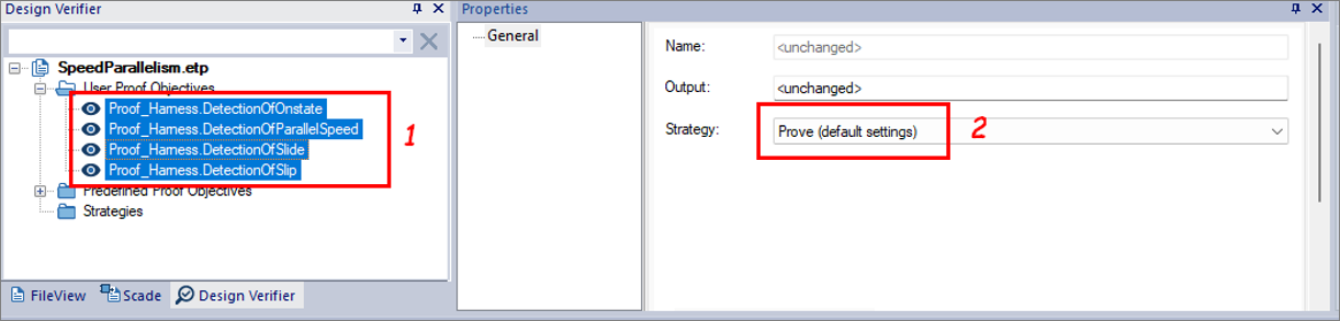

To analyze a proof objective (PO), you must associate it with a verification strategy. In SCADE DV, you can either select a set of default and configurable strategies, or you can specify a custom strategy based on Prover PSL Strategy definition syntax. A deep look into these strategies will be had in future posts. In this example, let us associate our POs with the default proof strategy as shown in Figure 11. This strategy tries to prove the validity of a property until it either succeeds or find a counter-example.
Figure 11: Applying a Strategy to a POStep 6: Launch the analysis

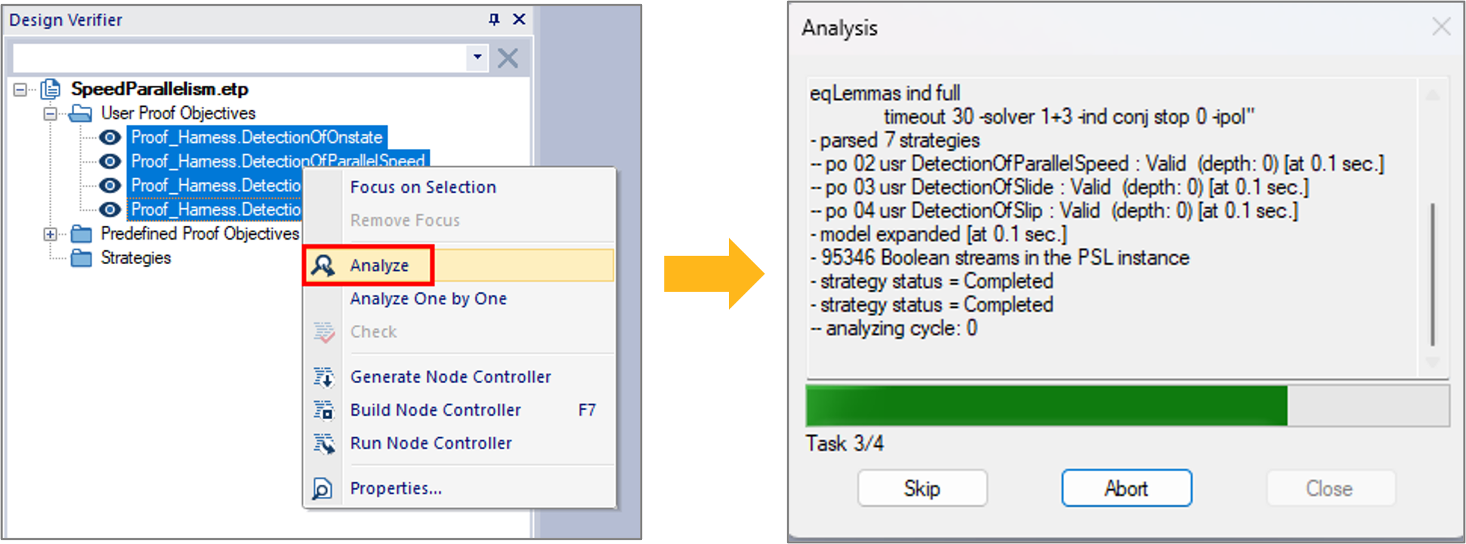

To run model checking, right-click on the inserted POs, then click Analyze as shown in figure 12. Once you launch the analysis, a window pops up with a progress bar that shows the status of the verification tasks. From this window you can click “Abort” to interrupt the analysis if there is any issue. Otherwise, when the analysis is completed, a Done message appears under the progress bar, and you can close the analysis window.

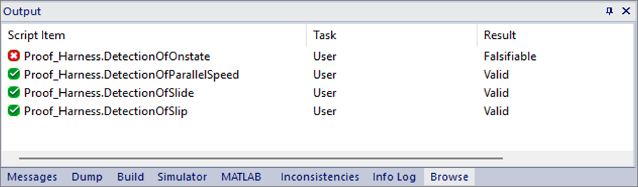

Figure 12: Launch the verification analysisStep 7: Review the results
Once the analysis is completed, results are displayed in the output browser as shown in Figure 13 where the keyword “valid” means that the verified property is always true and the keyword “falsifiable” means that the verified property can be false. In our example, the PO that verifies the activation of the slip-slide detection system is falsifiable, which means that the system might not switch to on while the train starts moving. A detailed report is also generated, which provides details on the verified PO and the verification strategy used for the analysis. Figure 14 illustrates the generated report for our application example. For falsifiable POs, the checker generates one or multiple counterexamples, that lead to the scenarios in which the verification is false.
Figure 13: Using assertions in your component

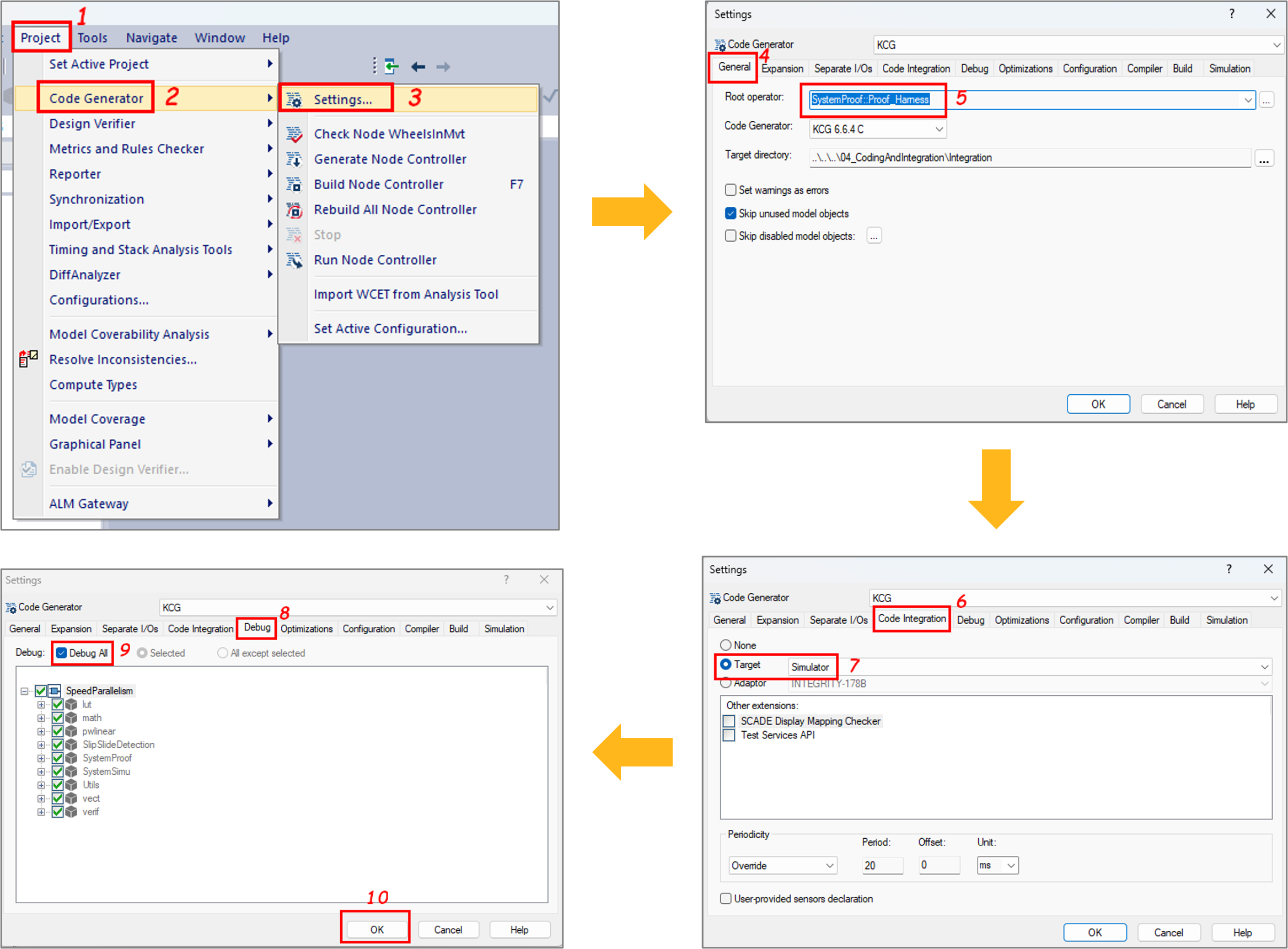

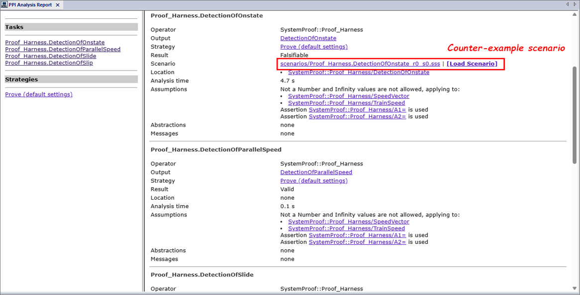

Figure 14: Generated analysis report for our application exampleFor our application example, a single counterexample is generated for the falsifiable PO. You can use the “Load Scenario” link, in Figure 14, to pinpoint the error in simulation and fix the design accordingly. But before loading the counterexamples, you first need to configure the SCADE Simulator. Figure 15 shows the configuration steps for the simulator:
- Open the configuration settings following steps 1-3.
- Select the root operator (proof harness) following steps 4 and 5.
- Select the SCADE Simulator as execution target following steps 6 and 7.
- Enable the SCADE Debugger and validate the changes following steps 8-10.
Figure 15: Configuration of the SCADE SimulatorNow that the SCADE Simulator is configured, you can simulate the falsifiable PO by loading the counterexample. As soon as you load a scenario, the SCADE simulator is launched, and you can play steps to identify the computation paths that lead to the falsification. Figure 16 shows the results of the scenario that led to a falsifiable PO for the property “On Detection“. This result clearly shows that the logical relation A=>B is falsified as there is at least an axle speed whose value is greater than the minimum speed threshold and the detection system is not activated. It means that we need to review the specification of the function that detects the train movement.
Figure 16: Simulation result with the counter-example scenario for the falsifiable PO “On detection“Figure 17 depicts the specification of the function that detects train movement. The function takes as input a vector that references the axle speeds, and it returns the system state. Considering its implementation, one can notice that the function integrates an iterator which loops over the speed vector, and it returns
trueonly if all the wheel axles have their speed greater than the minimum threshold. With regards to the property “On detection“, this implementation is incorrect as we consider a train as in movement when a least one of its axles has a speed greater than the minimum speed threshold. To fix this design error, one can replace the “AND” logic gate with an “OR” logic gate.

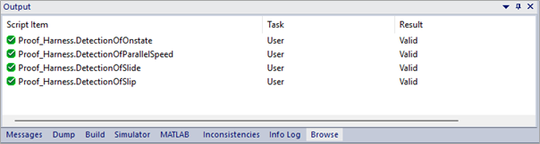

Figure 17: Function for the train movement detectionOnce the design error is fixed, you can run the verification again and will notice that all the properties of our slip-slide detection software are valid as shown in figure 18.
Figure 18: Final results for the train movement detectionReviewing the whole verification steps
