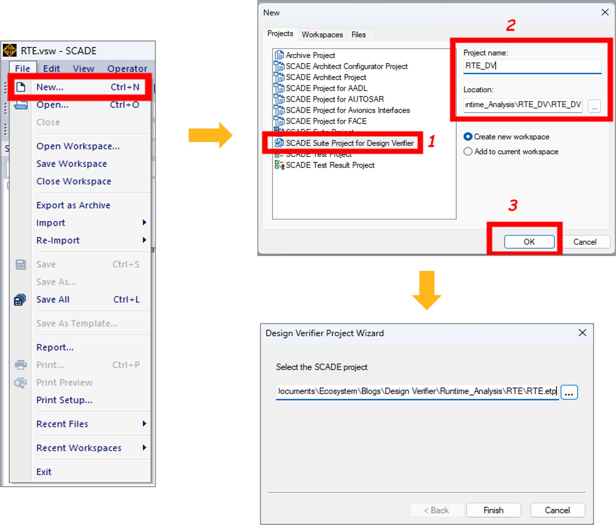

If you choose to create a verification project, then you should follow the steps illustrated by Figure 3:
- Go to the File tab and click New (or press Ctrl+N).
- From the New panel, go to the Projects tab and select SCADE Suite project for Design Verifier.
- Fill in the name and the location path of your project and click OK. Note that during the creation of your project, you can choose to link the project to an existing workspace or automatically generate a new one.
- In the newly created project, select your design project and insert it as a library.
To summarize, we created the verification project RTE_DV.etp to verify the absence of runtime errors in operator
RTE_operator, defined in library RTE.etp.
Figure 3. Creating a SCADE Suite project for Design VerifierOnce you create a verification project, SCADE DV is enabled, and you get the different views shown by Figure 4:

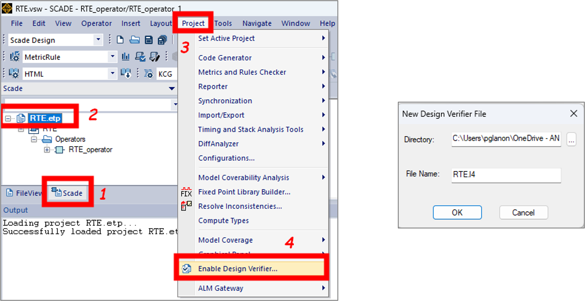

Figure 4. Different views after the activation of SCADE Design VerifierIn case you choose to enable SCADE DV directly in your design project, you should follow the steps illustrated in Figure 5:
- In the FileView or Scade view panel, select the active SCADE project.
- From the Project menu, click Enable Design Verifier.
- In the popup window, click OK and verify that
filename.I4is created.
Figure 5. Enabling SCADE DV in your design projectNote: When you enable SCADE DV in your design project, the built-in library libverif is not added automatically to your project. You need to insert it manually from your SCADE installation folder.

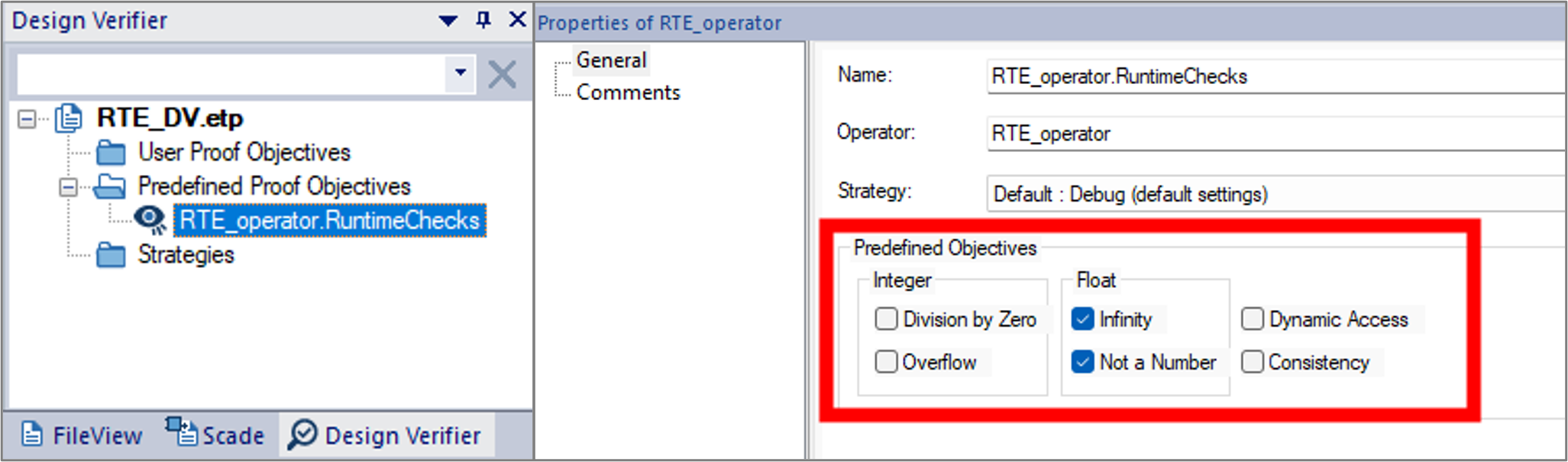

Once SCADE DV is enabled, you can now specify the predefined proof objectives (PO), i.e. the runtime errors that will be verified by the model checker. A predefined PO can directly be inserted from the library of components under verification, or you can create a proof harness — i.e, a Scade operator defined in your verification project which references the library’s components under verification — and insert a predefined PO from the proof harness. The creation of a proof harness can be beneficial when you need to constrain the model interfaces in the verification stage without changing your design.
In our case, we will insert a predefined PO that checks the absence of float infinities and Not-a-Number on

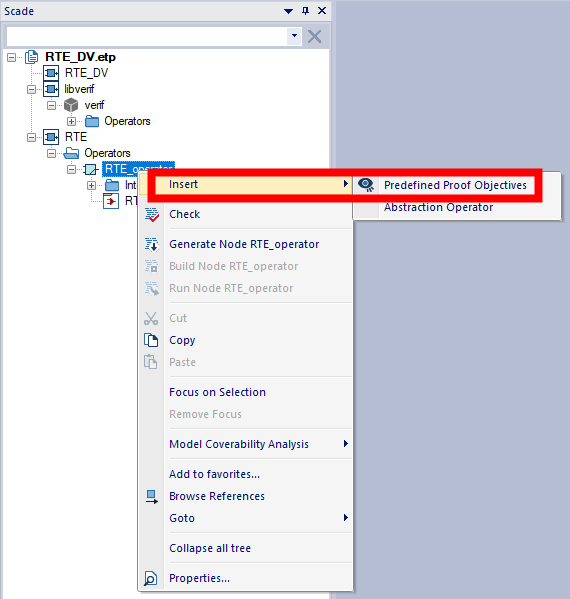

RTE_operator, our library component under verification. For this purpose, let us follow the steps below:- From the Scade view, go to the
RTElibrary, right-clickRTE_operatorand insert a predefined PO as described by Figure 6. Explore the Design Verifier view to check the new predefined PO.

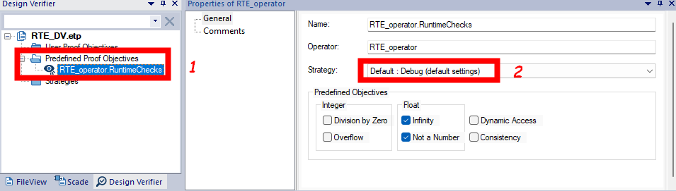

Figure 6. Inserting a predefined PO into your design project- From the Design Verifier view, rename the inserted predefined PO. From its Properties view, select float Infinity and Not a Number as shown in Figure 7.
Figure 7. Selecting predefined POsStep 3: specify the verification strategies

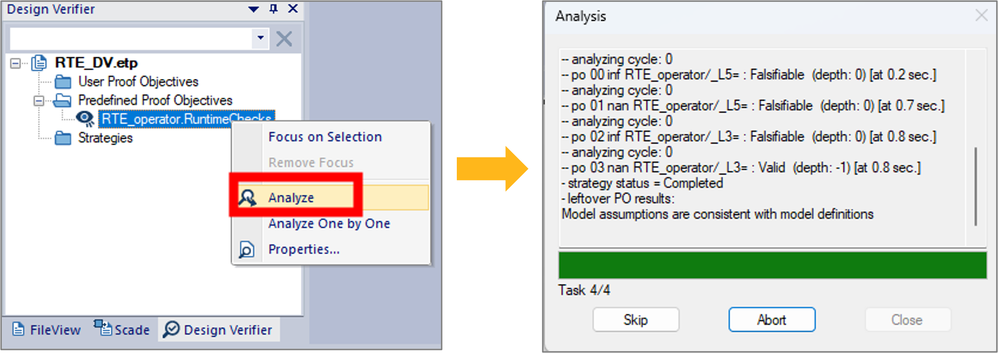

To run a formal analysis, right-click the predefined PO and click Analyze as shown in Figure 9.
Once you launch the analysis, a window pops up with a progress bar that shows the status of the verification tasks. From this window you may click Abort to interrupt the analysis at any time. When the analysis is completed, a Done message appears under the progress bar and you can close the analysis window.

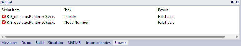

Figure 9. Launching the verification analysisStep 5: review the results

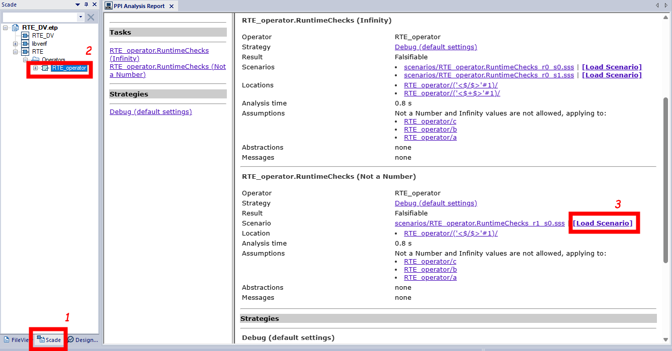

Once the analysis is completed, results are displayed in the output browser as shown by Figure 10 where the Falsifiable keyword means that the verified PO can be false. In our example, this indicates that some floating-point operations in
RTE_operatorcan lead to infinity and NaN.

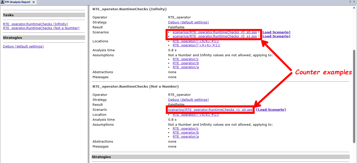

Figure 10: Viewing analysis resultsAn analysis report is also generated, which provides details on the tasks (i.e. the checks) performed by the model checker and their verification strategies. Figure 11 illustrates the report generated for our application example. For each falsifiable task, the checker generates one or multiple counter-examples, that lead to the scenarios in which the verification is false. These counter-examples can be loaded in the SCADE Simulator to pinpoint the error and fix the design accordingly.

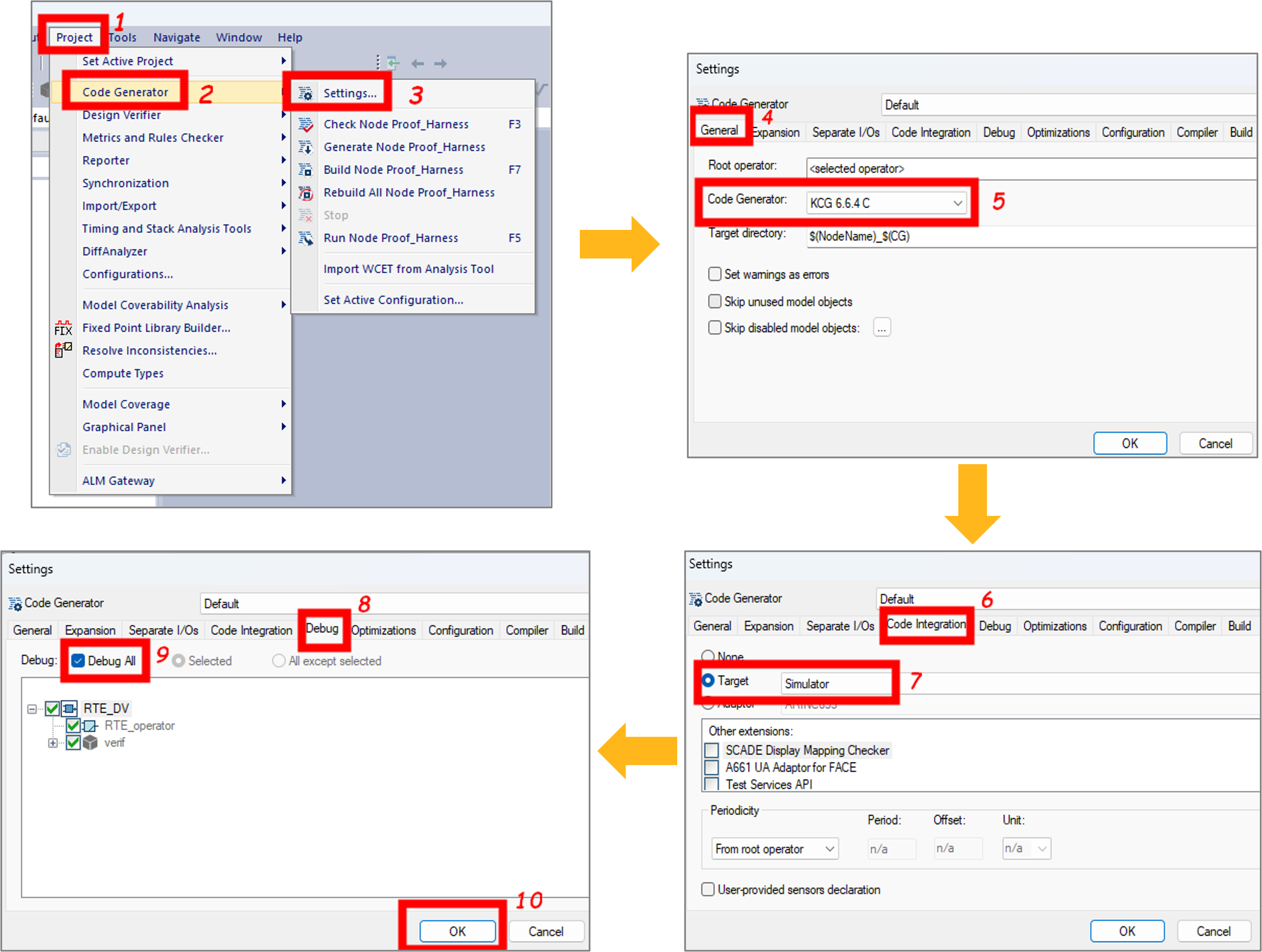

Figure 11: Generated analysis report for our application exampleBefore loading the counter-examples, you first need to configure the SCADE Simulator. Figure 12 shows the configuration steps for the simulator:
- Open the configuration settings (steps 1-3).
- Select the code generator (steps 4 & 5).
- Select the SCADE Simulator as an execution target (steps 6 & 7).
- Enable the SCADE Debugger and validate the changes (steps 8-10).
Figure 12: Configuring the simulator to run counter-examplesNow that the SCADE Simulator is configured, you can select the operator under verification and load the counter-example scenarios generated by SCADE DV. Figure 13 illustrates how to load the counter-example scenario that led to a NaN:
- From the Scade view, select the
RTE_operator(steps 1 & 2). - From the generated report, load the scenario (step 3).

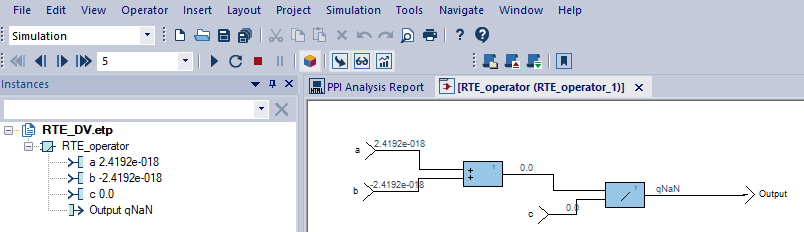

Figure 13: Loading a counter-example in SCADE Simulator for debuggingAs soon as you load a scenario, the SCADE simulator is launched, and you can run the simulation to identify the computation paths that lead to a runtime error. Figure 14 shows the results of the counter-example scenario that led to a NaN. As shown by the figure, there is a quiet NaN (qNaN) in the output’s computation path when $c = 0.0$ for any pair of values $(a, b)$ .

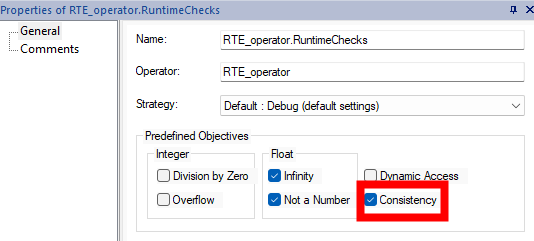

Figure 14: Counter-example debugging in the SCADE SimulatorAdding execution context to your verification using Scade assertions
To avoid considering values that are known to be unreachable in your software design, you can use
assumeassertions to constrain the definition domain of your software components’ input interfaces. This will add an execution context to your verification and will reduce the exploration space of SCADE DV’s model checkers.When designing a software component, you can either insert assume assertions directly into the component’s specification model, or if you need further validation before incorporating the assertions into the specification model, you can add a proof harness referencing the component and its assumptions. Figure 15 shows a proof harness defined in verification project RTE_DV.etp. This proof harness is a function operator that references
RTE_Operator, our component under verification with assumptions made on its input interfaces.When
assumeconstraints are expressed on the inputs of a software component, a consistency check must be made to verify that the constraints are not contradictory. For instance, if we consider an input $u$ , we cannot express a constraint that stipulates that $u$ is strictly greater than zero and at the same time less than zero. To ensure that constraints stated on input interfaces are consistent, SCADE DV provides a predefined PO that is highlighted in Figure 16. When this PO is checked, the model checker detects inconsistencies in the constraint statements, generating a counter-example if they are any. In future posts, we will cover this predefined PO in detail.
Figure 15: Using assertions in your component

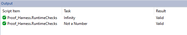

Figure 16: Enabling consistency checksConsidering the proof harness depicted in Figure 15, you can add a new predefined PO with the same objectives for runtime error detection (i.e. float infinity and NaN). If you run the verification with this newly defined PO, you will get valid results as depicted in Figure 17. This means that there are no float infinities and NaN as long as the inputs of the component under verification fit within their definition domains as specified by the assume assertions. This makes the interpretation of results more accurate and eliminates, from the model checker’s exploration space, values that are not significant for our application example.
Figure 17: Verification results with constrained inputsConclusion
