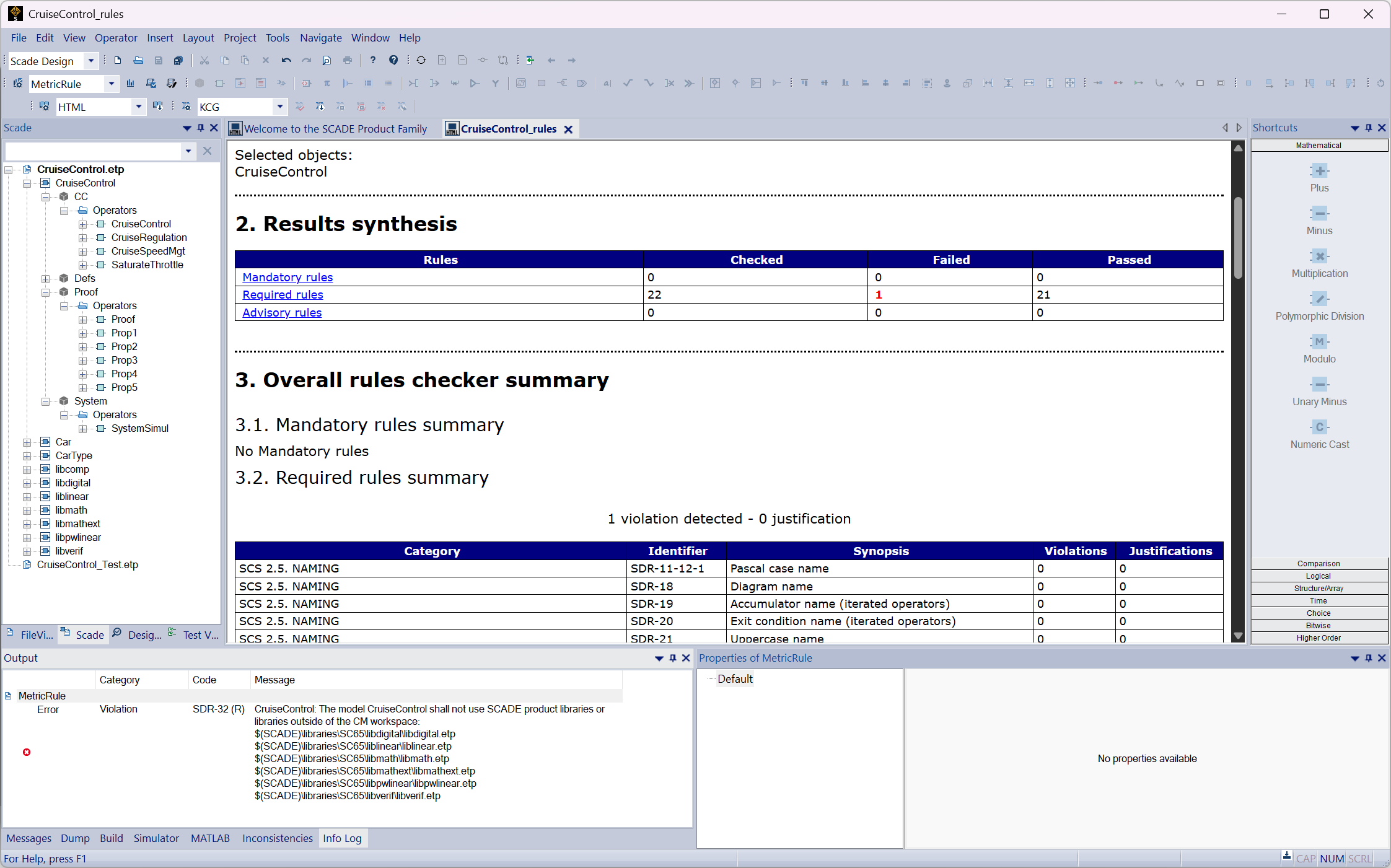

Checking rules produces a human-readable report. Mandatory rules must be observed; Required rules may be violated if a justification is provided; Advisory rules may be broken with no justification. This loosely matches an Error / Warning / Info levels on other linters. Rule severity can be customized by the user.
SCADE IDE overview after running a rule check. The central report and bottom left output window show that a required rule is violated.Rule catalog

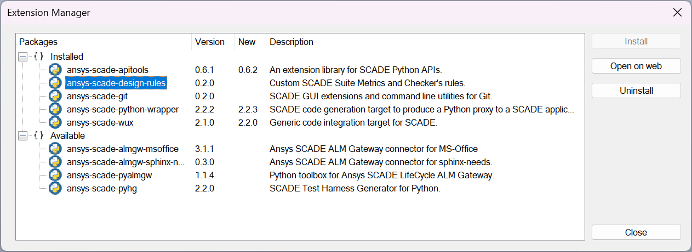

The first step to use SCADE Design Rules is to install the package. If you’re comfortable with Python, the Getting Started page contains instructions to install it, on the Python installation distributed with SCADE, using the
piputility.Alternatively, you may use the Tools > Manage Extensions… menu to install it through a graphical interface:
SCADE Suite extension manager withansys-scade-design-rulesinstalledNow that the package is installed, the catalog of rules is ready to be used.

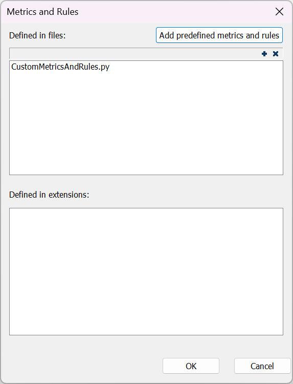

Now that you have assembled a Python script that lists and configures rules pertaining to your organization, you must register this script with your SCADE Suite model.
To do so, open your SCADE Suite model and go to Project > Metrics and Rules Checker > Manage Metrics and Rules… In the pop-up window, use the “x” button to remove the default metrics and rules, then use the “+” button to add your custom script:
Custom Metrics & Rules registered with a SCADE Suite modelNote that the script can be anywhere on your local computer – the SCADE project will just save a path to the Python file. If you are maintaining your SCADE project under configuration management (which you should!), we recommend picking one of these approaches:

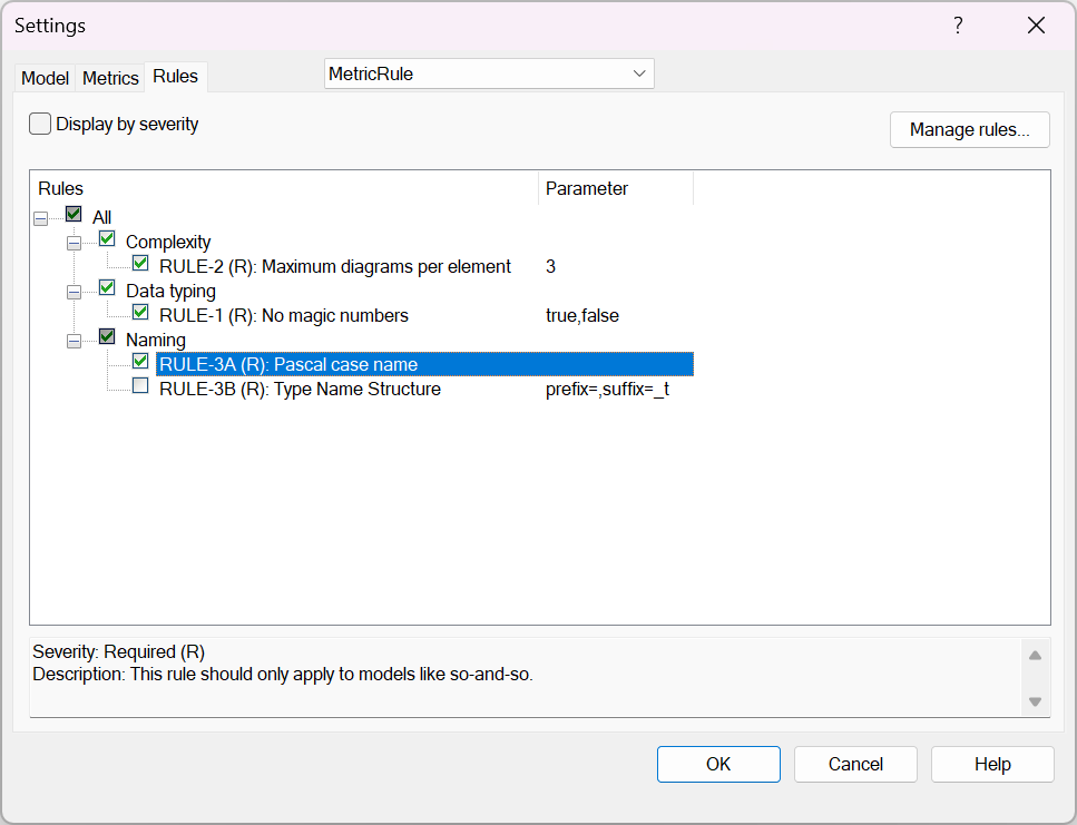

Your metrics and rules are now defined and registered with your model. Under Project > Metrics and Rules Checker > Settings…, you can now see them appear in their respective tabs:
Custom rules registered with the current model. Note the customized labels and descriptions.In this dialog, you can make some final tweaks to rule application on the current model:
- The Model tab allows you to restrict rule application to some parts of the model only.
- The Metrics and Rules tabs allow you to selectively enable metrics or rules for the current model. In the image above, we have ticked RULE-3A Pascal Case Name for this model, and unticked RULE-3B Type name structure.
- For rules that have a parameter under the Rules tab, you may overload the parameter value by double-clicking it or using the F2 keyboard shortcut.
