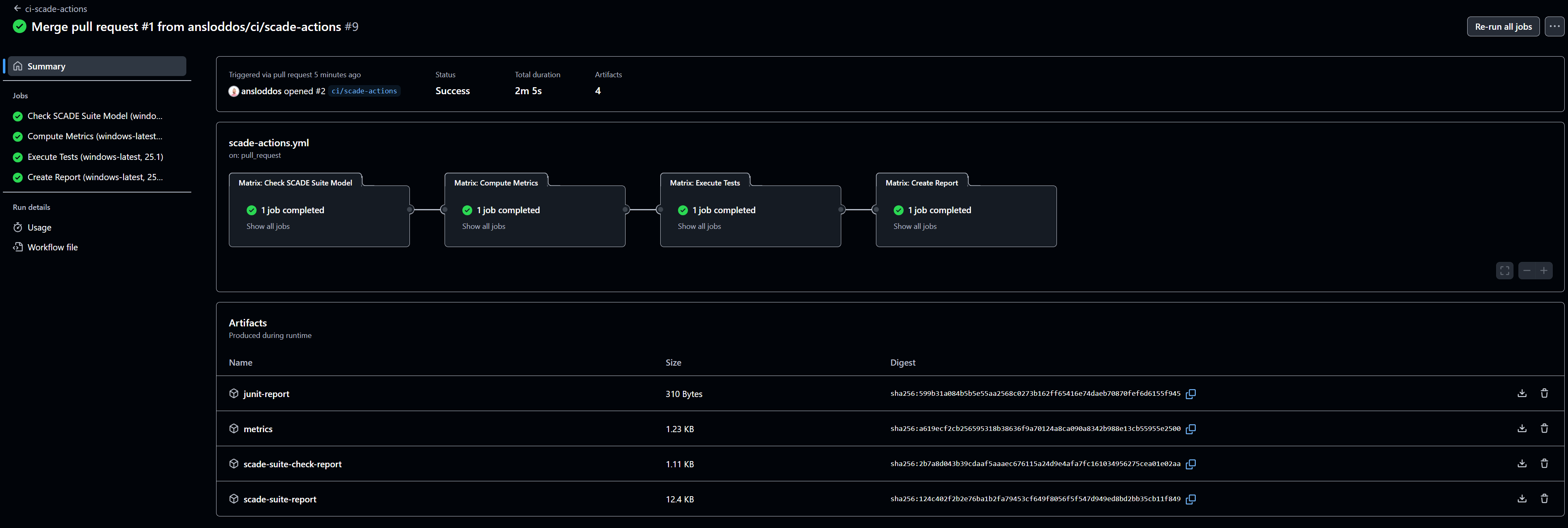

Below is a screenshot that shows a successful run of this workflow on the CruiseControl example model provided with SCADE Suite. Notice the artifacts attached to the workflow in the bottom half of the image:

Finally, we get the main part: listing the jobs that compose the workflow and how they chain together (
jobs:section). Each job in the sequence depends on the previous one (needs:section). This means it won’t run unless the previous job is finished and successful.Below is some detail on the steps performed by each job:
scade-check:- Clone the repository onto the runner machine.
- Determine the SCADE installation directory (
get-scade-dir). - Verify semantic correctness of the SCADE model (
suite-checkon the main operator,CruiseControl.etp). - Upload validation report for archival.
scade-metrics:- Compute metrics using configuration “MetricRule”, defined inside the model.
- Upload the generated metrics report for archival.
test-execute:- Execute tests (
test-execute). - Store results in JUnit XML format.
- Upload test results for archival.
- Execute tests (
suite-report:- Create a model documentation report using the “RTF” configuration, defined inside the model.
- Upload the report as an artifact for archival.
