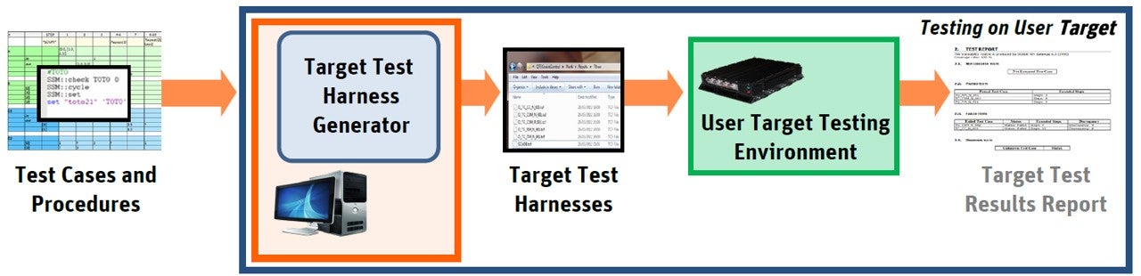

In Part 2 of this blog series, we have explained that simulation cases and procedures used for model simulation are requirement-based and developed against the TS. SCADE Target Test Execution allows users to translate the requirement-based simulation cases to target test harnesses used for target testing. This is supported by the so-called Combined Testing Process (CTP).
The Combined Testing Process (CTP) is a SCADE model-based efficient and optimized testing process:
- CTP is efficient: test cases and procedures are primarily developed from the Software Requirements Specification, in our case from the TS. This verification strategy focuses first on requirements functionality and integration issues that are often poorly and lately addressed in a traditional verification process.
- CTP optimizes testing efforts: when using SCADE Suite, testing effort of the logic (with SCADE Suite) is significantly reduced: the same requirement-based test cases and procedures are used for both model simulation on host and testing on target.
Factor simulation and test cases with SCADE Test Target ExecutionSoftware verification process

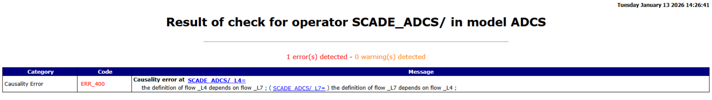

ECSS-E-ST-40C §5.8.3.3a and §5.8.3.4a require the verification of both the architectural design (including interfaces) and the detailed design.
First, syntactic and semantic checks using SCADE Suite KCG Semantics Checker can be performed to verify that the model follows the rules of the Scade language syntax and semantics (such as type and clock consistency, initialization of data flows, or causality in models).
Second, these verifications can be performed by reviews using the SCADE Architectural Design document and the SCADE Detailed Design document automatically generated by SCADE Suite Lifecycle Reporter. In addition, SCADE Model Change can be used for incremental reviews. The SCADE LifeCycle ALM Gateway supports the allocation of the requirements for the software item to the software components and units. When traceability has been performed, the traceability matrix can be generated from the ALM tool to support the design verification.
SCADE Suite Semantic Checker reporting an errorCode verification

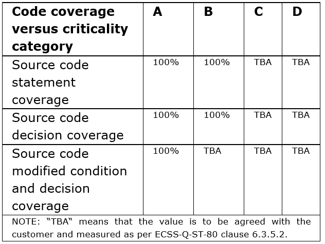

Code coverage measurement is required by ECSS-E-ST-40C §5.8.3.5b. The figure below provides the coverage goals per software criticality category. Some of these must be agreed between the customer and the supplier (ECSS-Q-ST-80C §6.3.5.2).
ECSS-E-ST-40C §5.8.3.5b notes as well that achieving code coverage goals shall be met by running unit, integration and validation tests, measuring the code coverage, and achieving the code coverage by additional (requirement based) tests, inspection or analysis.

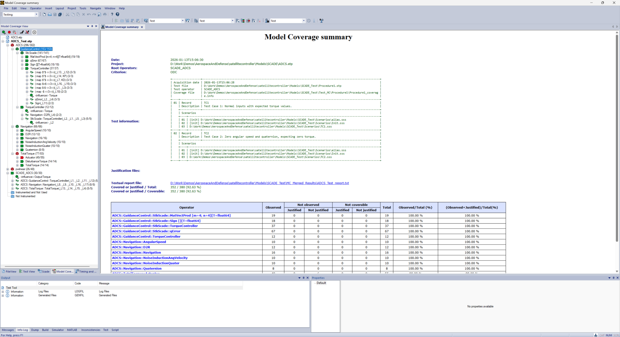

Within the SCADE Suite environment, coverage is measured at model level. Model coverage analysis assesses how thoroughly the SCADE model is exercised during model simulation using the requirement-based test cases and procedures. It helps assess the completeness of model testing and ensures that all model components behave as expected. Model coverage analysis contributes to the detection and resolution of shortcomings in the test cases or procedures, inadequacies or shortcomings in requirements, and deactivated or unintended functionality expressed by the design model. Model coverage is performed using SCADE Test Model Coverage.
Specific model coverage criteria for SCADE Test Model Coverage have been designed to:
- fit the entire Scade language: data flow constructs as well as logic-oriented constructs (state machines, clocked blocks)
- provide a sound and accurate assessment of the fact that every model construct and flow are exercised during model simulation
SCADE Test Model Coverage criteria are as follows: influence, observable decision coverage (ODC) and observable modified / decision coverage (OMC/DC). Following Table shows the correspondence between the coverage criteria of SCADE Test Model Coverage (Influence, ODC, OMC/DC) and the code coverage criteria of ECSS-E-ST-40C.
Model-level Coverage Criterion Code-level Coverage Criterion Influence statement coverage ODC decision coverage OMC/DC MC/DC SCADE Test Model Coverage guarantees that coverage at model level implies code coverage at the proper level (statement coverage, decision coverage, and MC/DC), when SCADE Suite KCG is used to generate the source code. To preserve the coverage implication, SCADE Test Model Coverage shall be used in compliance with the usage conditions stated in the SCADE Test Model Coverage certification kit.
More details about SCADE Test Model Coverage are available here.

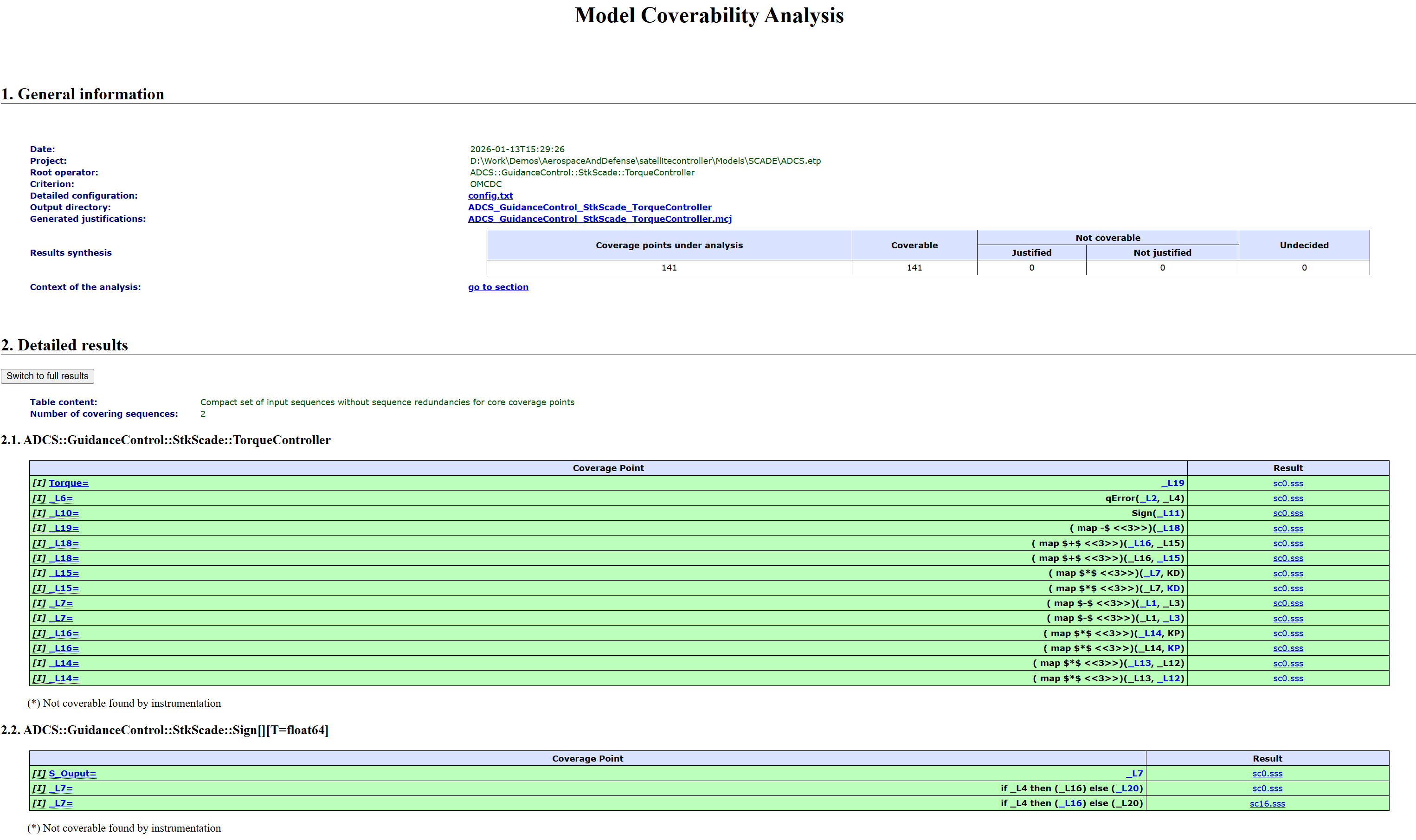

In order to support the achievement of model coverage, SCADE Design Verifier enables users to perform coverability analysis to detect the uncoverable parts of the SCADE model during the software design phase, which allows an early consideration of the objective. In addition, SCADE Test Environment for Host (TEH) provides a coverage assistance tool which enables users to analyze uncovered parts of the design and generate either a sequence reaching this part or a justification of its non-coverability.
SCADE Design Verifier Coverability AnalysisVerification of source code robustness

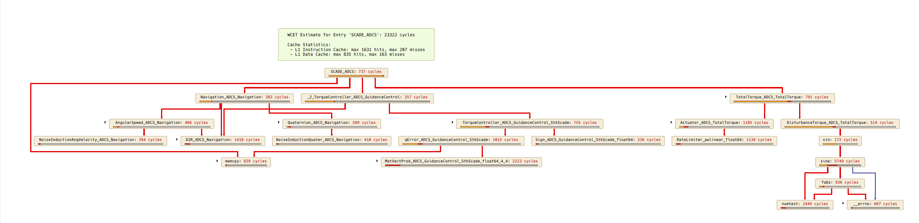

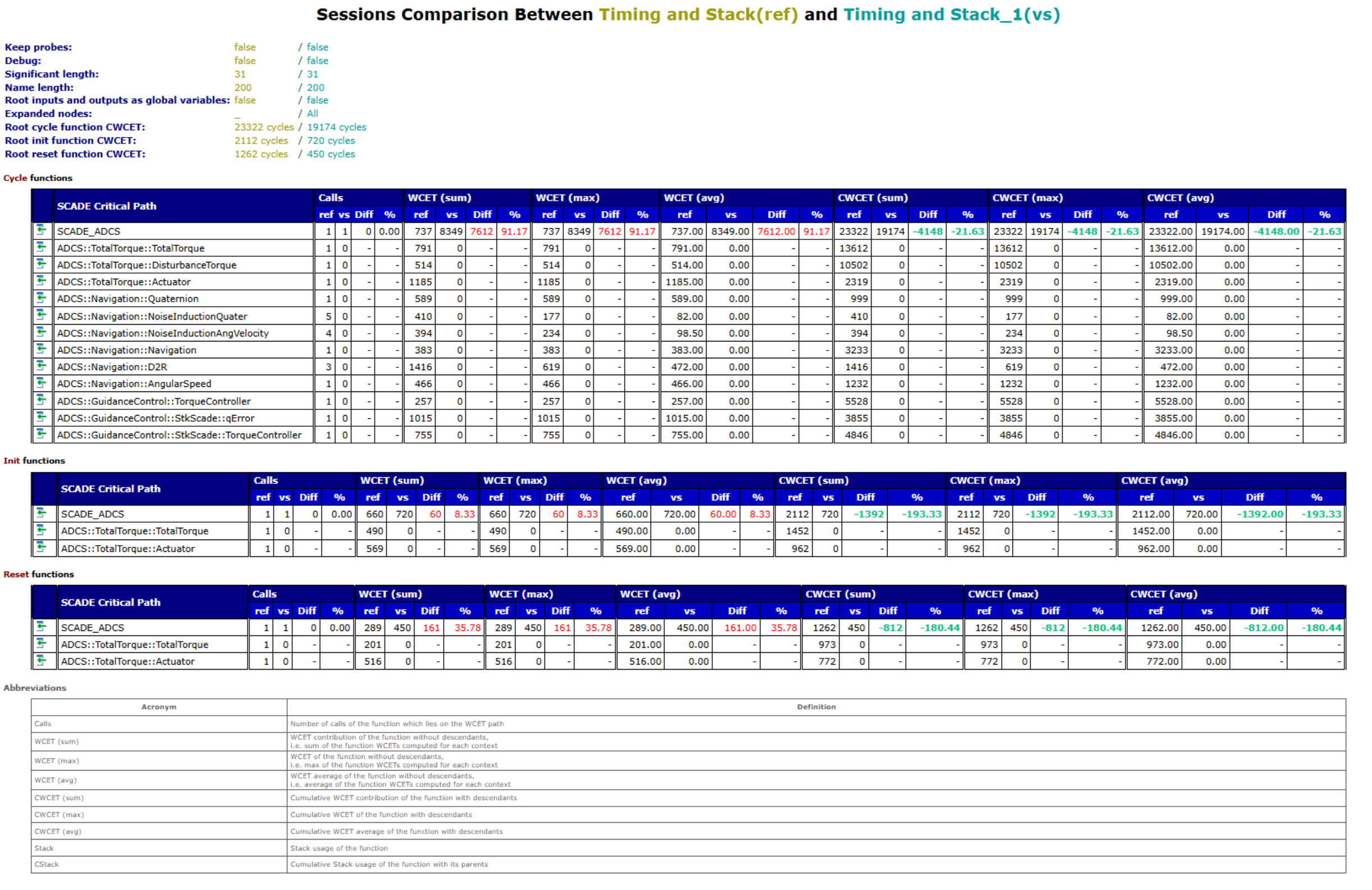

Timing and Stack Optimizer Analysis GraphECSS-E-ST-40C §5.8.3.12 requires the estimation of the technical budgets (including memory size, Processing Unit utilization, etc.) as part of the verification of the software requirements, software architectural design and software detailed design. The technical budgets shall be updated with the measured values and shall be compared to the margins as part of the verification of the coding, testing and validation. SCADE Suite Timing and Stack Optimizer (TSO) allows users to compute a safe estimation (i.e., overestimation) of the WCET and stack size for a generic platform.
To optimize the estimations, SCADE Suite Timing and Stack Optimizer can be used to iteratively:
- focus on the application parts causing long execution times or unsatisfactory memory usage and refine the application profiling by optimizing SCADE Suite models, and/or
- tune SCADE Suite KCG code generator options.
SCADE Suite Timing and Stack Optimizer allows users to generate a diff report showcasing the impacts of above optimizations on WCET and stack size estimation.
SCADE Suite Timing and Stack Verifier Gateway for AbsInt aiT is a gateway to the AbsInt aiT tool enabling its users to verify timing and stack usage requirements for the SCADE Suite generated code on a specified target processor. It estimates Worst-Case Execution Time (WCET) and the maximum stack size required by the application and reports the results at model level within SCADE Suite. The measurements can be compared to the estimates to determine whether they remain within the defined margins. The cross-compiler options can be tuned to support the optimization of measured values.

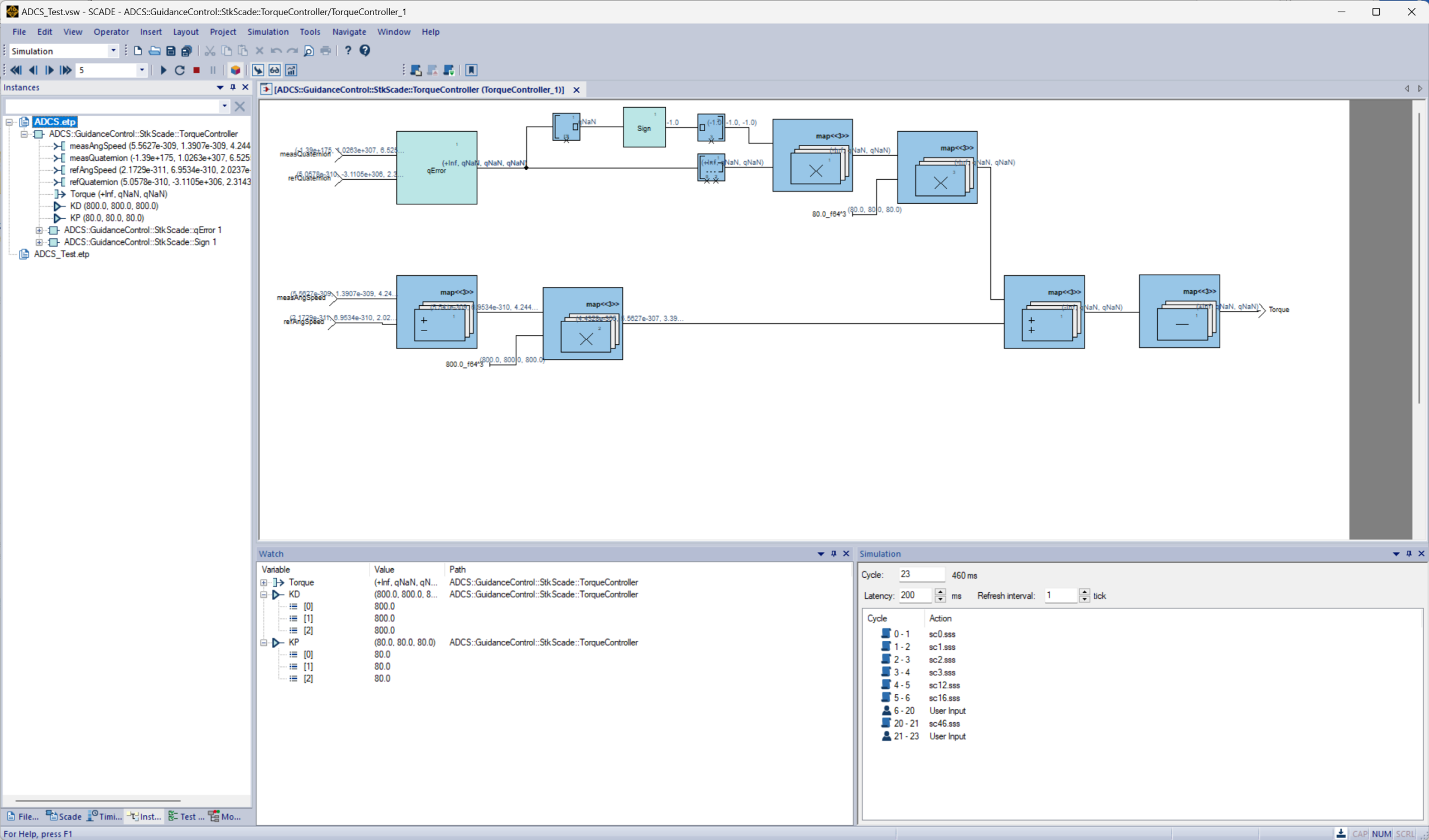

Verifying the software behavior using the software behavioral design model (Ref ECSS-E-ST-40C §5.8.3.13) is performed by simulating the SCADE Suite model, as this model includes the behavioral view. The SCADE model simulation consists in executing the model to verify its behavior against expected outcomes.
In addition, SCADE Suite development environment provides a powerful visual debugging environment that enables definition of stop conditions, setting breakpoints within a clock cycle, and examination of the internal variables and output values. It is also possible to record and play back scenarios. The behavior of the SCADE Suite model can be verified using these capabilities. It is also possible to record and play back scenarios. The ASCII format of the scenarios makes it easy to integrate within existing workflows. Debugging tasks can be tailored and automated using Python or TCL (Tool Command Language) scripting languages.
The SCADE Suite design can also be reused by directly integrating the generated code or a FMU in a system level simulator.
