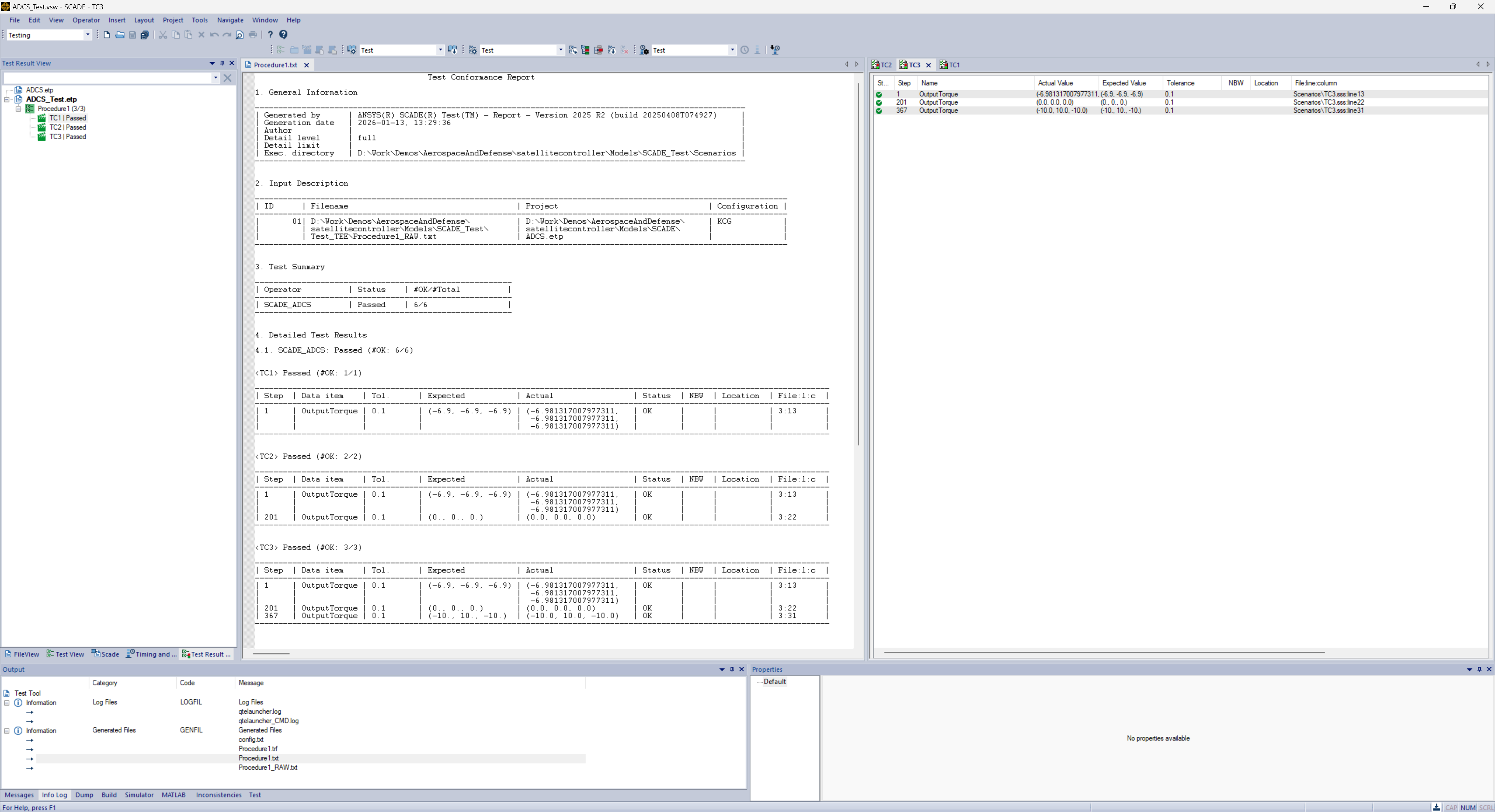

      Software Unit Testing
      ECSS-E-ST-40C §5.5.3.2a and §5.5.3.2b require to develop and document the test procedures and data for testing each software unit and to test each software unit ensuring that it satisfies its requirements and document the test results.
      Within the SCADE model-based development environment, unit testing is performed by simulation at model level using SCADE Test Environment for Host (TEH). Model simulation allows exercising the behavior of the model. Its main purpose is to provide repeatable evidence of compliance of the model to the requirements from which the model was developed. Moreover, model simulation is an efficient way to detect functional issues very early in the software design and/or upper-level requirements.
      SCADE TEH provides an integrated environment that allows the creation and management of simulation cases and their execution. First, the simulation cases and procedures are developed by the user from the Technical Specification (TS). Second, SCADE TEH executes the simulation cases and produces a qualified test execution report.
      SCADE Test Report

      • SCADE Test Environment for Host (TEH) supports dynamic verification of the SCADE Models by exercising them on host using requirement-based test cases and procedures.
      For more details about the verification activities, refer to part 3 of this blog series.

      • number of failures: provided by SCADE TEH which generates a compliance report with passed and failed tests.
