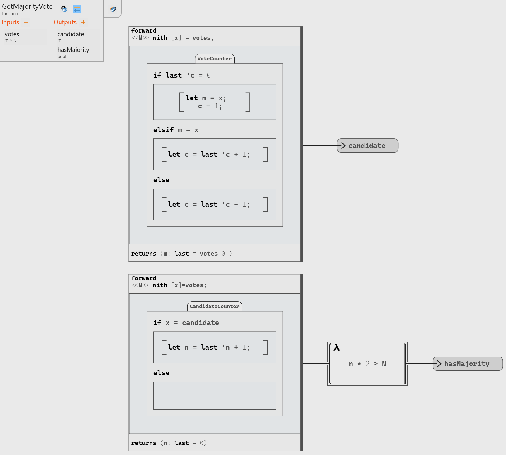

For our implementation we assume that we have an input array of N votes with at least one vote. We want to compute both the candidate and whether this candidate represents a strict majority among the votes.
The implementation in Swan is done in these steps:
- Implementation of a "vote counter" to compute the values of
candmat each step - An iteration of this counter on the sequence of votes to get the candidate
- A second iteration on the sequence of votes to count the number of occurrences of the candidate and then a comparison is done with N/2 to assess whether it is a strict majority
The "vote counter" corresponds to the following part of the pseudo-code:
If c = 0, then assign m = x and c = 1 else if m = x, then assign c = c + 1 else assign c = c – 1 We can implement this with an "Activate If" block that will activate a part of our model based on given conditions: we will perform the different assignments based on the conditions above.
As Swan is a data-flow language with sequential logic, the definition in a flow cannot depend on itself. Therefore, when incrementing / decrementing the variable
c, we need to use the keywordlast 'c, which allows us to reference the value ofcfrom the previous iteration. The same applies when checking the conditionc = 0.Computing the candidate
For the iteration to compute the candidate, we shall use the "forward" operator of Swan: a loop-like construct allowing to iterate a computation on a finite flow provided by an array (see this blog post for an introduction).
For the forward operator, we need to specify that:
- We iterate over all the N votes, and we access each vote with the variable
x: this corresponds in Swan to the notation<<N>> with [x] = votes; - The output of this iteration is the candidate
m, with a default (initial) value set to the first vote: we write it in Swan with the notationm: default = votes[0] - The variable
c(an integer) of the "vote counter" is a local variable for which we need the previous value, and the first value is 0: we write it in Swan with the notationc: int32 last = 0 - The body of the forward is the vote counter we just described
The next step is to count the number of occurrences of this candidate in the votes. To do so, we can use a forward block and specify that the initial value of our counter is 0 with notation
n: last = 0.We can then check whether this strictly more than half of the number of votes. To avoid rounding errors during integer divisions (e.g. 5 / 2 = 2), we will compare N and the double of the number of occurrences. One simple way is to use an anonymous operator that we implement with:
function n => n * 2 > N.The final model to compute both the candidate and whether we have a strict majority will look like the diagram below (with the votes being of a polymorphic type
