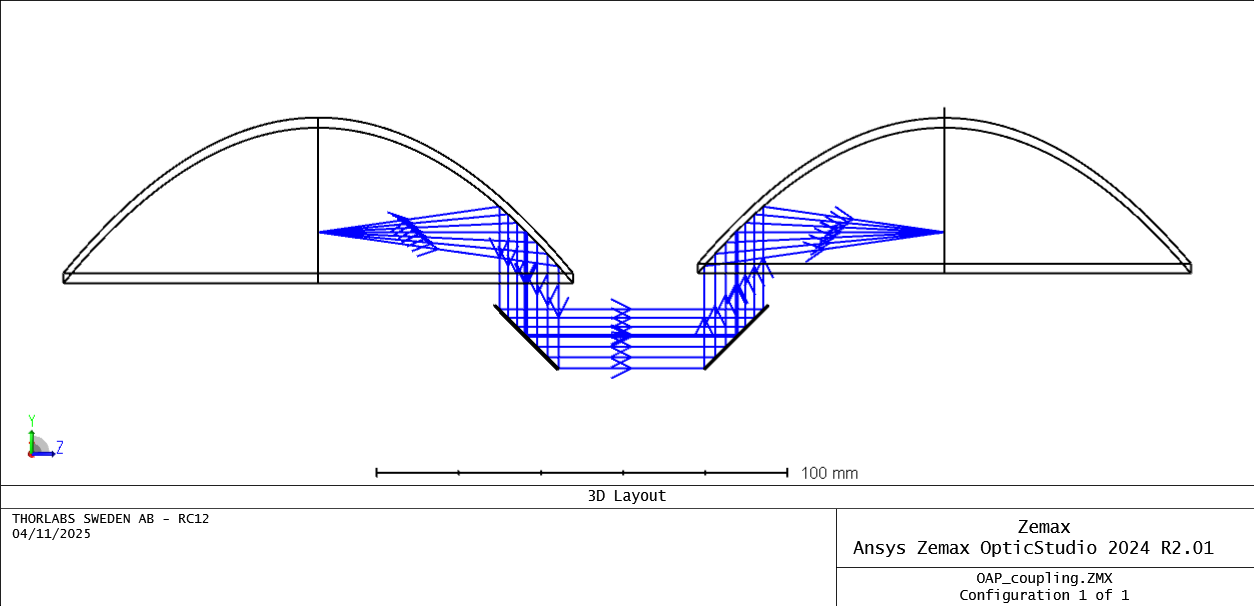

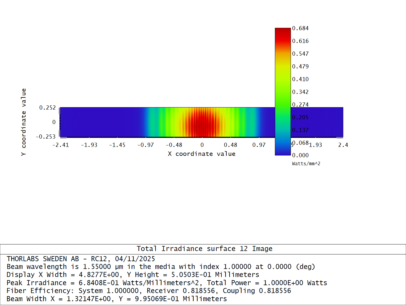

      Hi all,
      Based on this discussion (https://community.zemax.com/got-a-question-7/sending-collimated-light-onto-oap-3740), I have developed OAP coupling fiber to fiber coupling system. However, I am not fully confident that physical optics propagation and its coupling results are correct. Could you please suggest possible improvements in it? Specifically, is it necessary to use "Use rays to propagate to next surface" and "Use Angular Spectrum propagator" in this case?
      OAP coupling
      POP results
