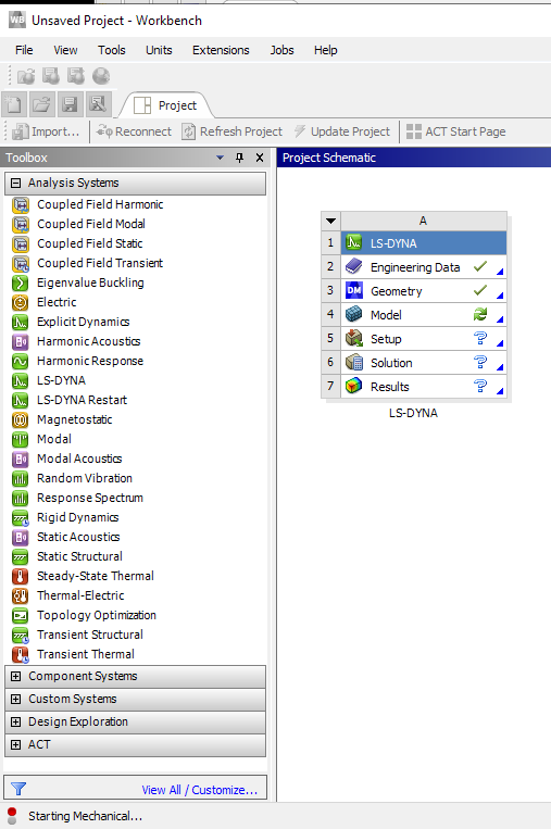

Since I upgraded Ansys From 2019R2 to 2021R1, I can't open the mechanical windows in workbench.
There is no error messages, only a message "starting mechanical...". Workbench is loading until I stop it in the task manager...
I let it run for more than one hour now, and there is still no messages or mechanical window.
Did somebody already faced this issue ?
Thanks !

AdministratorHello Is this the case with any project? Or is it only this specific project file? Are you able to create a new project and launch WB?
Also, could you please share a screenshot of the issue?

Ansys EmployeeHi
click on windows start button and type "msinfo32.exe" and click "System Information" in results.
Expand Software Environment and Navigate to Environment variables in the left pane, then click in the right pane of system information, press Ctrl + A to select All and Ctrl+C to copy the listed environment variables
Paste the contents in a response here

SubscriberHi ANS_OLD_ATTACH 1
ANSYS211_DIR C:\Program Files\ANSYS Inc\v211\ANSYS
ANSYS_CLIENT_DISABLE_FNO_PING 1
ANSYS_SYSDIR winx64
ANSYSLI_ELASTIC 0
ANSYSLI_ELASTIC 0
ANSYSLI_LCP 0
ANSYSLI_LCP 0
AWP_LOCALE202 fr
AWP_LOCALE211 fr
AWP_ROOT211 C:\Program Files\ANSYS Inc\v211
BPPDOMAIN_MANAGER_ASM EdrDotNet, Version=7.5.0.36150, Culture=neutral, PublicKeyToken=da1b3922653ea916
BPPDOMAIN_MANAGER_TYPE EdrDotNet.EdrAppDomainManager
CADOE_LIBDIR202 C:\Program Files\ANSYS Inc\v202\CommonFiles\Language\fr
CADOE_LIBDIR211 C:\Program Files\ANSYS Inc\v211\CommonFiles\Language\fr
LSTC_LICENSE ANSYS
NUMBER_OF_PROCESSORS 8
P_SCHEMA C:\Program Files\ANSYS Inc\v211\AISOL\CADIntegration\Parasolid\PSchema
Path %SystemRoot%\system32;%SystemRoot%;%SystemRoot%\System32\Wbem;%SYSTEMROOT%\System32\WindowsPowerShell\v1.0\;%SYSTEMROOT%\System32\OpenSSH\;C:\Program Files (x86)\Common Files\Hitachi ID\;C:\Program Files\Common Files\Hitachi ID\;C:\Program Files\Citrix\System32\;C:\Program Files\Citrix\ICAService\
Path %USERPROFILE%\AppData\Local\Microsoft\WindowsApps; NT AUTHORITY\SYSTEM
PATHEXT .COM;.EXE;.BAT;.CMD;.VBS;.VBE;.JS;.JSE;.WSF;.WSH;.MSC
PROCESSOR_ARCHITECTURE AMD64
PROCESSOR_IDENTIFIER Intel64 Family 15 Model 6 Stepping 1, GenuineIntel
PROCESSOR_LEVEL 15
PROCESSOR_REVISION 0601
PSModulePath %ProgramFiles%\WindowsPowerShell\Modules;%SystemRoot%\system32\WindowsPowerShell\v1.0\Modules;C:\Program Files\Citrix\Telemetry Service\
TEMP %SystemRoot%\TEMP
TEMP %USERPROFILE%\AppData\Local\Temp NT AUTHORITY\SYSTEM
TMP %SystemRoot%\TEMP
TMP %USERPROFILE%\AppData\Local\Temp NT AUTHORITY\SYSTEM
UATDATA C:\WINDOWS\CCM\UATData\D9F8C395-CAB8-491d-B8AC-179A1FE1BE77
USERNAME SYSTEM
windir %SystemRoot%
You'll find here the environnement variables.

SubscriberHi, dose this problem solved?
I encoutered the same prolblem when I upgraded Ansys from 2019R2 to 2021R2 or 2022R1. Even I uninstall all ANSYS products and re-install Ansys 2021R2, there is the same problem.
Does anyone know the reason and solution? Thanks in advance.
