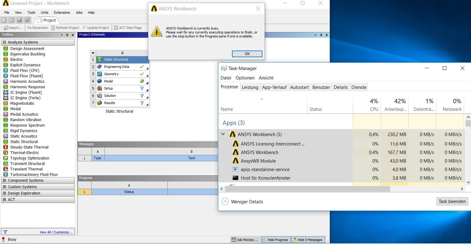

Workbench 19R1 works but mechanical doesn´t open
    • Hannes
      if I start the mechanical nothing happens, only the grey window rises.
      If I close the mechanical, I get the following error message:
      Error while waiting for Mechanical initialization to complete. Either the application crashed or Workbench lost communication with it.
      What could be the problem over here?

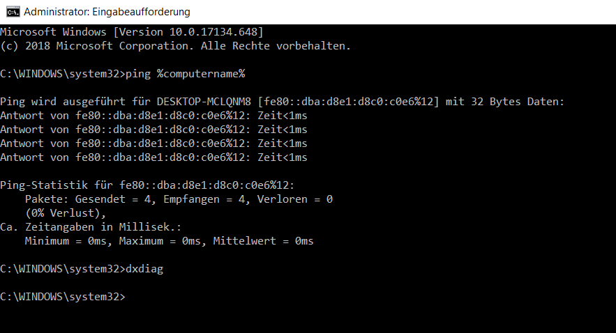

    • tsiriaks
      Hi Hannes,
      Open CMD Prompt, then issue the following command
      ping %computername%
      then post the output of it here.
      Also in CMD Prompt, issue this
      dxdiag
      then go through each 'Display' tab and post the screenshot of it here
      Thanks,
      Win
    • Hannes
      Hi win,
      So here are the screenshots:

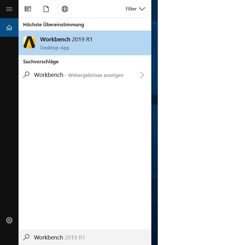

      If I issue the commands, Workbench starts but with the same Mechanical problem. I always have to start the workbench with that path (desktop shortcut) in my normal user account, because when I type "Workbench" in the search bar, there only comes that:
      So when I use the dummy account, I have a clickable link but the mechanical doesn't work anyway.
      Thanks

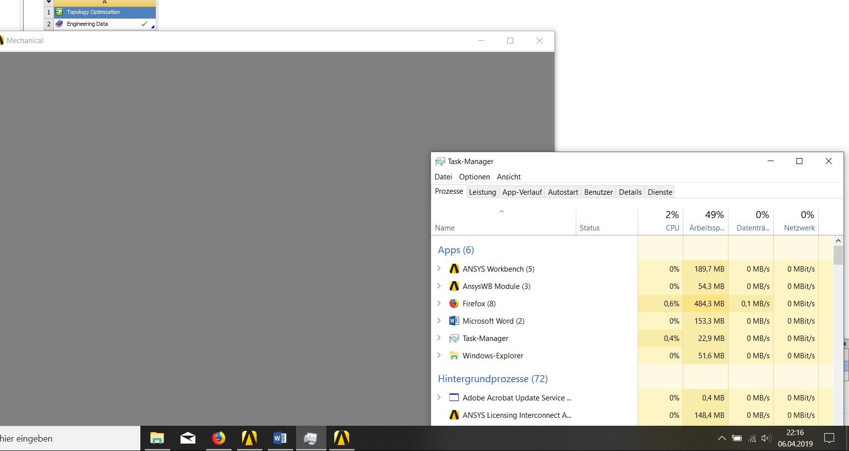

    • Hannes
      ...and if I insert the geometry and click refresh project, the whole program hangs up and I can´t close the workbench:
    • tsiriaks

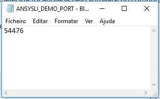

    • Hannes
      Hi Win,
      So if open DesignModeler I get that error message:
      I don't have any .err file.
      Thanks
