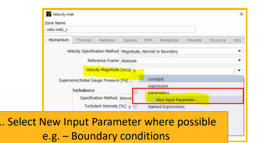

Parametetric Analysis you can check:Â Performing Parametric Analyses Using Ansys Fluent
Another method is use Parametric Settings using Ansys Workbench, but if you dont know how to use it please follow the provided link or change the boundary conditions manually and study your output with respect to input. You need to run the case multiple times . Chapter 2: Parametric Analysis in Ansys Workbench Using Ansys Fluent.
PS : You can add paramters where you provide boundary conditions , I am attaching SS here . Also check your theortical calculations, material properties, assumptions etc.Â
