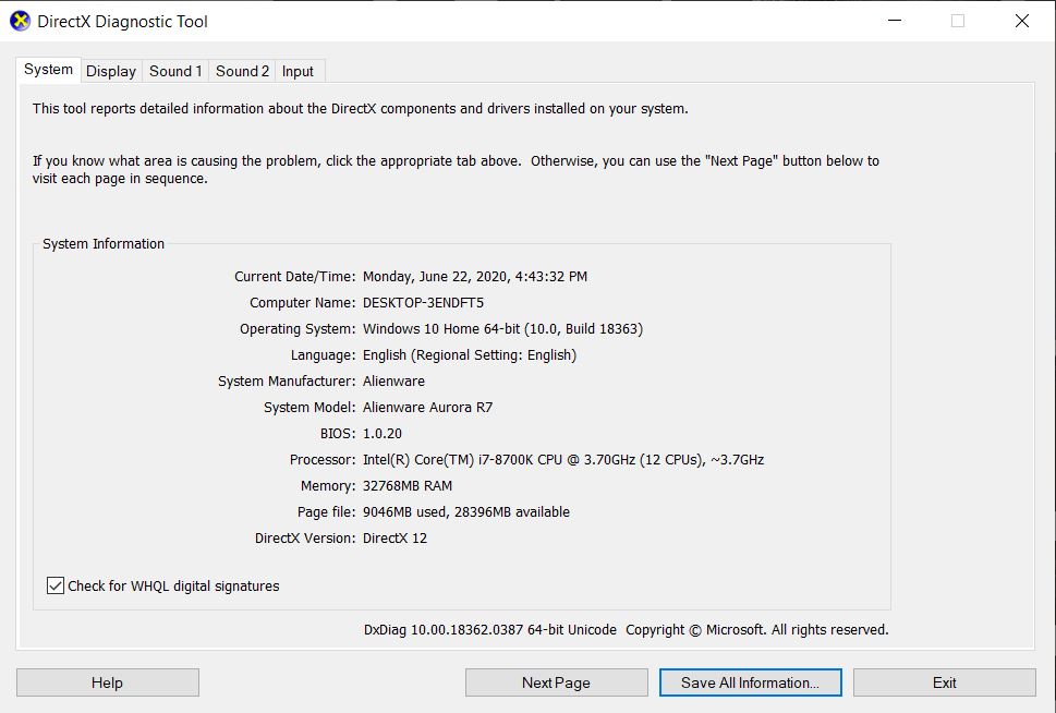

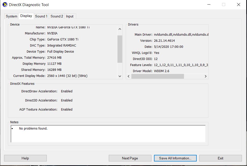

      Hi Kelvin,
      Please include the screenshots of dxdiag main tab and display tab, inline with text.
      Thanks,
      Win
    • Kelvin
      Hi tsiriaks,
      Thanks for the reply and sorry for the delay. Here are the screenshots you requested.
      Here's also an update on this bug: it can be solved by just closing and reopening the project itself, without restarting HFSS itself. Though it is easier to solve, but it is still quite bothering. Please tell me if you want any more info about my machine. Thank you for your time!
