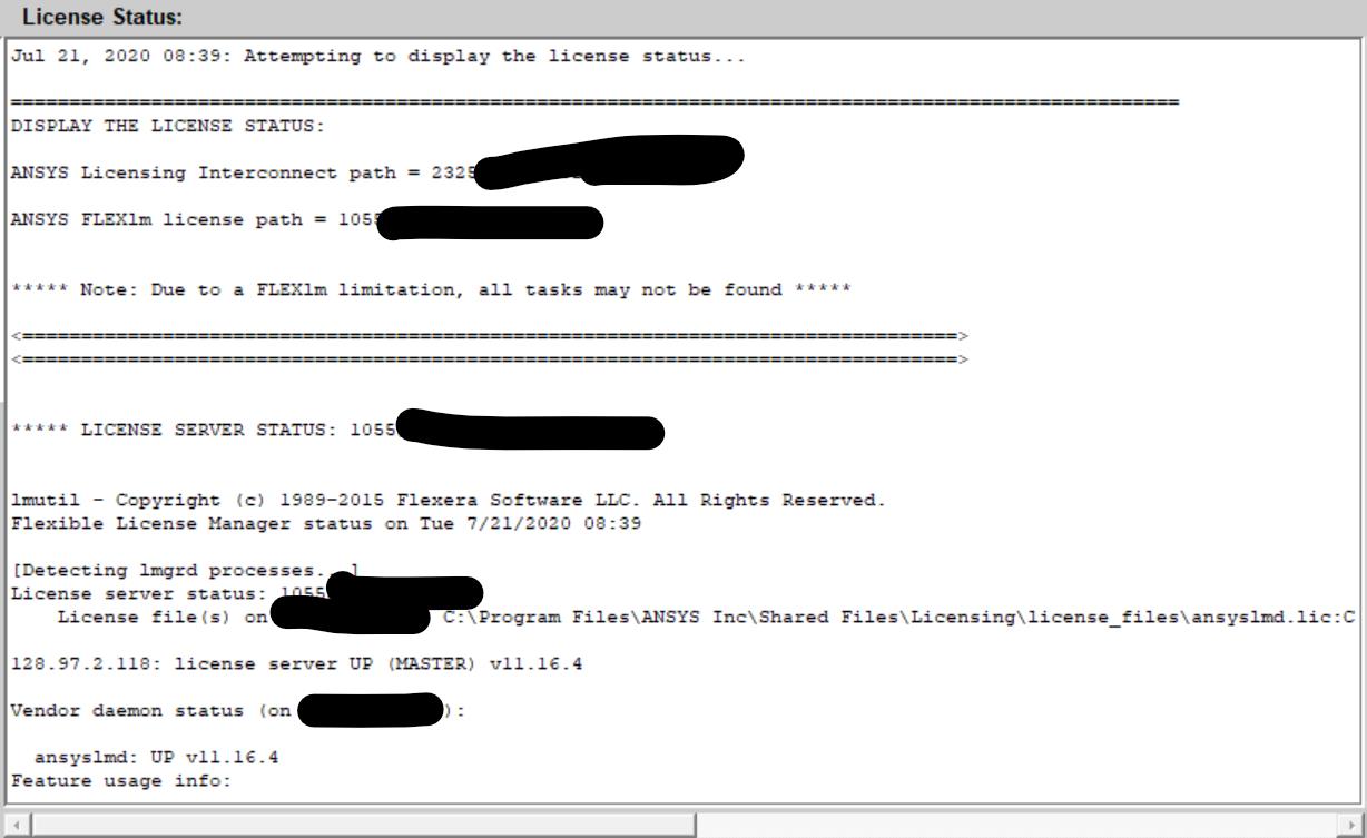

I'm running a license server and is able to start it and confirm that all license are available. However, it stop working about 15 minutes later and I see "The License managed is stopped." message and in the "View Licensing Interconnect Log" I see the following error message.
It also very unusual that on my client side, the "Client ANSLIC_ADMIN Utility" status page seems to indicate that the server is still running? Also, I tried removing the "ansyslmd.lic" file and rereading the license file but that did not seem to help. And it was working fine for a while and it just suddenly stopped. Another odd thing, "Electronic Desktop" seems to be working fine but "Workbench" is not able to retrieve license.

There is an issue with your 'ansysli_server.exe' process to bind the socket 2325 (which is its default port)
The fact that license status and AEDT licensing works means your lmgrd.exe and ansyslmd.exe, which are pure FlexNet licensing, is working fine.
You can try adding Firewall exceptions/Anti-virus exclusions to the ansysli_server.exe process.

I added Firewall exception to "ansysli_server.exe" to both Inbound and Outbound Rules and I'm still getting the error message from "View Licensing Interconnect Log" reproduced below. I did also confirm that I am able to telnet from a client to host on port 2325 and it did have the expected response.
2020/07/22 10:21:55 ERROR Could not bind socket on port 2325. An attempt was made to access a socket in a way forbidden by its access permissions.
And I did have a second NIC card that was disabled but I went ahead and replaced the IP address with host-name anyway. It did not fix the problem. Like before, "ansysli_server.exe" will fail to "bind socket to port 2325." for 15 time and exit. I also have a "Npcap Loopback Adapter" and I did try it with enable and disable and that did not make a difference. BTW, I was not able to find "C:Program FilesANSYS IncShared FilesLicensingansyslmd.ini" file in my server so I just changed the IP -> hostname in the license file and reread it.
