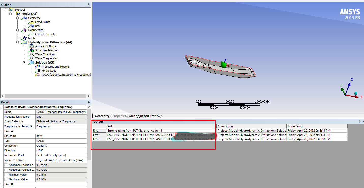

April 29, 2022 at 5:38 amtumulpurwar
SubscriberHello MikePettit
I followed what you said for that error, i am still getting that error..photos below
Can you tell, if i did something wrong

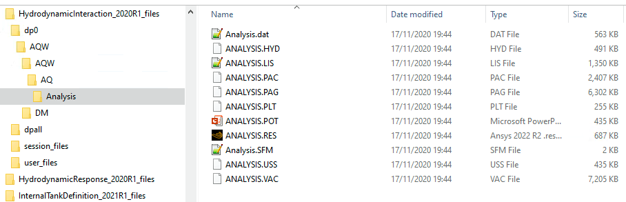

April 29, 2022 at 7:57 amMike Pettit
Ansys EmployeeThe Analysis.PLD and Analysis.PLS files need to be created in the 'solver files directory' - this is where the Aqwa solver reads and writes data. Inside the folder '28-04-2022 Hydrodynamic diffraction_files', you will find a folder structure like this:
The folder 'dp0' is the top level design point directory - if you run a parameter study in Workbench you will get many 'dp' folders created, but usually everything happens inside dp0.
Inside dp0 you will find one or more 'AQW' folders - one for each of the Hydrodynamic Diffraction or Hydrodynamic Response systems on your Project Schematic. To find the directory name corresponding to a particular system, right-click and view Properties on the Model cell of that system:
Next, navigate through the AQW subfolders, then in the Analysis directory you will find the Aqwa input and output files. It is in here that you need to create the PLD and PLS files.
I hope this helps!
Cheers, Mike

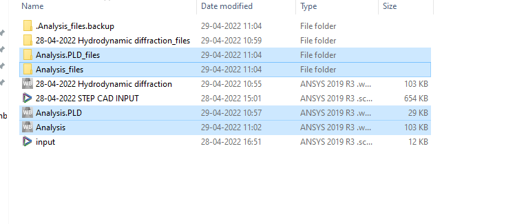

April 29, 2022 at 12:32 pmtumulpurwar
SubscriberhI MikePettit
I did what you said..Still error remains
1)Created dummy files
2)Opened my Ansys simulation file, click Evaluate Results button
3)Copy dummy files created in first step, in M drive to location (photo below)
4)Nothing happened, still error
Can you please tell, what still going wrong..thanks
April 29, 2022 at 1:46 pmMike Pettit
There are 2 issues that need fixing here: the file extensions and the PLT file modified time.
Your file extensions are 'wbpj' instead of pld/pls. In Windows Explorer, under View, check 'File name extensions':
Then correct ANALYSIS.PLD.wbpj to ANALYSIS.PLD, and ANALYSIS.PLS.wbpj to ANALYSIS.PLS. You will get a warning:
Just click Yes.
Before you can evaluate the results, you also need to force the ANALYSIS.PLT modified time to be newer than the PLD/PLS files. To do this, right-click on ANALYSIS.PLT and Open With..., then select a text editor (Notepad, Notepad++ etc). The PLT file is in binary format, so you will see a lot of junk like this:
Make a small change to the file (just type a character somewhere), save, then undo the change and save again. This updates the file modified time, so that it is more recent than the PLD/PLS file times.
Now go back to Aqwa Workbench, and you should be able to Evaluate All Results successfully.
Note - you will need to repeat these steps every time you re-run the Hydrodynamic Diffraction analysis, as the solver files directory is cleared each time you Solve.
If possible, please update your version to something more recent than Release 2019 R3. Then you will be able to install a patch which fixes the problem properly.
Cheers, Mike
