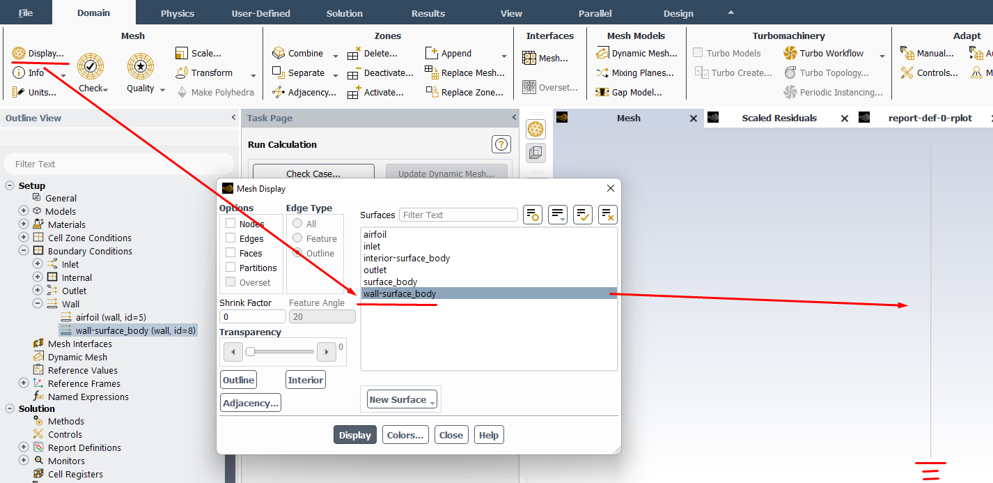

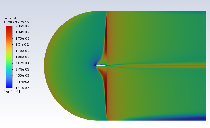

I have been working on a ansys fluent model of 2D airfoil. To compare the different turbulence models i have been trying to acquire a variety of contours but have been running into problems with this. Especcialy the turbulent viscosity contour has been giving me strange results. Does anyone know what might be the problem with my simulation?
Kind regards,Â
Lucas -

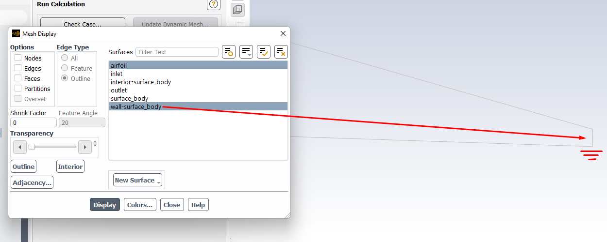

Forum ModeratorCan you do a mesh display, walls only and post the result? Â

January 30, 2023 at 5:15 pm
Rob
Forum ModeratorDid you form a multibody part (DesignModeler) or use share topology (SpaceClaim) before meshing? I can't see a wall & wall:shadow pair so it's not quite as easy to fix as it could be.Â
January 30, 2023 at 5:18 pm
Lucas van Rossum
SubscriberI dont think i used any of those things since i have not heard of them before. I imported the airfoil using the 3D curve option in the geometry application. is there a better way?
January 30, 2023 at 5:25 pm
Rob
Forum ModeratorThat bit is OK, it's how you formed the outer region that's probably an issue. Have a look at the geometry tool tutorials, you need to ensure the outer region is continuous to avoid blocking the flow.Â
