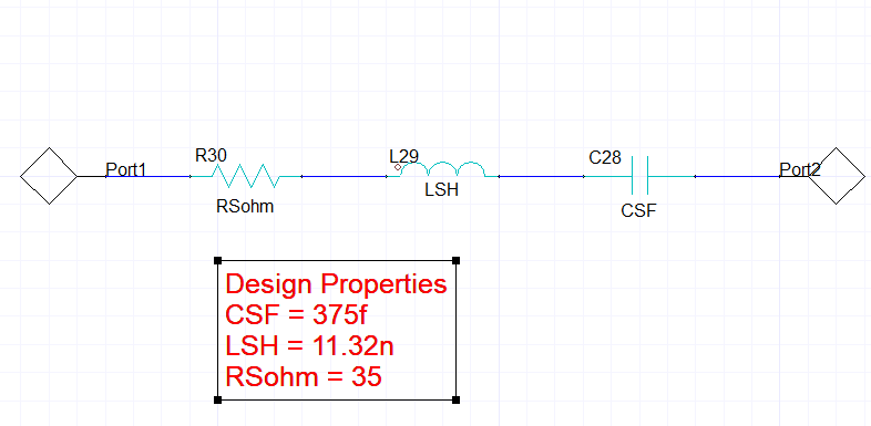

      Hello there,
      So I designed a series RLC matching network for an antenna in HFSS then I imported the design as a dynamic hyperlink into HFSS circuits where I actually made the matching network. Now in HFSS circuits it's not like AEDT (3D modeller) where if you want to tune you just set your variables as derivatives and tune your plots. within the matching network, I made all the variables for R, L, and C values must be local variables so I don't know exactly how to tune them because I am new to HFSS circuits. I have some images below to give a better understanding, thank you as you get back to me.
      patch antenna from 3-D modeller
      matching network:
      Assembled system:

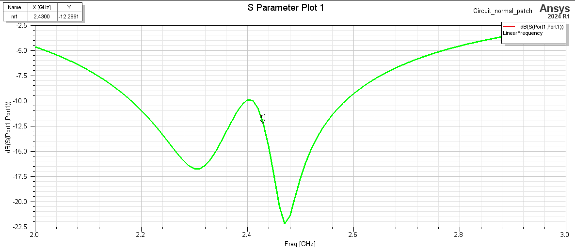

      sample results:
      i just want to tune my response a bit, thanks!

      You can define R, L, C as variables in Cistuit and add a parametric sweep. With this you can see how the response of the matching network changes with respect to R,L,C.

      Hello Faezeh yea i know i can run a parametric sweep but it gets tedious when dealing with more than one variable. Tuning is better for this case, thank you though!

      in circuit, one s1p touchstone file represents the HFSS design. You can run Parametric setup in Circuit design with several variations of all 3 variables. It will run very quickly since it will not require to re-run HFSS design.
      You can even export S-parameters from HFSS design and import *.s1p file into the Circuit design instead of linkng HFSS design.  The circuit design variations run extremely quickly compared to HFSS design. After that, you can use Optimetrics > Tuning to choose the variation closest to wha you need. Also, using Optimization in Circuit design to let Circuit solver (Nexxim) to choose the values of variables is the best option in my opnion. In circuit, there is no Derivatives option similar to the one in HFSS. You can check Sensitivity option under optimetrics if the goal is to report derivatives values, not to tune the variables.

      Thank you for the response again, i was able to just copy the components from the matching network out into the main schematic and then play around with it. I tried your method of putting in normal passive components but the components are not normal...
      For instance, the resistor will ask me for resistivity, the capacitor will ask me for a number of turns but i found a way around it. for the tuning I just exported my S1P file to ADS and tuned with series RLC values there then copied those same values to HFSS and I fixed my alignment issue.
      Thank you so much Irina.
