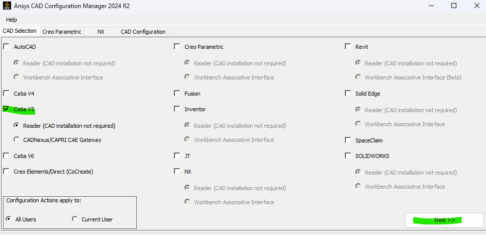

SubscriberI'm trying to import a .catPart into the workbench, which ive done on my school computers multiple times, but i just downloaded ansys onto my home computer to continue working on it, but i keep getting the "The selected file is of an unsupported or unconfigured Geometry type." error when im trying to import the geometry, im using the exact same file that ive used on my school computer so i dont know why it wont just import.

Ansys EmployeeThis issue may be due to the Catia V5 Plugin Error with the workbench. Please follow the below steps to configure the Catia V5 Plugin.

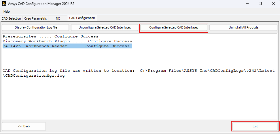

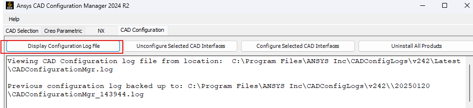

1. Open the CAD Configuration Manager (From Windows, right-click the Start > CAD Configuration Manager 2024 R2), and select Catia V5. Then Click Next.2. Press the "Display Configuration Log File" button.
3. Press the "Configure Selected CAD Interfaces" and "Exit".
Let me know if this helps
