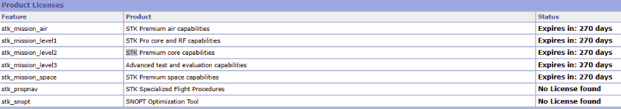

SubscriberI am modeling a deorbiting scenario on Mars with STK, where I was planning to use Astrogator to propogate a satellite through Mars's atmosphere until it makes contact with the surface. However, it appears that the only Mars-based propagator available to me is the Mars Point Mass model, which neglects the effect of drag that I would like to consider in my simulation.
From my understanding, there is a Mars HPOP propagator model available in STK that I could use to integrate a Mars atmospheric model. This option is not available in my Astrogator propagator options, so I was curious if the Mars HPOP feature is contained in a license that I do not have access to, or if I am making a mistake when setting up my scenario. Here is a list of the product licenses that I do and do not have access to:

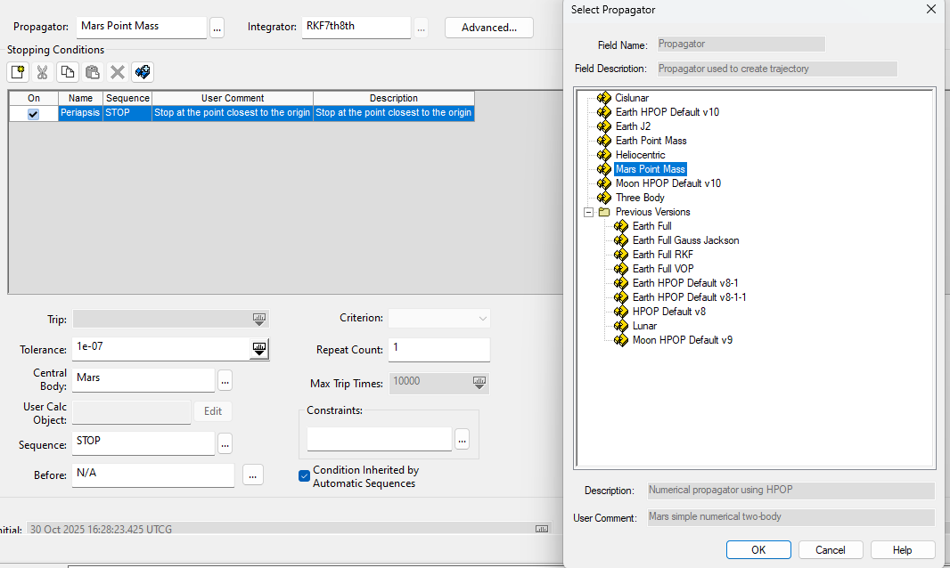

SubscriberThank you, this was definitely helpful. Is there a way to integrate this propagation model into the Astrogator mission control sequence or will I have to perform the deorbiting propogation outside of Astrogator?
For reference, Astrogator gives the following list of propagator options for the "propagate" control segment. Is it possible to manually add a new propagator to this list?
