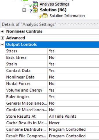

    • Ashish Khemka
      Please see if the following link helps you:
      Reducing Result File Size in Transient-Thermal-Electric Simulation (ansys.com)
      You can also find these options under Details of Analysis Settings --> Output Controls:
