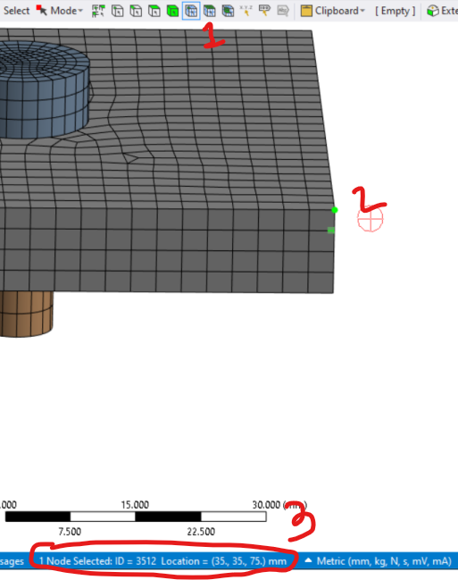

      Hello/Greetings!
      How the results probe could be done by picking the specific node in Workbench. When the probing is done, in "Graphics Annonations" the results value and coordinates values of the picked location, information is given.
      There is a tool,  "Select Mesh by ID" by clicking the RMB in the window, it highlights the node;
      Is there way to Probe the results by picking the node or the exact location of the node in Workbench?

      Hi Najeeb,
      1. Turn on the mesh and use mesh coping
      2. Select the node
      3. The node id and location are displayed here
