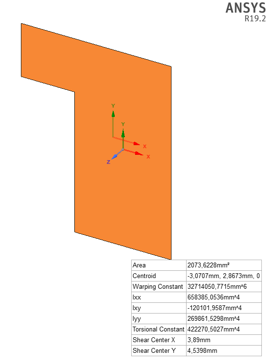

    • Tom Ber
      Hi mjmiddle,
      Thanks a lot for the answer. As i understand, If the body/face is not point-symmetric, then Ixy should be other than 0.
      Below I am sending you the code with the printed() values and the picture where you can see the values from "Mass Properties" tool. I wonder why the values read from Mass Properties are different from those read from GetInertiaTensor().
      selected_bodies = Selection.GetActive().Filter[IDesignBody]()
      Body1 = selected_bodies.Items[0]
      Centroid = Body1.MassProperties.PrincipleAxes.Origin
      Inertia_Tensor = Body1.MassProperties.GetInertiaTensor(Body1.MassProperties.PrincipleAxes)
      print("Centroid:{} mm".format(Centroid*1e3))
      Centroid:Point: (-3,07067122925524, 2,867257943362, 0) mm
      print("Ixx:{} mm^4".format(Inertia_Tensor[0,0]*1e12))
      Ixx:235733.0278 mm^4
      print("Iyy:{} mm^4".format(Inertia_Tensor[1,1]*1e12))
      Iyy:692513.5556 mm^4
      print("Izz:{} mm^4".format(Inertia_Tensor[2,2]*1e12))
      Izz:928246.5834 mm^4
      print("Ixy:{} mm^4".format(Inertia_Tensor[0,1]*1e12))
      Ixy:0.0 mm^4
      print("Ixz:{} mm^4".format(Inertia_Tensor[0,2]*1e12))
      Ixz:0.0 mm^4
    • mjmiddle
      Principal axes through the centroid should have zero terms for the product of inertia terms. The argument in the command is a Frame:
      The Body1.MassProperties.PrincipleAxes is a Frame with principal axes all going through the body origin. If you create a different frame not going through origin, the product of inertia terms will be non-zero.
      For the non-matching value to the GUI printout, see the comment in the code I sent:
      # only matches when no material is assigned so that mass=0
      So the values given by code are volume and area moments of interia, not mass moment of inertia. So you'll have to compute the mass moments of inertia.
