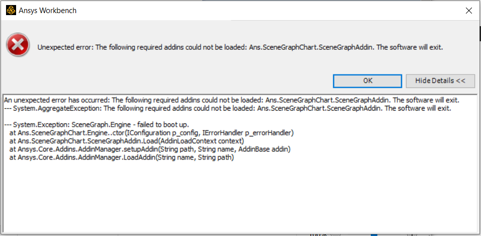

SubscriberHello, I just downloaded and installed the student R1. After installing it and rebooting my laptop, I cannot find "workbench" in my start menu. Then I tried to open a .wbpj file which I got from another computer, and it showed as below:
????????????????The following required addins could not be loaded: Ans.SceneGraphChart.SceneGraphAddin. The software will exit.
--- System.AggregateException: The following required addins could not be loaded: Ans.SceneGraphChart.SceneGraphAddin. The software will exit.
--- System.Exception: SceneGraph.Engine - failed to boot up.
  at Ans.SceneGraphChart.Engine..ctor(IConfiguration p_config, IErrorHandler p_errorHandler)
  at Ans.SceneGraphChart.SceneGraphAddin.Load(AddinLoadContext context)
  at Ansys.Core.Addins.AddinManager.setupAddin(String path, String name, AddinBase addin)
  at Ansys.Core.Addins.AddinManager.LoadAddin(String name, String path)
I have already updated graphics card driver and try again, ,but the problem persisited.
I hope you can help me find a solution, thank you.

Keyur Kanade
Ansys Employeeplease check admin permissions.Â
please check disk space.Â
please check hardware requirements.Â
https://www.ansys.com/solutions/solutions-by-role/it-professionals/platform-support
Please post the questions in appropriate category. Moving this question to other category to get better response.Â
Installation and licensing category.Â

Ansys EmployeeDo you have install.err file under (default location)Â C:Program FilesANSYS IncANSYS Student
If so, post the content of it here.
Also, open CMD prompt and enter the following command
"%awp_root201%FrameworkbinWin64runwb2.exe"
what do you get ?
Thanks,
Win
