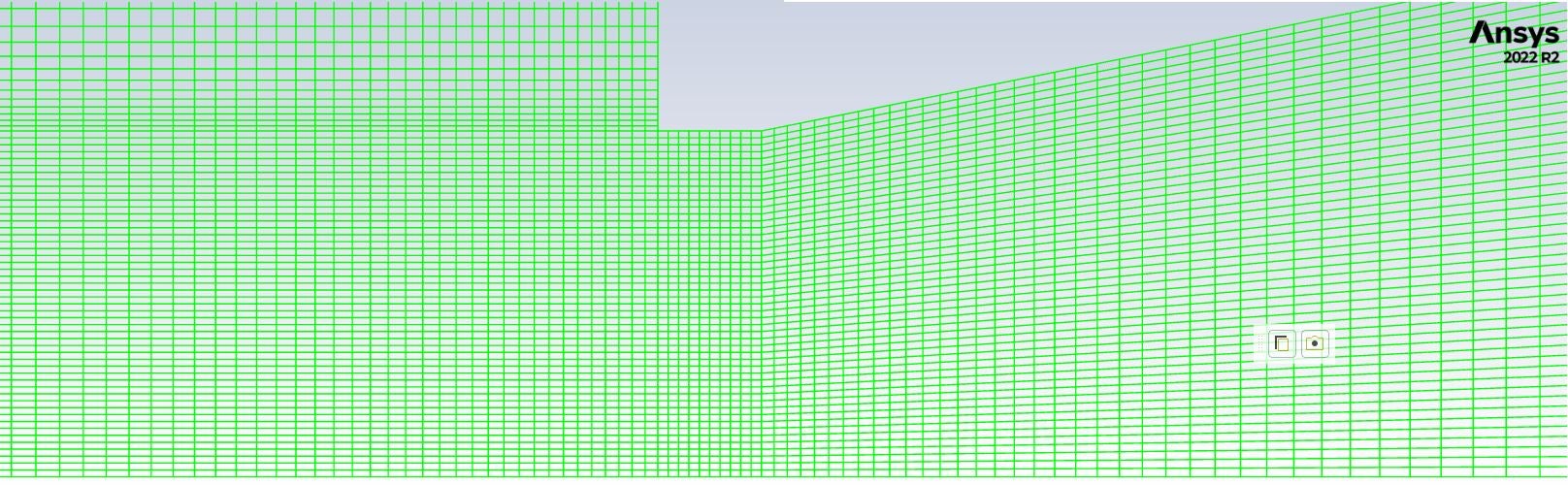

      I am running a 2D axis-symmetric model and am interested in looking at particle trajectories in the fluid. The particle trajectories are crossing the axis, my understanding is that for this type of space, particles shouldn't cross the axis, but rather be reflected about it. I am not sure what is causing this issue, any insight or help is greatly appreciated.
      That's unusual. Usually, if particles leave the domain they just keep going in the same direction. Check it is 2d-axi, and that you're using high-res tracking. How does the velocity contour & vector field look? From scale what is the minimum y coordinate. Please also zoom in on the angled edge - the mesh looks a little odd from your picture.
      • Salix Bair

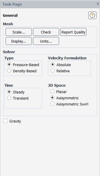

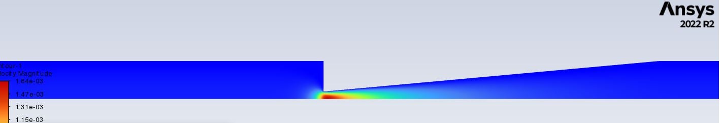

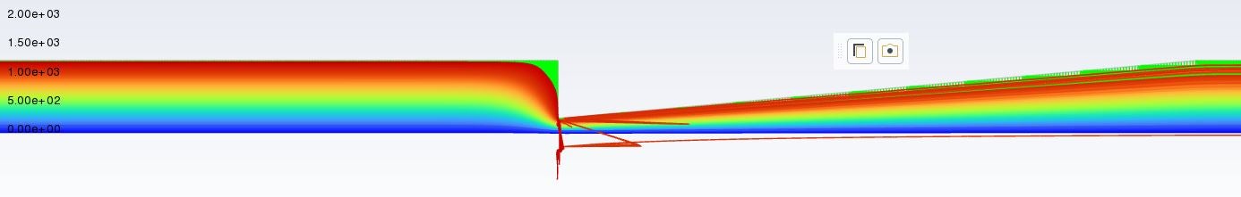

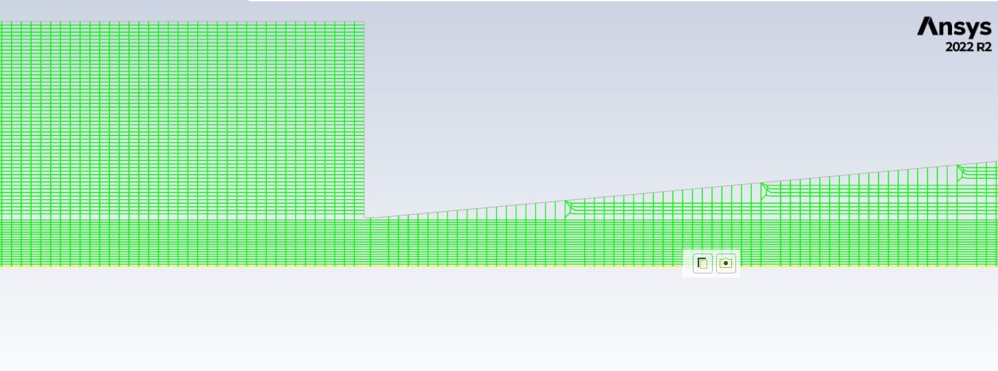

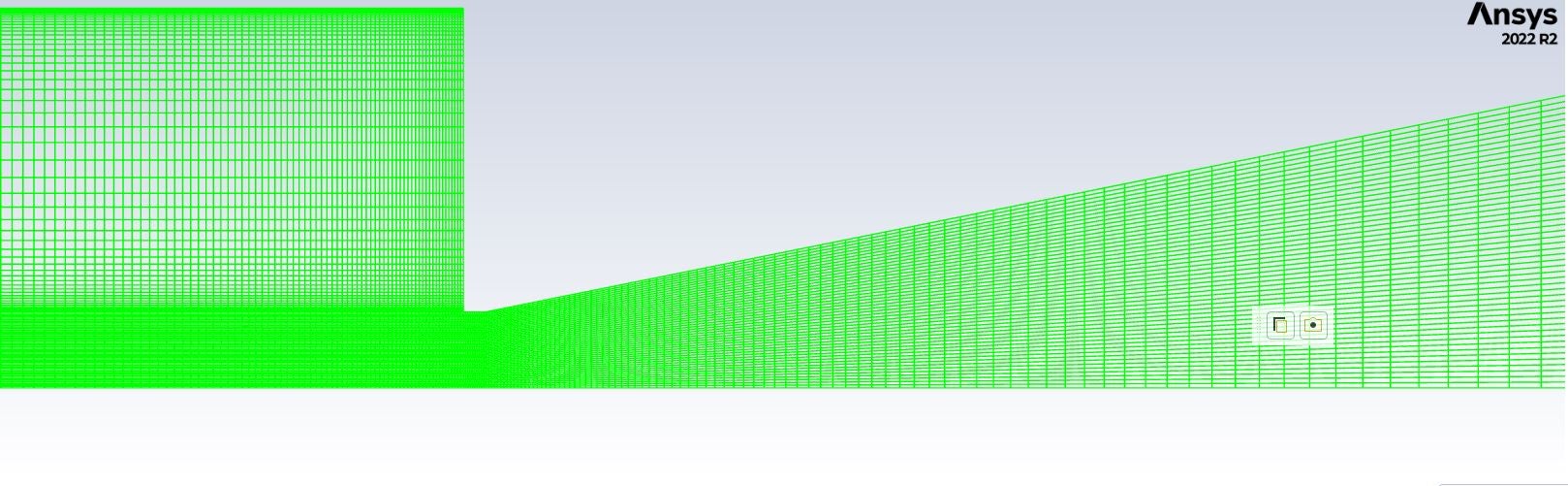

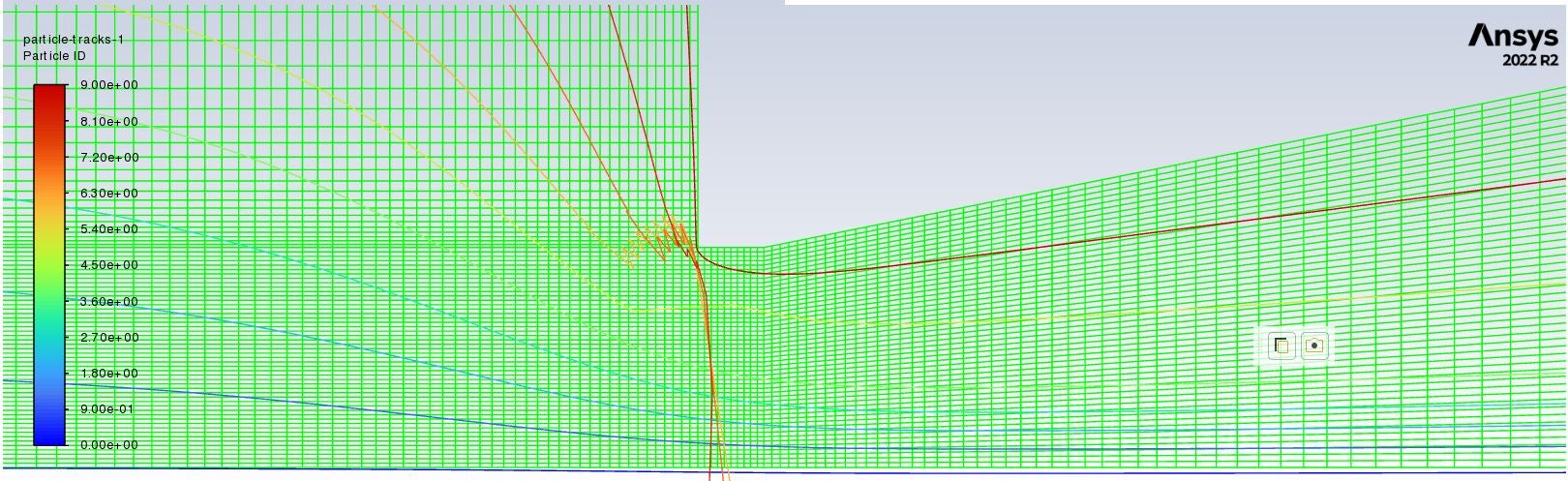

        I am using 2d Axis symmetric and high-resolution particle tracking. I am including my mesh at the angled edge, velocity contour, vector field, and another set of particle tracks. The minimum y coordinate is ~1mm below the axis, my geometry has a maximum height of 5mm.
      It's the DPM tracks getting very confused by the mesh. I have no idea how you've created that, but please review the meshing training and do it again. The jump in cell size is going to cause problems, and the aspect ratio will add to those problems.

        I have re-meshed my geometry, I have 5 bodies as 1 part. The model is set up as 2-D axis-symmetric, mass-flow inlet and pressure outlet, running for 200,000 iterations, however, the convergence criterion is reached long before. Even with the updated mesh, the particle trajectories are behaving the same as before. I even tried, starting a new workbench file, in case my original had been corrupted in some way. At this point I have no idea what the problem is.

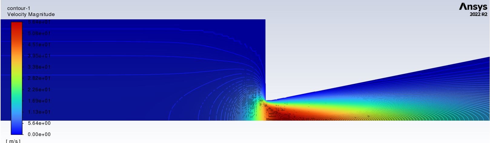

      What does the velocity field look like? To get particles bouncing like that takes something in the flow field or mesh.
    • Salix Bair

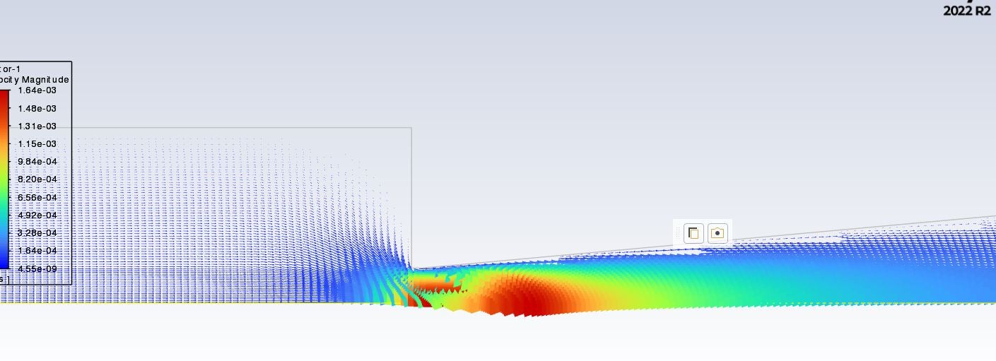

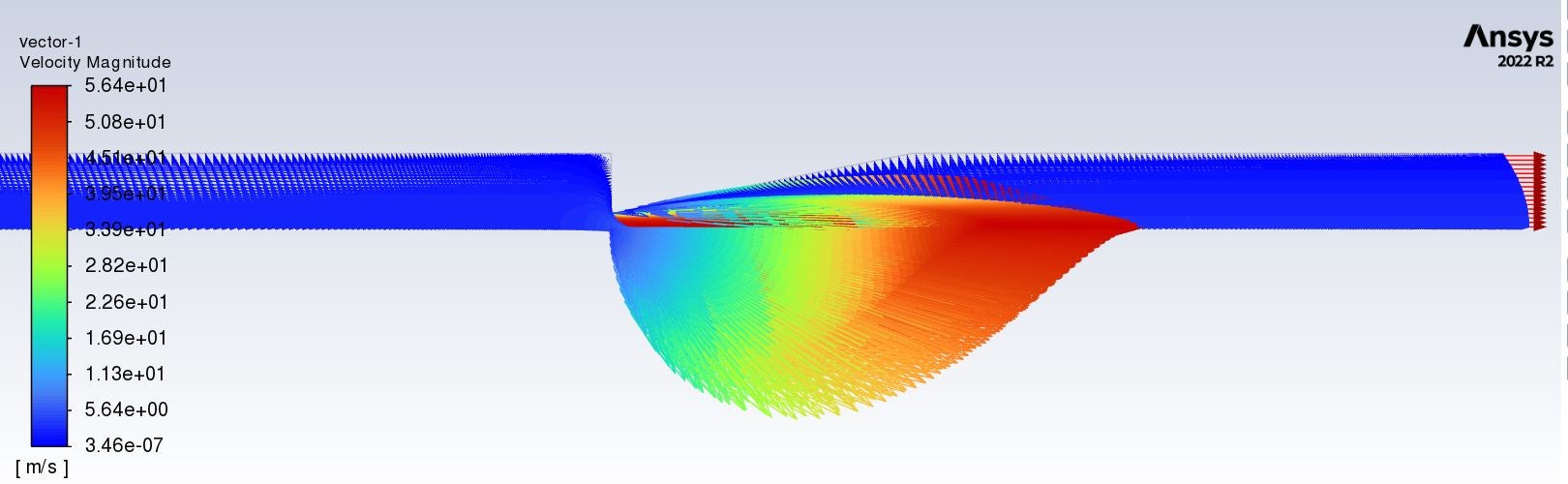

      Here are my velocity field as well as the velocity vectors:
      Can you zoom in on the interesting bit? 80m/s is borderline compressible for ambient air too.
