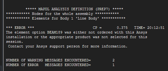

      I am trying to do simple 1D bar problem using ansys student version, But i am not able to solve the problem and it is shows the following error. Please find the attached image for reference.
      Error:
      *** ERROR ***                           CP =       0.375   TIME= 20:12:51
       The element option BEAM189 was either not ordered with this Ansys
       installation or the appropriate product was not selected for this
       session.
        Contact your Ansys support person for more information.

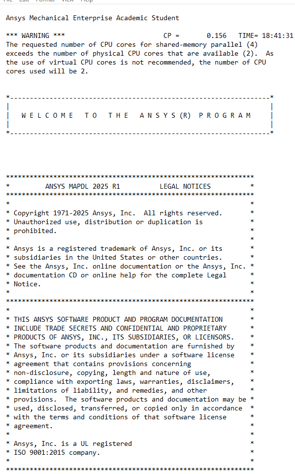

    • ErKo
      Hi
      Go into the solve.out file, which can be seen also in Solution information, and at the very top it should say what licence your are using - post an image of that here.
      Thank you
      Erik
    • kavi.pradhap434
    • ErKo
      Hi
      It seems there is a student licence so perhaps it should work.
