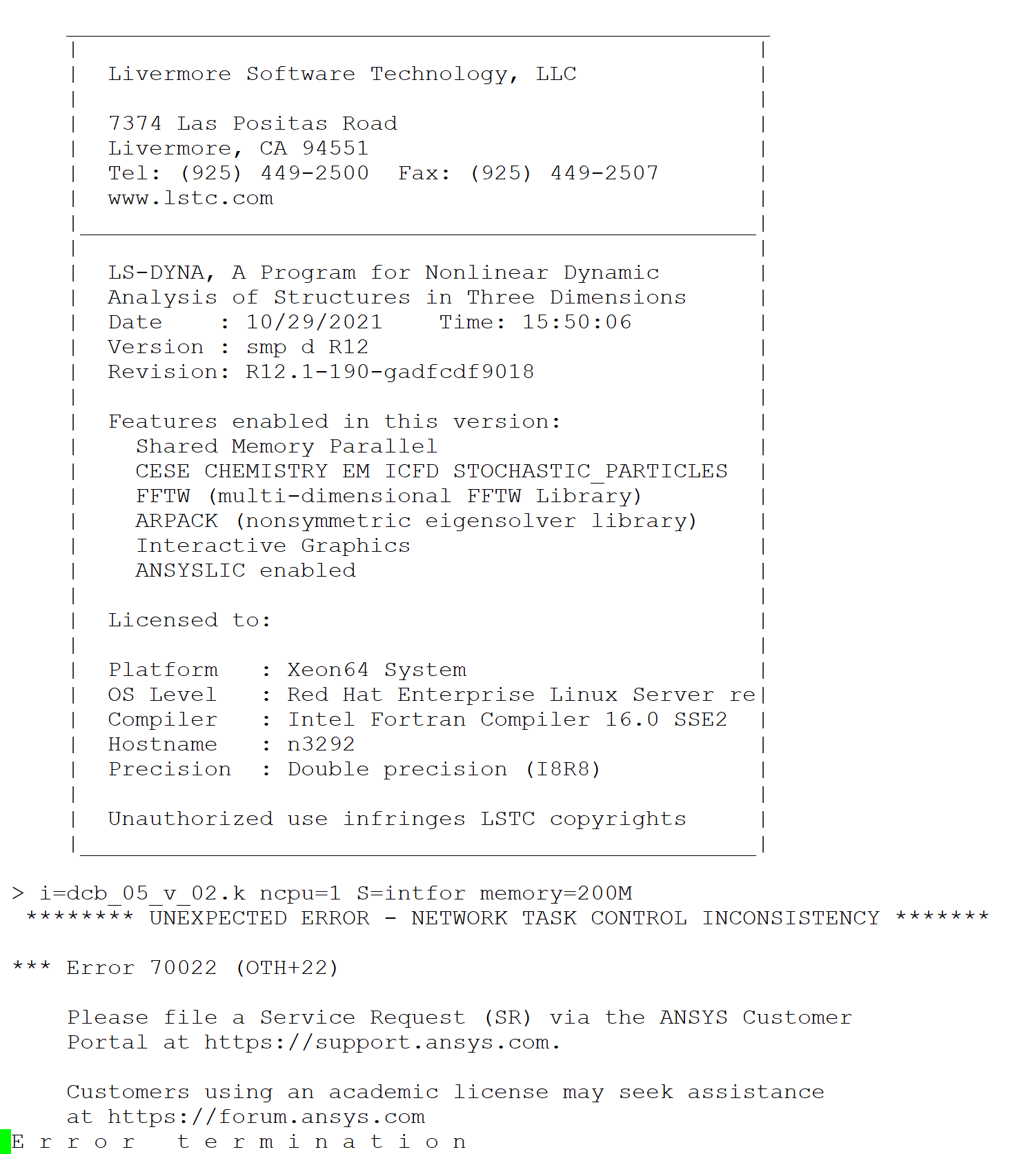

SubscriberHi I am a user of the ANSYS academic license and I get the following error when I call LS-DYNA from ANSYS 2022R1 installation
I use FlexLM license and I checked with the license server administrator to confirm that the license is active and that I am authorized to check out the license. He also confirmed that the server log indicates that licenses were checked out successfully when I tried to run LS-DYNA.
Could someone please help me fix this issue? I have had the exact same problem with 2021R1 version as well.
Thanks Ashith

SubscriberUnfortunately screenshot of the error message was not attached. Please find the text form of the complete error message below

> i=dcb_05_v_02.k ncpu=1 S=intfor memory=200M
******** UNEXPECTED ERROR - NETWORK TASK CONTROL INCONSISTENCY *******
*** Error 70022 (OTH+22)
Please file a Service Request (SR) via the ANSYS Customer
Portal at https://support.ansys.com.
Customers using an academic license may seek assistance
at https://forum.ansys.com
E r r o rt e r m i n a t i o n
May 25, 2022 at 12:08 pm
George Karnos
Ansys EmployeeAre you set up to use ANSYS Licensing or LSTC Licensing?
What licenses do you have on your license server?
May 25, 2022 at 2:17 pm
ashith
SubscriberI use ANSYS Licensing
May 26, 2022 at 12:59 am
ashith
SubscriberWe have updated our license manager to 2022R1 version and I still get the same 'NETWORK TASK CONTROL INCONSISTENCY' error. I would greatly appreciate if you could help fix this issue soon.
May 26, 2022 at 2:25 am
George Karnos
Ansys EmployeeI'll ask again...
May 26, 2022 at 3:04 am
ashith
SubscriberIf you are asking whether we use LSTC or ANSYS license for LSDYNA, we use ANSYS license.
Please let me know if you need any additional information. I can check with our license server manager and provide more details as needed. Thanks.
May 26, 2022 at 12:09 pm
George Karnos
Ansys EmployeeI was wondering about the specific licenses you have on the server. What is in your license file?
Did this work with earlier versions?
Maybe rgenesthas ideas as to what the issue is.
May 26, 2022 at 11:09 pm
ashith
SubscriberBelow is the information I received from our IT guys about the specific licenses on the server
# Products licensed in this file:
# 1. ANSYS Academic Research HPC Workgroup 512: 1 task(s) Lease expiring 13-Jun-2022 Customer # 623184
# 2. ANSYS Academic Multiphysics Campus Solution (125/1250) - Teaching: 1 task(s) Lease expiring 13-Jun-2022 Customer # 623184
# 3. ANSYS Academic Research LS-DYNA HPC (per core): 24 task(s) Lease expiring 13-Jun-2022 Customer # 623184
# 4. ANSYS Academic Research LS-DYNA (25 tasks): 1 task(s) Lease expiring 13-Jun-2022 Customer # 623184
# 5. ANSYS Academic Multiphysics Campus Solution (125/1250) - Research: 1 task(s) Lease expiring 13-Jun-2022 Customer # 623184
# 6. ANSYS Academic Research LS-DYNA HPC (per core): 48 task(s) Lease expiring 13-Jun-2022 Customer # 623184
And to answer the question about the earlier version. I had used 2021R1 version (Only the SMP worked and MPP never did - /forum/discussion/27921/ansys-structures-2021r1-installation-on-centos-8-3-lsdyna-mpp-version-not-working) successfully till the end of March this year and last week it stopped working as well and kept throwing the same 'NETWORK TASK CONTROL INCONSISTENCY' error without any additional information.
