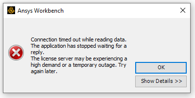

I get the following error message when trying to start Workbench:

Ansys EmployeeHave your IT Department check the License Server Firewall.
Ensure that the following are added to exceptions:
lmgrd.exe
ansyslmd.exe
ansysli_server.exe
On your machine, verify that ansyscl.exe is added to firewall exceptions.
November 22, 2021 at 3:08 pmwcg
SubscriberAwesome - thanks for the response!!! I forwarded this to our license manager, and it's working now!!!

February 8, 2023 at 10:50 pmpo
SubscriberHello,
So, I am currently facing a similar issue. I keep getting the same error message and all the essential tools in the toolbox are missing. I can confirm ansyscl.exe has been added to firewall exceptions. How can I get past this error?
Thank you.
