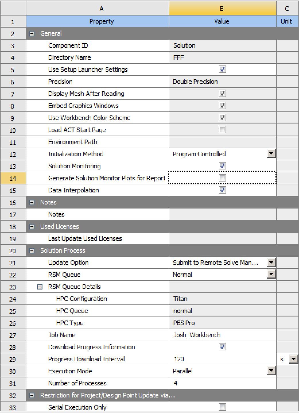

March 30, 2019 at 4:22 pm
swheat

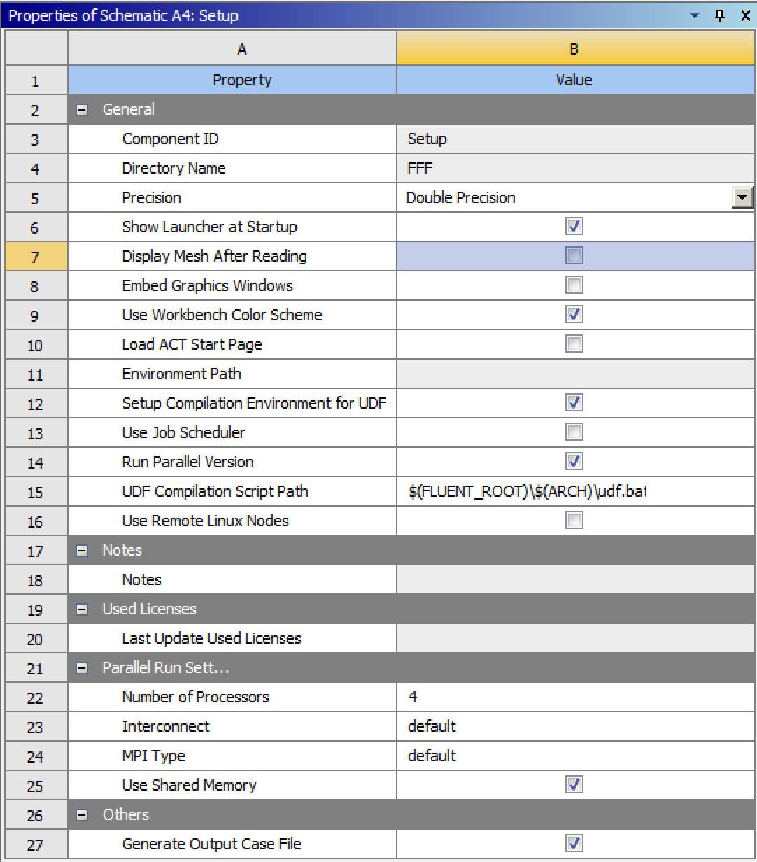

SubscriberI have received the information from the user re the Windows client job submission. Below is the text from his email. I've tried to put the screenshots inline with the text. One thing I have also noted is that the job, while it asks for 4 processors, it is allocating 4 complete nodes. The job is set up to use shared memory if it can, but the jobs are distributed to four distributed memory nodes, each with 40 cores, even though the job only needs 4 cores.
Yes, here is a screenshot of the settings for the Solution. There is one setting not shown in row 34 labeled "Specify Number of Processes Restriction”, and this box is unchecked.
There might be something to this error in the setup part of the process, though. I attached a PDF of the tutorial I am semi-following to get my results. If you look at step 13, there are some instructions to show contour plots. I’m not sure if this is where the error is coming from or not.
Also, here is the settings pane for the Setup. Rows 7 and 8 seem to be of interest, especially considering they appear in the solution settings as well. I disabled them in this screenshot and attempted to run the simulation again, but the same display error shows up still. Any thoughts?

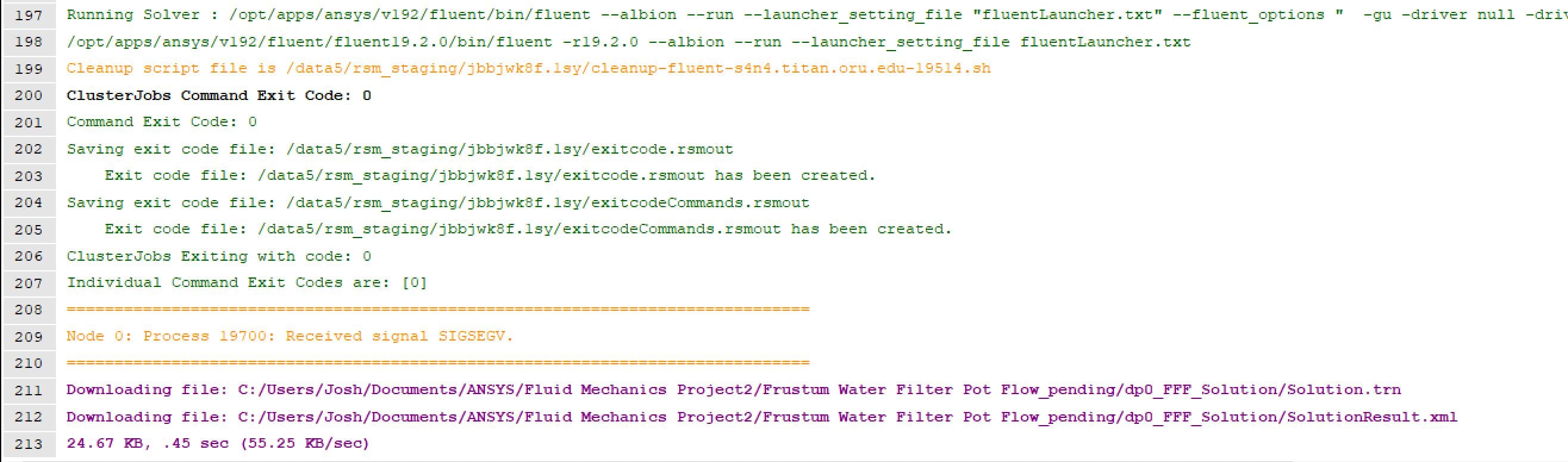

April 6, 2019 at 4:44 pm
swheat
SubscriberAdditional observation ... as I just don't know how many of these issues are connected to this thread, I had this observation. We changed one thing on the client side, we chose sequential instead of parallel. Here, it appeared to allocate one node on the cluster with 4 processes. Exactly what we wanted. And, the reports back to the client indicate a return code of 0, but then there was a SIGSEGV. Please see this picture. It didn't appear that the output of the job successfully made it back to the client, but we don't know that for sure, as each output line seems to indicate successful transfers of something. Perhaps we don't know how to use the returned data.
The question is: Is the SIGSEGV expected behavior? If not, then what should we look for?
The follow up question is: Did the job really run to a successful end and were the results communicated back to the client?

April 8, 2019 at 10:37 pm
JakeC
Ansys EmployeeHi Stephen,
Regarding: What would cause it to not find a "valid cluster type"?
I'm not sure where it might be looking for that, but since you are running SLURM and that is not technically a valid cluster type for the Fluids solver, that isn't too surprising. It is most likely looking for environment variables in connection with PBS that are not there, but I can't say for sure.
Can you post the whole log where you see that error?
Regarding the Crash:
Chances are very good that did not run correctly.
Please look in the Solution.trn file, that may provide some clues.
Chances are that you are missing some required libraries on the compute nodes, but the .trn file should show more.
It looks like the two files were copied back ok to the client, so the file transfer is fine, and for fluent in this state, those two files are the only two files to be expected to be copied back.
So I think the RSM parts are working ok.
Are you able to run a fluent batch directly on a compute node bypassing the scheduler?
The command would look something this this:
/ansys_inc/v192/fluent/bin/fluent 3d -g -t4 -i TestJournal.jou
You could also try something like the following:
In the RSM Configuration Utility on the client (windows) machine, in the "File Transfer" section at the bottom, check the "Keep files in staging directory"
Then submit a job.
Wait for it to fail.
Go into the linux side, and CD to that staging directory from one of the compute nodes.
Then run the solver command manually on the linux terminal that is logged into the compute node and where pwd is in the staging directory.
In your case in the screenshot above it would be lines 197 and 198.
See if you get more output that way.

April 11, 2019 at 9:40 pm
swheat
SubscriberJake,
We have two new observations. Getting rid of the spaces in names didn't seem to make any difference.
The sequential run still fails with SIGSEGV. Attached is my manual running of it as suggested above. Note that we do 2ddp, not 3d. I can't figure out how to attach a file, so the text of the trn is given below.
Next, we found that if he ran one iteration on the Windows client, and then told it to run the rest of the iterations on the cluster (still just sequential, just using a single core), we found that the job ran to completion, whether via Client RSM. No SIGSEGV issues when we "continue" a run.
I tried to run that job manually, but it appears that the run is already updated, and after loading and using a bunch of cores, it just exits without doing any work.
Quick question, is there a way to tell the system to run sequential, but to use more than one core?
Here are the few lines from the end of an experiment of me running a job that should be successful (one iteration run on the client, a few run on the server node, and then cancelled). It gives the same result, doesn't seem to do anything after it's all loaded.

porous_zone
mesh interfaces,
parallel,
Done.
#f
> (wb-apply-cx-state-and-surfaces "((((gui-processing? #t) (cell-function-defs ((0 ((name _rdabsolute-volume-flow-rate) (display "volume-flow-rate
* ( - 1)") (syntax-tree ("*" "volume-flow-rate " -1)) (code (field-* (cx-report-eval "volume-flow-rate") -1)))))) (graphics/scenes (((name . "contour-2") (graphics-object-names "contour-2") (camera-setting (position 0.1145503595471382 0.01046664360910654 0.6500812768936157) (target 0.1145503595471382 0.01046664360910654 0.) (up-vector 0. 1. 0.) (target-width . 0.2600325047969818) (target-height . 0.2600325047969818) (projection-type . "perspective"))) ((name . "contour-1") (graphics-object-names "contour-1") (camera-setting (position 0.1238249987363815 0.07633239775896072 0.6500812768936157) (target 0.1238249987363815 0.07633239775896072 0.) (up-vector 0. 1. 0.) (target-width . 0.2600325047969818) (target-height . 0.2600325047969818) (projection-type . "perspective"))))) (surfaces/groups ((volume-fraction-17 (17)) (interior-porous_zone (
) (interior-inlet_zone (7)) (outlet-porous_zone (6)) (outlet-inlet_zone (5)) (outlet-filter (4)) (interface1 (3)) (interface2 (2)) (axis-inlet_zone (0)) (axis-porous_zone (1)) (swirl-velocity (9)) (interface2-non-overlapping (10)) (interface1-non-overlapping (11)) (interface:01-interior-1-1 (12)) (porous_zone (13)) (inlet_zone (14)) (volume-fraction-15 (15)) (frustum-free-surface-time-0s (16)))) (cx-virtual-id-list (4198 4199 4201 4202 4203 4204 4206 4207 4208 4210 4211 4212 4213 4214 4262 4263 4264 4265)) (cx-surface-id-map ((17 4265) (16 4264) (15 4263) (9 4262) (14 4214) (13 4213) (12 4212) (11 4211) (10 4210) (1 4208) (0 4207) (4 4206) (8 4204) (7 4203) (6 4202) (5 4201) (3 4199) (2 4198))) (cx-surface-type ((9 0) (2 0) (3 0) (5 0) (6 0) (7 0) (8 0) (4 0) (0 0) (1 0) (10 0) (11 0) (12 0) (13 0) (14 0))) (cx-surface-def-list ((4265 () (iso-surface 4265 () "air-vof" '(0.)) #f) (4264 (4214) (iso-surface 4264 (4214) "water-vof" '(0.5)) #f) (4263 () (iso-surface 4263 () "air-vof" '(0.)) #f) (4262 () (point-surface 4262 global '((0.098425 0.04 0.))) #f) (4214 () (zone-surface 4214 4) #f) (4213 () (zone-surface 4213 3) #f) (4212 () (zone-surface 4212 6) #f) (4211 () (zone-surface 4211 15) #f) (4210 () (zone-surface 4210 14) #f) (4208 () (zone-surface 4208 12) #f) (4207 () (zone-surface 4207 13) #f) (4206 () (zone-surface 4206 9) #f) (4204 () (zone-surface 4204 1) #f) (4203 () (zone-surface 4203 2) #f) (4202 () (zone-surface 4202 7) #f) (4201 () (zone-surface 4201
#f) (4199 () (zone-surface 4199 10) #f) (4198 () (zone-surface 4198 11) #f))) (cx-surface-list #((0 ((zid 13) (type zone-surf) (name axis-inlet_zone) (status susp) (facet-info (0 0 0 0)))) (1 ((zid 12) (type zone-surf) (name axis-porous_zone) (status susp) (facet-info (0 0 0 0)))) (2 ((zid 11) (type zone-surf) (name interface2) (status susp) (facet-info (0 0 0 0)))) (3 ((zid 10) (type zone-surf) (name interface1) (status susp) (facet-info (0 0 0 0)))) (4 ((zid 9) (type zone-surf) (name outlet-filter) (status susp) (facet-info (0 0 0 0)))) (5 ((zid
(type zone-surf) (name outlet-inlet_zone) (status susp) (facet-info (0 0 0 0)))) (6 ((zid 7) (type zone-surf) (name outlet-porous_zone) (status susp) (facet-info (0 0 0 0)))) (7 ((zid 2) (type zone-surf) (name interior-inlet_zone) (status susp) (facet-info (0 0 0 0)))) (8 ((zid 1) (type zone-surf) (name interior-porous_zone) (status susp) (facet-info (0 0 0 0)))) (9 ((type point-surf) (name swirl-velocity) (status susp) (facet-info (0 0 0 0)))) (10 ((zid 14) (type zone-surf) (name interface2-non-overlapping) (status susp) (facet-info (0 0 0 0)))) (11 ((zid 15) (type zone-surf) (name interface1-non-overlapping) (status susp) (facet-info (0 0 0 0)))) (12 ((zid 6) (type zone-surf) (name interface:01-interior-1-1) (status susp) (facet-info (0 0 0 0)))) (13 ((zid 3) (type zone-surf) (name porous_zone) (status active) (facet-info (0 0 6058 3266)))) (14 ((zid 4) (type zone-surf) (name inlet_zone) (status active) (facet-info (0 0 23254 11856)))) (15 ((ref-thread 3) (zones ()) (quantity "air-vof") (units *null*) (type iso-surf) (name volume-fraction-15) (status susp) (facet-info (0 0 0 0)))) (16 ((ref-thread 3) (zones (4)) (quantity "water-vof") (units *null*) (type iso-surf) (name frustum-free-surface-time-0s) (status susp) (facet-info (0 0 0 0)))) (17 ((ref-thread 3) (zones ()) (quantity "air-vof") (units *null*) (type iso-surf) (name volume-fraction-17) (status susp) (facet-info (0 0 0 0)))) #f #f #f #f #f #f #f #f #f #f #f #f #f #f #f #f #f #f #f #f #f #f #f #f #f #f #f #f #f #f #f #f #f #f #f #f #f #f #f #f #f #f #f #f #f #f #f #f #f #f #f #f #f #f #f #f #f #f #f #f #f #f #f #f #f #f #f #f #f #f #f #f #f #f #f #f #f #f #f #f #f #f #f #f #f #f #f #f #f #f #f #f #f #f #f #f #f #f #f #f #f #f #f #f #f #f #f #f #f #f)) (mirror-zones (13 12)) (view-list ((front ((0.123825 0.07633240067796 0.6500812499999999) (0.123825 0.07633240067796 0.) (0. 1. 0.) 0.2600325 0.2600325 "perspective") #(1 0 0 0 0 1 0 0 0 0 1 0 0 0 0 1)) (back ((0.123825 0.07633240067796 -0.6500812499999999) (0.123825 0.07633240067796 0.) (0. 1. 0.) 0.2600325 0.2600325 "perspective") #(1 0 0 0 0 1 0 0 0 0 1 0 0 0 0 1)))) (lights/headlight/on? #f) (render/surfaces (6 5 3 2)) (render/grid/surfaces (6 5 3 2)) (filled-grid? #f) (xy/bottom -1) (scale/right -0.7) (cx-case-version (19 2 0)) (cx-case-read-event-called-already #t))) (3 porous_zone) (4 inlet_zone) (6 interface:01-interior-1-1) (15 interface1-non-overlapping) (14 interface2-non-overlapping) (12 axis-porous_zone) (13 axis-inlet_zone) (9 outlet-filter) (1 interior-porous_zone) (2 interior-inlet_zone) (7 outlet-porous_zone) (8 outlet-inlet_zone) (10 interface1) (11 interface2))" )
Setting Post Processing and Surfaces information ... Done.
saved-mesh-id
> (wb-load-post-setup-info '((original-mesh . #t)(run-number . 2)(check-grid . #t)(sol-needs-refresh . #f)))
#f
> (wb-update-em-loss-data '#f"
"#f)
#f
> (wb-init-flow)
Initialization based on settings...
Initialize using the hybrid initialization method.
Checking case topology...
-This case has only outlets
-Case will be initialized with constant parameters
Hybrid initialization is done.
Node 11: Process 34481: Received signal SIGSEGV.
Node 12: Process 34482: Received signal SIGSEGV.
Node 13: Process 34483: Received signal SIGSEGV.
Node 5: Process 34475: Received signal SIGSEGV.
Node 8: Process 34478: Received signal SIGSEGV.
Node 3: Process 34473: Received signal SIGSEGV.
Node 15: Process 34485: Received signal SIGSEGV.
Node 2: Process 34472: Received signal SIGSEGV.
Node 0: Process 34470: Received signal SIGSEGV.
Node 10: Process 34480: Received signal SIGSEGV.
Node 6: Process 34476: Received signal SIGSEGV.
Node 9: Process 34479: Received signal SIGSEGV.
Node 7: Process 34477: Received signal SIGSEGV.
Node 14: Process 34484: Received signal SIGSEGV.
Node 4: Process 34474: Received signal SIGSEGV.
Node 1: Process 34471: Received signal SIGSEGV.
===============Message from the Cortex Process================================
Fatal error in one of the compute processes.
