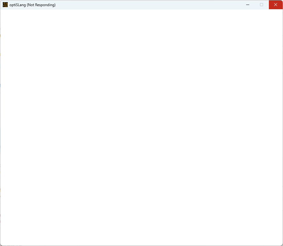

      Hello everyone,
      I normally use Ansys Workbench R1 2023 and Optislang R1 2023 to run some optimisation studies.

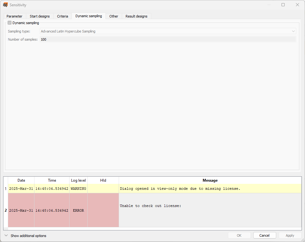

      Last week, I launched a sensitivity study in Optislang that included running the Workbench in batch mode (I have done this before and never had problems). When I checked the simulations the next morning optislang had closed and trying to reopen the project didn't work. I tried to open other project but with no success, even when trying to open a blank project there was just a blank window that never loads:
      I uninstalled the entire Ansys package and reinstalled it again. This time I installed the R1 2024 version and it seemed to be working. Sometimes it won't load the projects and sometimes it will, so I thought it wasn't too bad. However then I realised that there are issues with the license and I can only open the projects in view-only mode:
      I don't know why the license is missing and there are no explanations of that error.

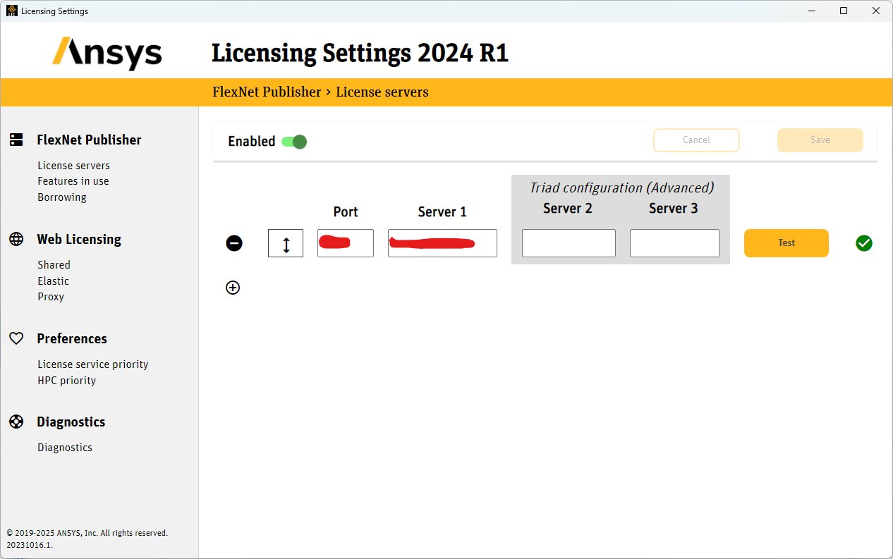

      I checked the license manager and seems fine:
      I then reinstall the R1 2023 version and surprisingly found the same error with the license.
      I have contacted my department to check that everything is fine with the license but I am pretty sure it is (I can use Fluent and Workbench without problems) so I am really wondering what's wrong with optislang.
      Does anybody know how to solve this problem? I have already uninstalled and reinstalled everything twice (both for the R1 2024 and R1 2023) and I really don't know what to do.
      Thank you very much in advance.
    • Rajeshwari Jadhav
      Click on "Feature in Use" tab under Ansys Licensing Settings and let me know if all increments are visible over there.
      • cibi
        Thank you for your reply! I manage to have the license working by deleting the temp files in AppData but I still have problems with opening optislang that sometimes get stuck on a blank window

          Try to update the graphics driver, does it crash once it is stucked?
        • cibi
          I updated the graphic driver but it still doesn't work. Once it is stucked it goes on Not Responding for a while and then I usually force the window to close

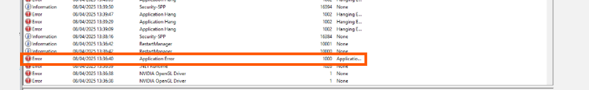

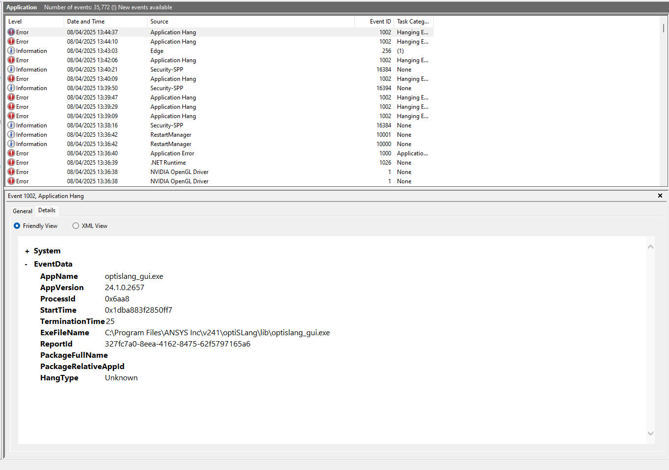

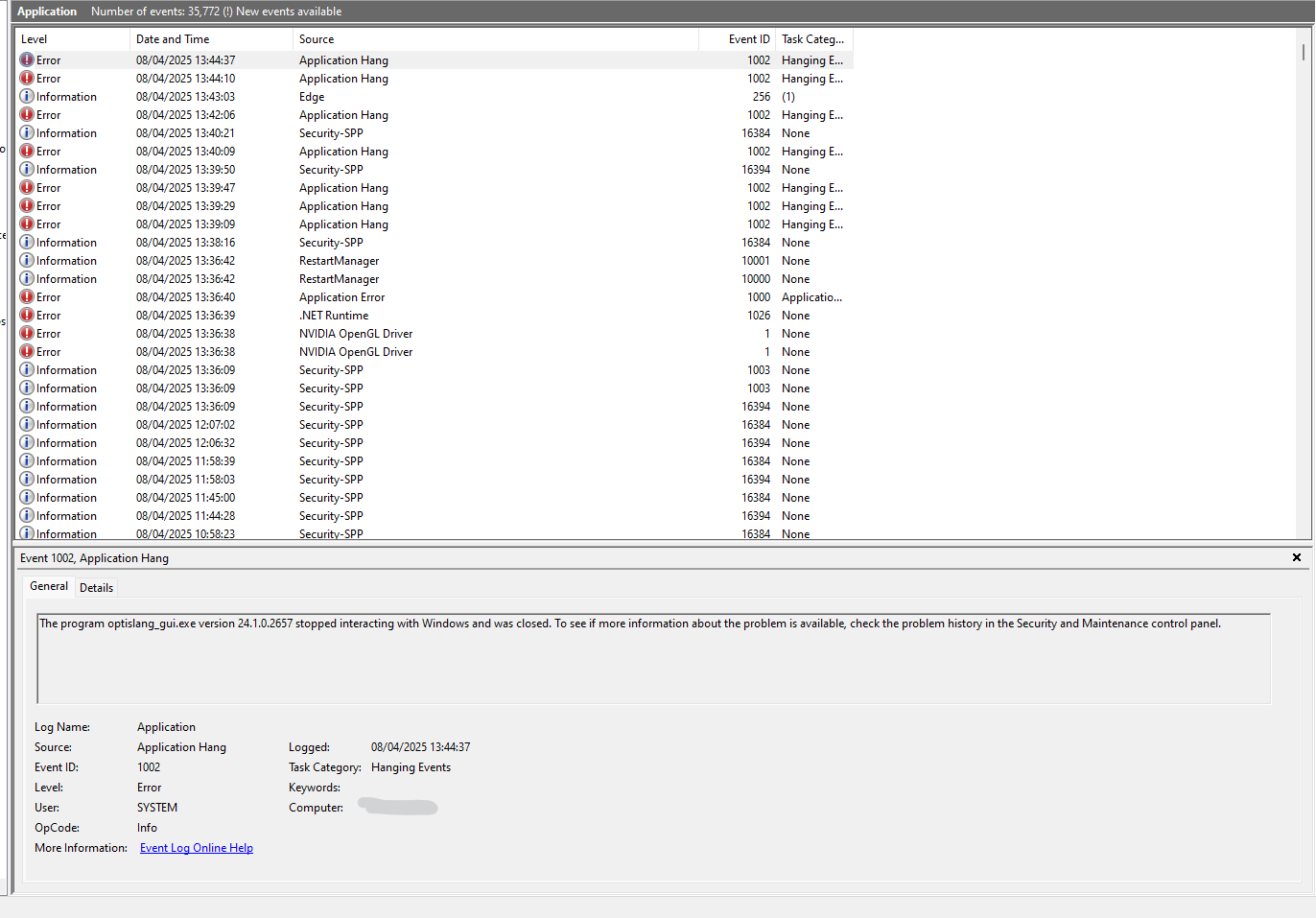

      Launch Event Viewer> Windows logs> Click on Application and check if any error is shown over there.
    • cibi
      I can see the errors:

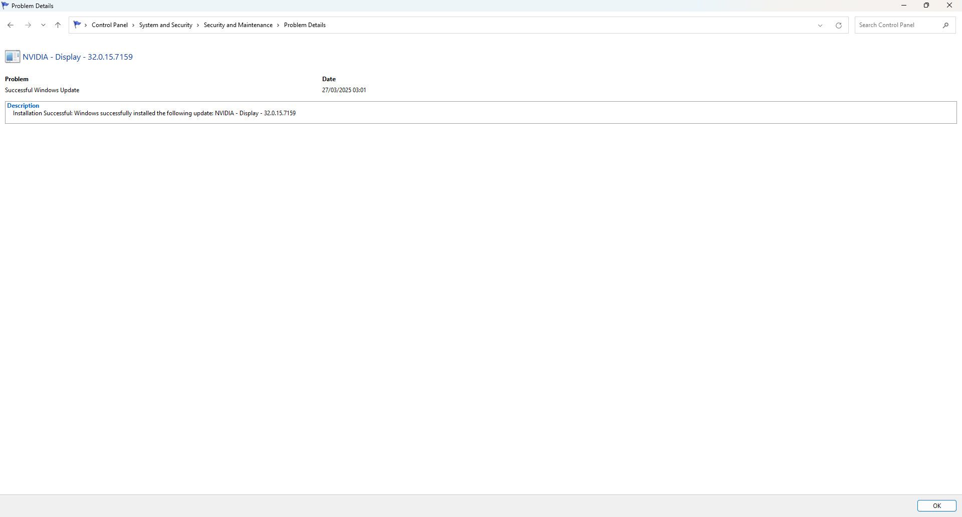

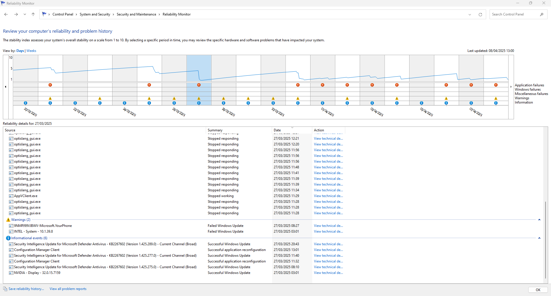

      I went also to check for more details on the control panel but there isn't much:

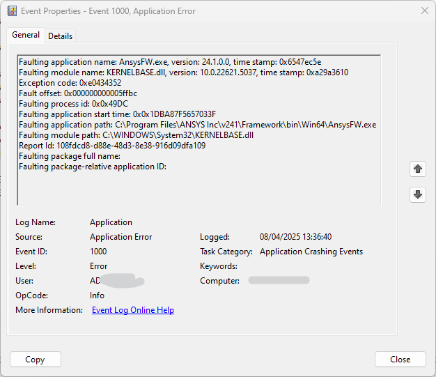

    • Rajeshwari Jadhav

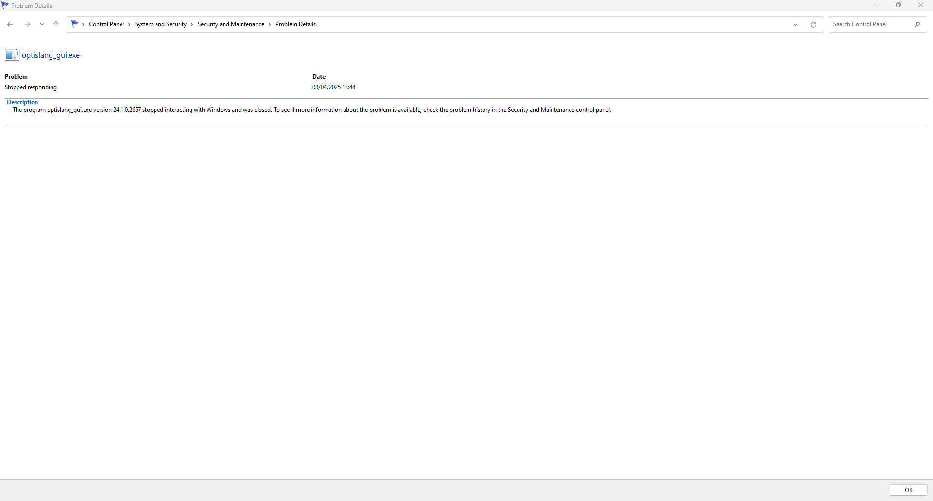

      Double-click on Application error and send the screenshot of it.
    • cibi
      I realised that the night optislang stopped working properly my computer did some updates, here is the screenshot in case it could help:
    • Rajeshwari Jadhav
      Is this error version specific?
      Can you manually register the DLLs listed below:
      Check the PATH System Variable to make sure that C:\WINDOWS\system32;C:\WINDOWS; C:\WINDOWS\System32\Wbem;… entries are in front of everything else.
      Like:  PATH=C:\WINDOWS\system32;C:\WINDOWS;C:\WINDOWS\System32\Wbem;…all other entries...

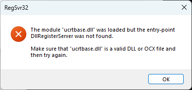

      Manually register the DLLs listed below by starting a Command Prompt (DOS) "as administrator" and changing to the directory c:\windows\system32, then typing:
      regsvr32.exe ole32.dll
      regsvr32.exe atl.dll
      regsvr32.exe oleaut32.dll
      regsvr32.exe scrrun.dll
      regsvr32.exe jscript.dll
      regsvr32.exe vbscript.dll
      regsvr32 ucrtbase.dll
      regsvr32 KERNELBASE.dll
      Let me know if above dll were registered successfully.
    • cibi
      It's not version specific because it happens also with the V23.
      I registred all the DLL successfully except for the one in bold characters
