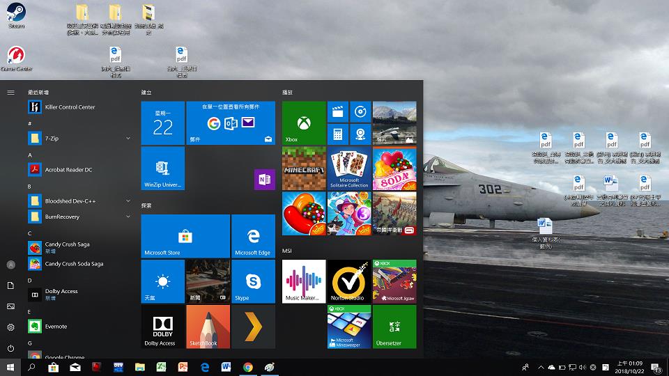

      1. I can't find the file of ANSYS and Workbench in the window start menu, so how should I open the product ?

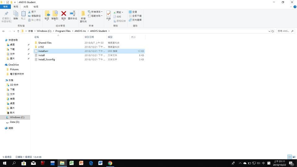

      2. I find there is a "install.err" file under C:Program FilesANSYS IncANSYS Student,
          but the installer(where I click the setup button) said that it was install completed.
      What's going on? I have no idea....  I spend almost 5 hours handling this problem, and I need to complete my homework next week, OMG !!

      Click the Search icon next to the Windows button in the lower left.
      Type Workbench
      What does it find?
      It should find Workbench 19.2
                              Desktop app
