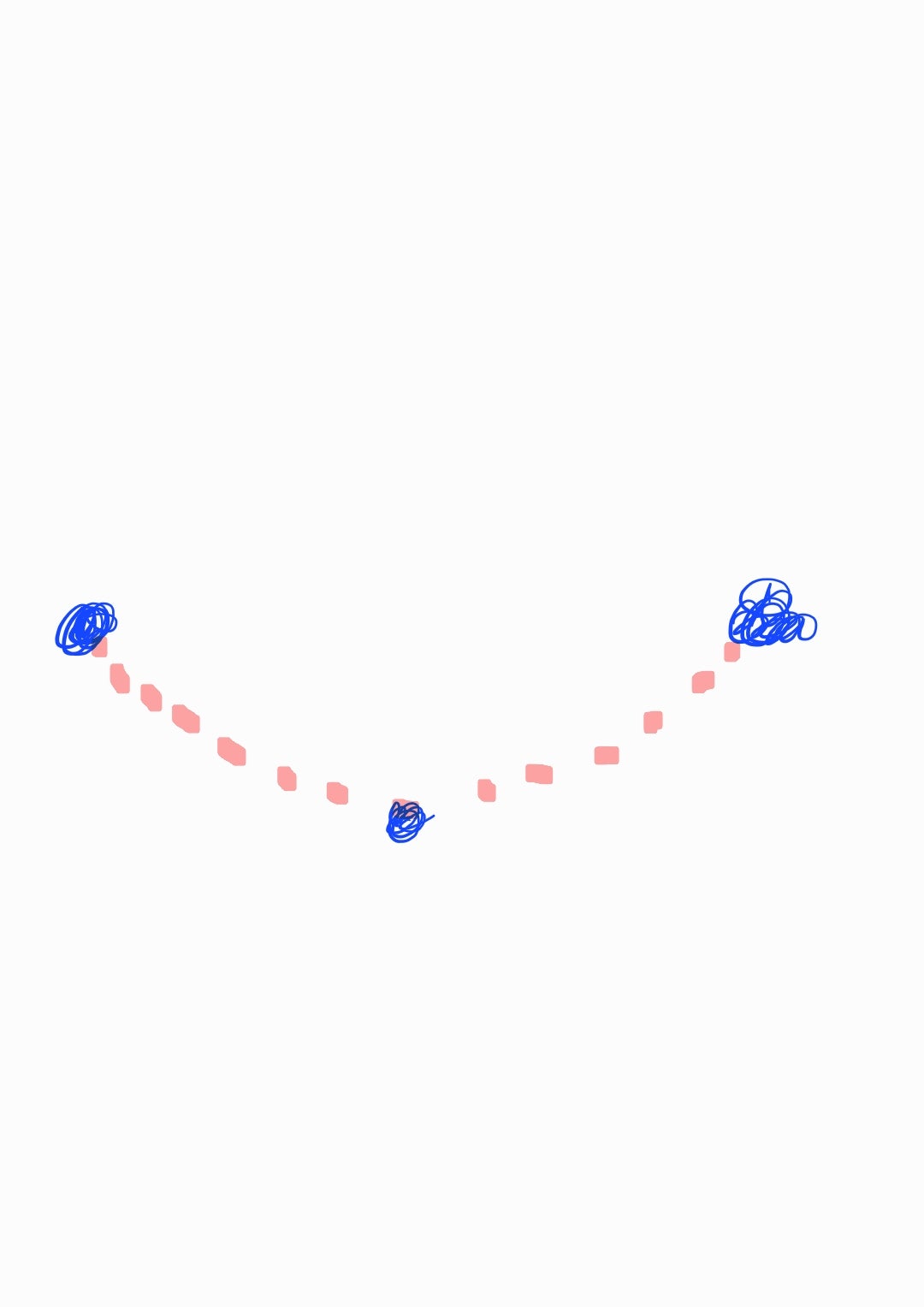

which type of Spline, ICEM CFD are using to create a curve from points? e.g., for three points
Linear Spline
Quadratic Spline
Cubic Spline
B-Spline (Basis Spline)
NURBS (Non-Uniform Rational B-Spline)
Bezier Spline
Catmull-Rom Spline
Hermite Spline
Akima Spline
thanks

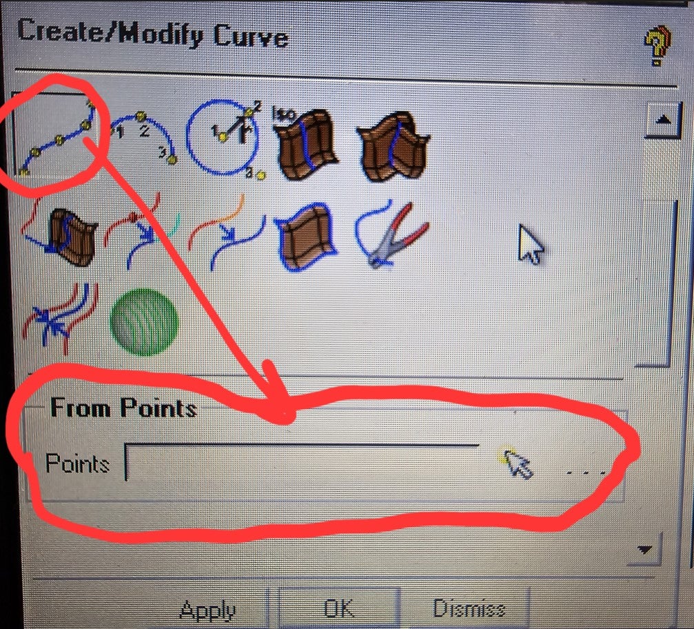

What do you mean it depends? would you please clarify it generally speaking as I will have different case studies later
also, in my current case, I have three points using the command (From Points (key=Ctrl-c)) and started to select them from left to right.

Ansys EmployeeWhat I mean to say is, by choosing different options, the curves created will be different. Because, they use different algorithm to create the curves. It would be good if you can share the model or share the screenshot of what you are creating a model of.

Ansys EmployeeYes, ICEM do not have the options mentioned by you. You can just try the "Arc" option if the joining the points is the only main concern.

Ansys EmployeeFrom both "From Points" and "Arc", ICEM uses B-spline to generate the curve. For more information, please the Ansys guide link:
