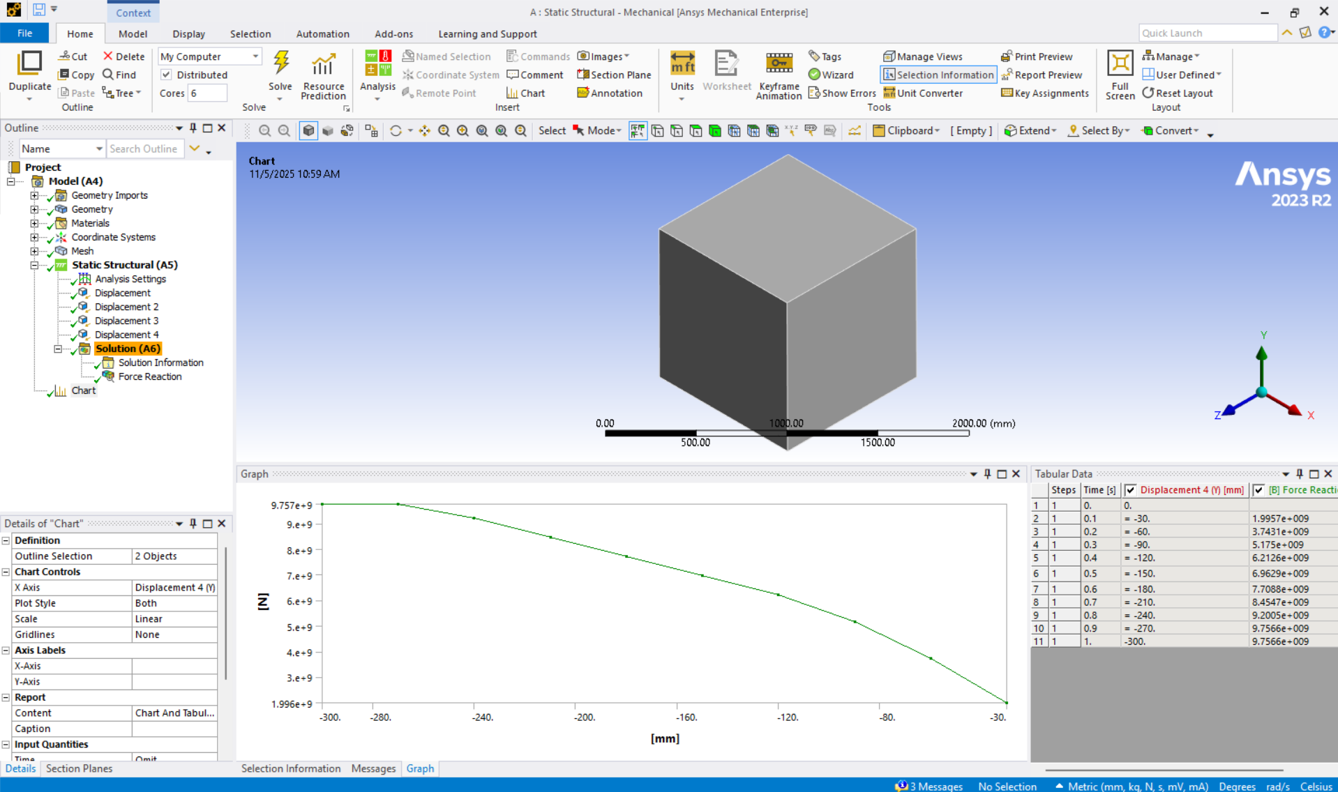

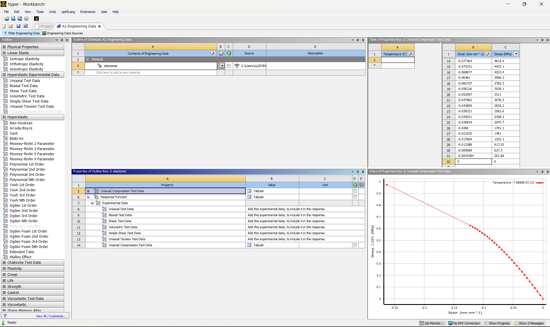

I have already imported my uniaxial compression data and used the Response Function option to define the material. I tested the model using a single-element simulation, and the results under compression looked reasonable.

Do I need to provide additional test data (e.g., tension or shear) in the Response Function to ensure accurate behavior in multiaxial conditions?
How should I interpret the phrase “this potential is also valid for multiaxial conditions” from the paper — does it mean the same uniaxial compression data can be used for other deformation modes under an isotropic assumption?
I also noticed that the Response Function in ANSYS does not include an incompressibility parameter (D), which is typically present in other hyperelastic models. Is this parameter implicitly handled in the Response Function approach, or does it need to be defined elsewhere?

1.A solid understanding of your material is crucial, especially for hyperelastic materials. The more experimental data sets you can provide, the more accurately the FEA results will reflect real-world behavior.
Even with limited experimental data, you can still use hyperelastic models. Curve fitting will generate a complete response curve across all deformation conditions, even for regions where no direct data were provided.
However, this is not the case for the response function option. While it offers easier setup, it only applies to stress states within the range of your available data.
Therefore, if your data are limited, I recommend using a different hyperelastic model (not response function).
2.This should be treated as an assumption. The more complex the deformation state of your model (depending on loads and geometry), the more likely this assumption may not hold. Ultimately, this requires engineering judgment rather than a software-based decision.
3.By default, the material is assumed to be incompressible (when no experimental volumetric data are provided). Compressibility can be introduced by including experimental volumetric data.
