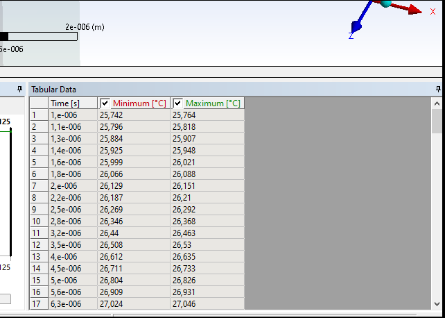

      This might seem silly, but what is the way to turn on the average values in the results table? In one computer i see the Max. Min. And the Average values of temperature but in another I see only min and Max.
      There must be a setting somewhere to turn this in, right? On my old installation i never paid attention to it because it was a very basic thing but on a new installation i seem to have this difference. Both installations are 2019R3.

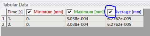

      Or are the Average values in the results plot not visible to you? If so, you may easily visualize that by checking the box next to "Average"

        I do not see the average column itself.
        I get an error when adding an image so I cannot show it to you but I only see the maximum amd minimum columns.
        There must be a setting somewhere to turn this on, i guess! However, i cannot seem to find it.
        Amit
    • amit.pandey
      Attached is the screen image to clarify..

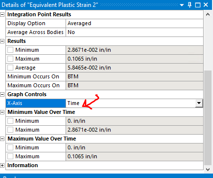

      i get same issue as yours.. you can go to the graphic control and select Time instead of S
