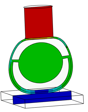

      In mechanical, I am showing the deformation on a constraction surface and turned on the wirefirm on display. However, it not only show the edge on the constraction surface but also show the edge out of the plane for the whole body.
      How to only display the edge on the constraceion surface?
      Like this:

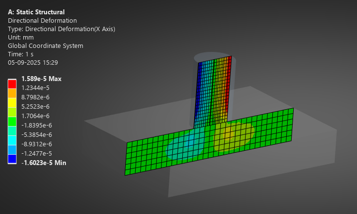

      You can turn off the wireframe view option and try to see if the edges are showing. At my end it is working fine, as shown in image below:
      Sourabh

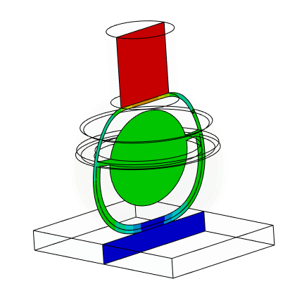

        However, I want to only show the deformed edge on this construction surface. This is my setting:
        on Display tag
        on Result tag
        Then I got this
        or Like your model
        Looking forward your reply.
