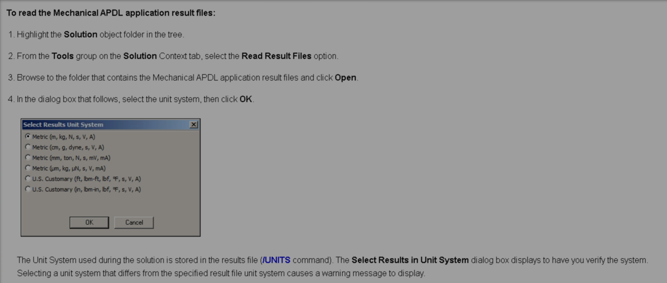

      I have tried to progress based on the following section from the manual but i am not sure if this approach is correct. In any event i have not been successful and mechanical has issued warning and error messages, i will detail the process below.
      In the first instance i do not know which of the almost 40 number output files i should be using as the read results file.
      manual extract from : Writing and Reading the Mechanical APDL Application Files

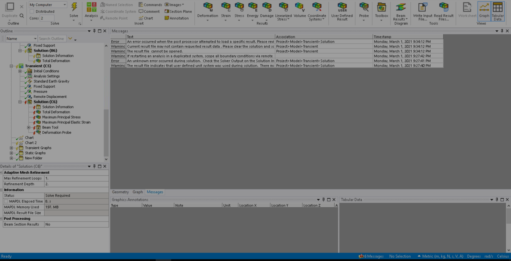

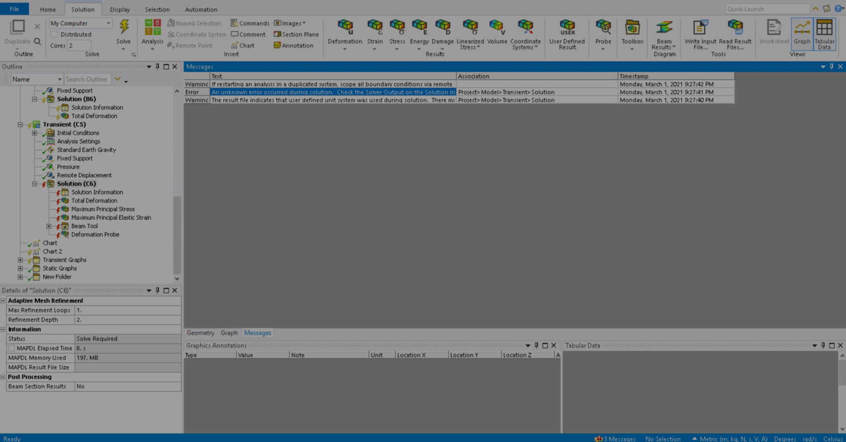

      The 2 warnings and the error which occur when i use the read results file in the solution context tab are shown below, please not i tried numberous output files
      I also tried to Evaluate all results and a number of other warnings and errors were issued as below.
      Any assistance would be great, i imagine i need to identify what file the results are in and how to insert it into mechanical!!!

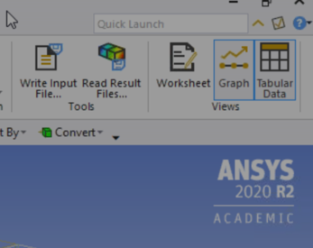

      Array Hi. It looks like you had a slight issue with the batch script. The file 'Model_Replicate_Luo_25.wbpj' is not an MAPDL input file. It is the WorkBench Project database - really an xml file of the systems and their folders/files of the WB project. The 'out' files listed are MAPDL output files, not result files. Output files hold an echoing of what the MAPDL job progress. The result files have the extension rst for structural analyses.
      From WB Mechanical select the Solution object, then the 'Write Input File' in the upper right. This file will be the input file used in your batch job script. Once completed use the 'Read Result File' to point to the file.rst that will exist when the batch job completes.

      I am still having trouble opening the solution file with a number of errors appearing in Mechanical, and the status indicates a 'Solve Required' shown below. The .rst file is 1.4GB in size, so i presume i have selected the correct one and the analysis data has issued 5 warnings but it seems to have fully solved, in bottom snippet. Have you any idea why i cannot display the solution?

      Array First be sure to select the file.rst to read in and not any of those with a number appended after the jobname file i.e. not file0.rst, file1.rst etc.
      Next check the Time on the result objects. It's possible that one or more are set to a Time that was not actually solved for. For example say the model has one load step and its end time is 1. A result object trying to read in data at time 2 will fail, and fail the rest of the result file read.

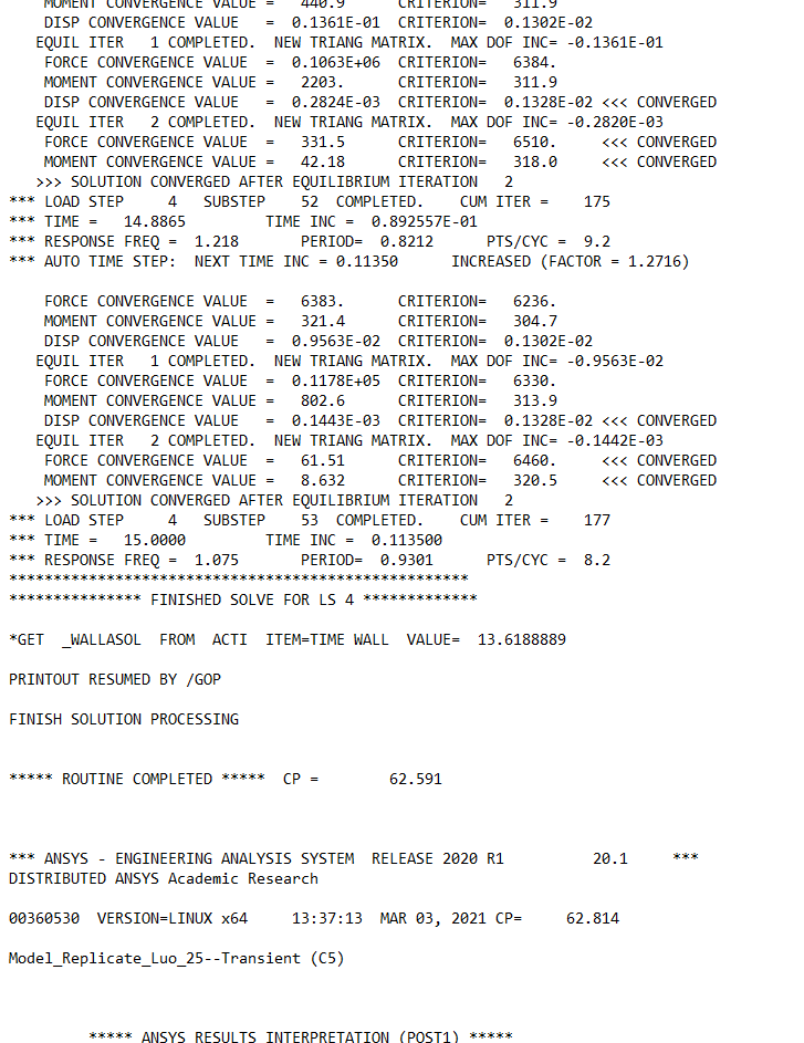

      I don't fully understand the 'check the Time on the results objects', but what i did check was that the solution has solved at the end of the last load step no.4, this maybe the same thing.
      As you can see below the analysis lasts 15 seconds and the second snippet below shows that the solution converged at time=15.0000 thus it finished the solve for LS 4.

      Regarding the solution file set with numbers appended to the names: distributed parallel solving splits the FEM into N portions when run on N cpu cores. Then N solve processes are started, each solving one of the N portions of the model. Each process is creating files so the files are differentiated by appending a number to the file name. The core numbers start at zero, so the 'first' process is on core 0 and creates file0.rst, file0.out etc. At the end of the solution the N rst files are combined into one large file.rst. Which Mechanical reads.
