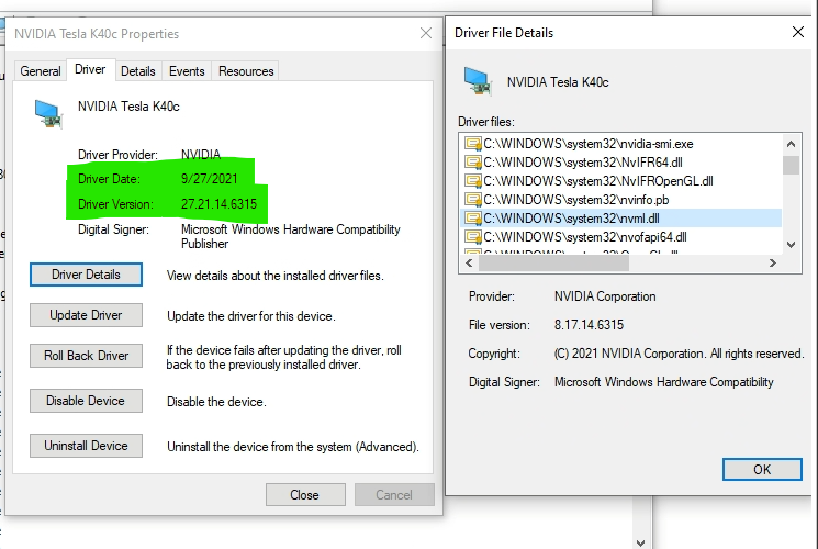

      The driver has been updated to the latest version, and the PC was restarted after the latest driver was installed. I can see that nvml.dll is under both C:\Windows\System32 and C:\Program Files\NVIDIA Corporation\NVSMI directories. Please see the attached pictures.
      In fact, I can even find nvml.dll under Driver Detail in the Device Manager. Please see the attached picture below.

      We have gone through the screesnhot and looks like still the drivers showing the last updated date is back in 2021.
      Looks like it is not updated yet on 2023. Can you go to Nvidia site or react out your IT team to upgrade on latest?
      Please downalod the drivers from Nvidia site for Tesla K40 GPU.
      Thank you.

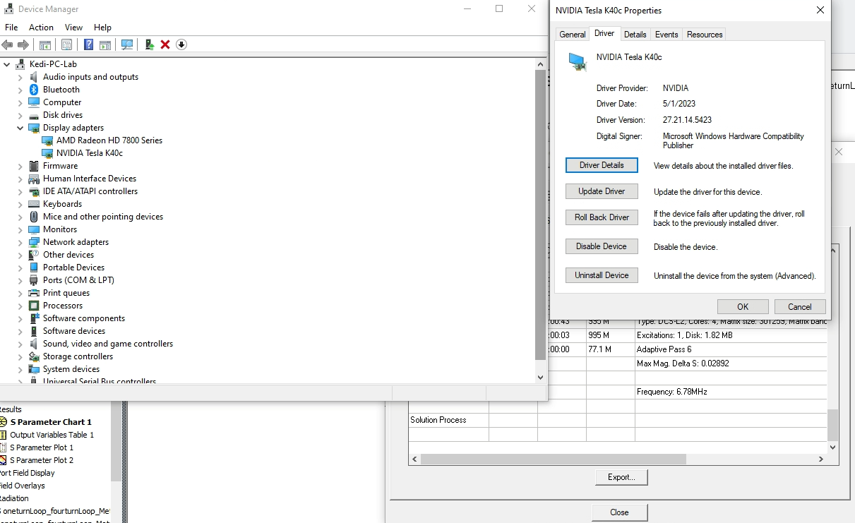

    • kedi
      Hello Sharad
      I have the latest Tesla K40c driver on my PC now and no longer receive the same warning. Please refer to the attached picture below.

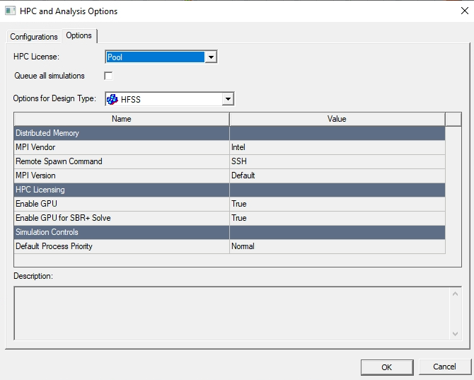

      Is there any way in Ansys to check whether I am taking advantage of the GPU accelerator? In the setting I can see that the GPU is enabled, but I was not sure if the GPU is actually helping during simulation.
    • spankore
      Hello Kedi,
      Thank you for your email. Looks like it is working fine now after upgrading the drivers ob client machine.
      Can you please check if you can acess the Ansys electronics Help document : you can check the GPU accelerator information.
      https://ansyshelp.ansys.com/Views/Secured/Electronics/v232/en/home.htm#../Subsystems/HFSS/Subsystems/HPC_Admin/Content/GPUs.htm?Highlight=GPU%20accelerator
      Thank you.
    • kedi
      Hello Sharad,
      Based on the document, it seems like the GPU will only be used under certain criteria, and I assume my model isn't complex enough to trigger GPU acceleration. Anyway, thanks so much for your help!
