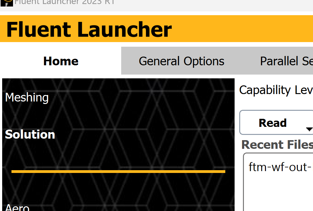

Fluent Launcher Crashes when clicking on Meshing
    • adrian.sieradzki
      When clicking on the option Meshing the launcher crashes
      However I can get to it when using space claim and clicking on watertight geometry workflow.
      Clearly something wrong with ansys 2023 because I could launch meshing normally before.
      Does any1 know how to fix it or alternatively
      Does any1 know which executable is spaceclaim pointing to?
      Thank you
    • Sunil Lilhare
      Hello, to resolve this issue please try to reset the launcher by clicking on Reset button available on the Ansys Fluent Launcher and then restart the Launcher.
      • adrian.sieradzki
        Thanks. This worked.
        Also can launch Fluent directly into meshing with 3ddpg -meshing arguments
