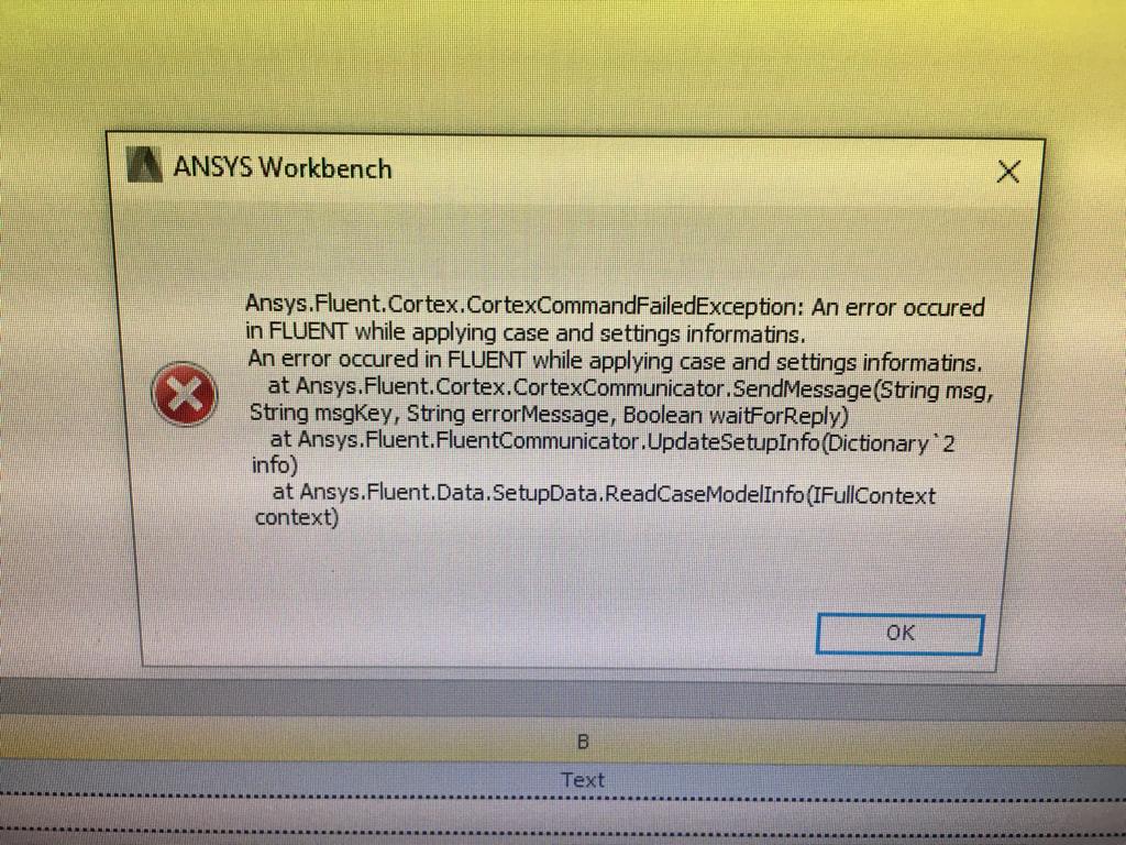

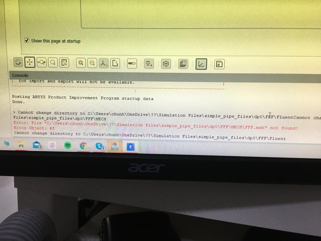

I had been using ANSYS as CFD simulation. During once I had copied files from the school (19.2 ANSYS) that able to run on my laptop, while I cannot run on my desktop. Saying that there is an error on running the Fluent. I am sure I had all the previous file with me as I could run it in my laptop.
After reinstallation, a few files named cx2010.exe or something else in this pattern, forced me to install to ANSYS. I though it was a mandaotry files so I pressed install. After that I cannot open Fluent anymore.Â
I had tried to reinstall ANSYS twice while ANSYS insist to showing the error, as well as I cannot quit the programme even I tried to run ANSYS in an "errored" way to ignore those strange part as shown.Â
Does anyone have this problem and told me how should I do?

Ansys EmployeeTry moving your entire simulation files to be under C:Temp
Then open Fluent and load the files from there
