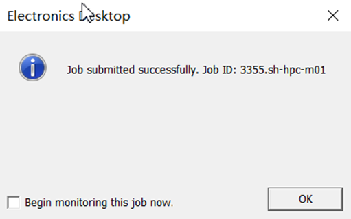

      When I submit job by:Anasys >Setuo>Submit Job… ,it works well that can submit job to PBS scheduler and complete the simulation.

      Once you click on “Submit Job”, the model and setup specified in the “Submit Job To: …” window will begin running. There is no need to select Analyze at this stage.
      You can monitor the status of the calculation using the Monitor option available under the Simulation tab.
