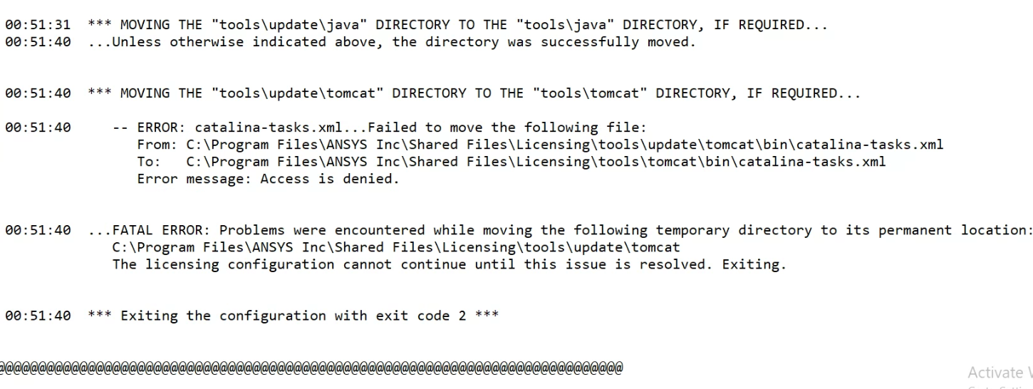

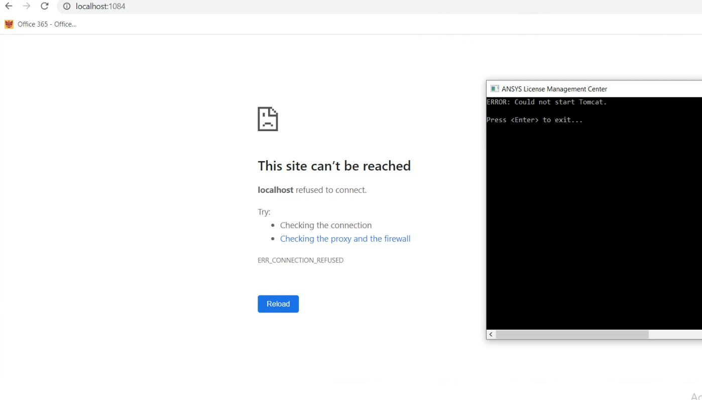

      Ansys License Management Center used to work fine on the desktop. However, when I tried to share the floating license and check the usage of the licenses, it showed it could not start Tomcat.
      I have also checked the port number which is exactly 1084. I have also tried to re-installed the Ansys license management center but it still showed the same thing.

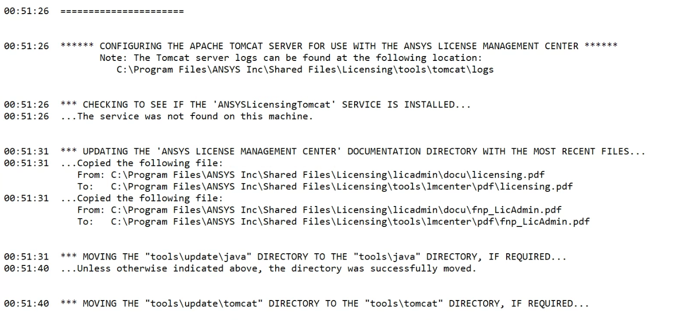

      The error log from installation:
      Tomcat:
      When I clicked tomcat9w.exe from Ansys Inc\Shared Files\licensing\tools\tomcat\bin, it showed: the specified service does not exist as an installed service. Unable to open the service 'tomcat9.'
      It would be appreciated if you could let me know how I could fix this. Thank you for your time!
    • George Karnos
      When installing, try :right-click->run as administrator
      Then try right-click->run as administrator  when opening the ANSYS LMC
      • Ciel16
        Hi George,
        Thank you for your reply. It works for me :)
        Have a good day!
