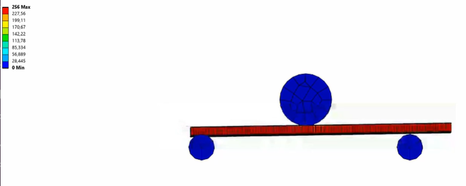

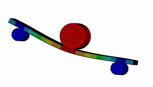

Here’s what I’ve observed in the simulation:I am testing a sandwich panel modeled with solid elements (SOLID) in a 3-point bending setup. The supports are cylinders, and I applied Remote Displacement to impose their translation.
When I set the contact between the cylinders and the sandwich as “totally bonded”, the simulation works even for relatively large displacements (e.g., 10 mm).
However, when I switch to contact with friction, the simulation only converges for small displacements. Beyond about 8 mm, it diverges.
I have added photos showing:
the case when the simulation diverges
the case when it converges

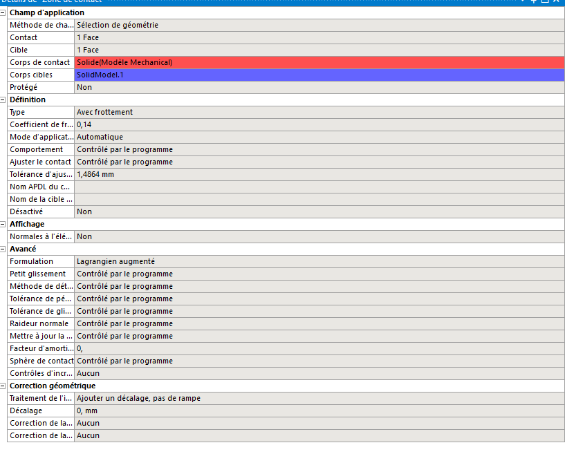

how I defined the contacts
Could someone advise what parameters I should modify to make the simulation converge for larger displacements with contact and friction?

For this I recommend using 1/4 symmetry (as used here in this paper: Modeling Flexural Failure in Carbon-Fiber-Reinforced Polymer Composites) – as it is unstable.
Then when that is done, look on maximum substeps and general nonlinear convergence (say adjust to touch, normal stiffness,etc.):
https://www.youtube.com/watch?v=O-qTAiE8Kdo&msockid=8b77ec91c91e11f0a1f421c682991185
https://www.youtube.com/watch?v=sZf5p_evqOkFew videos out there that should help.
