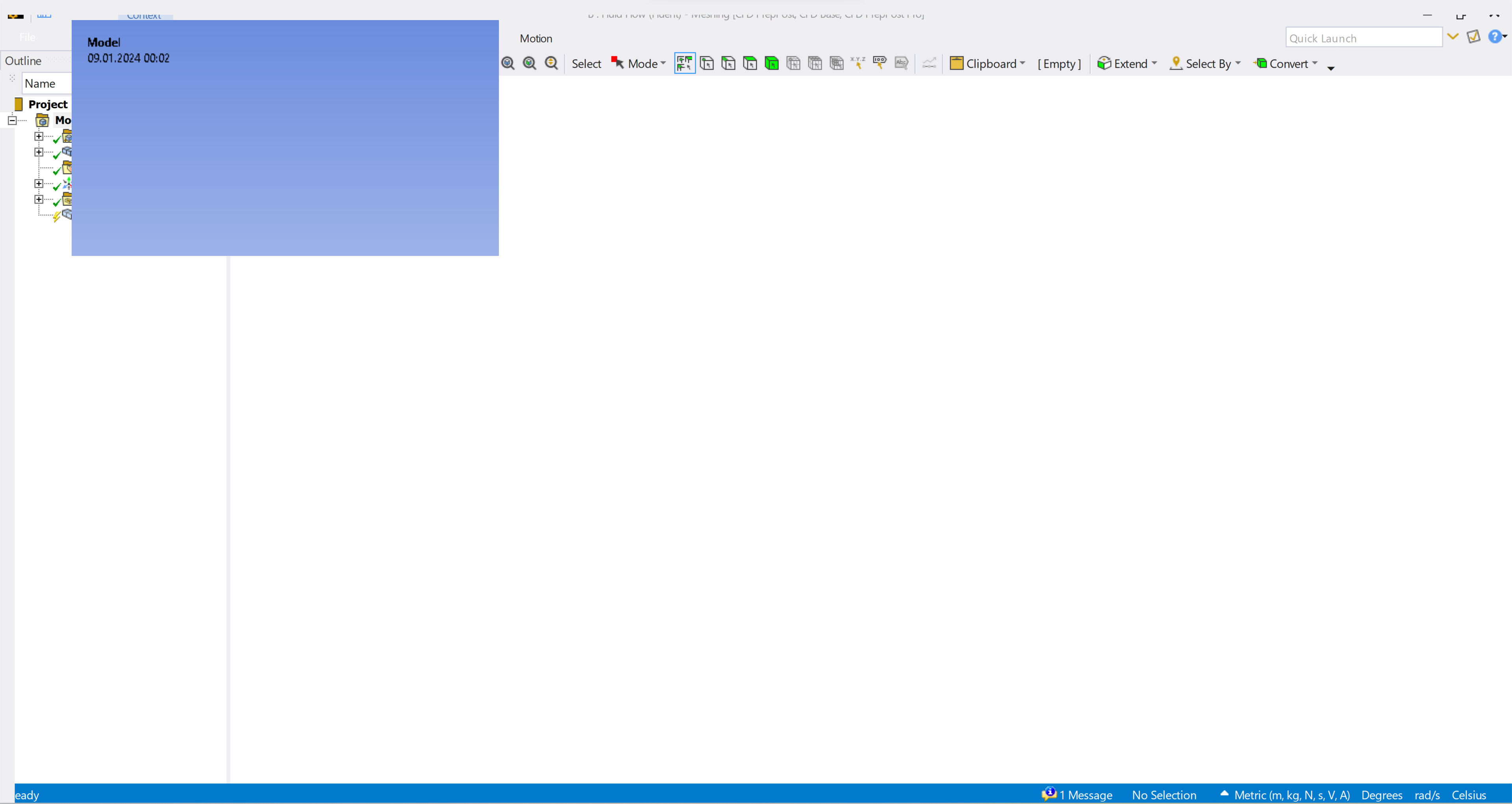

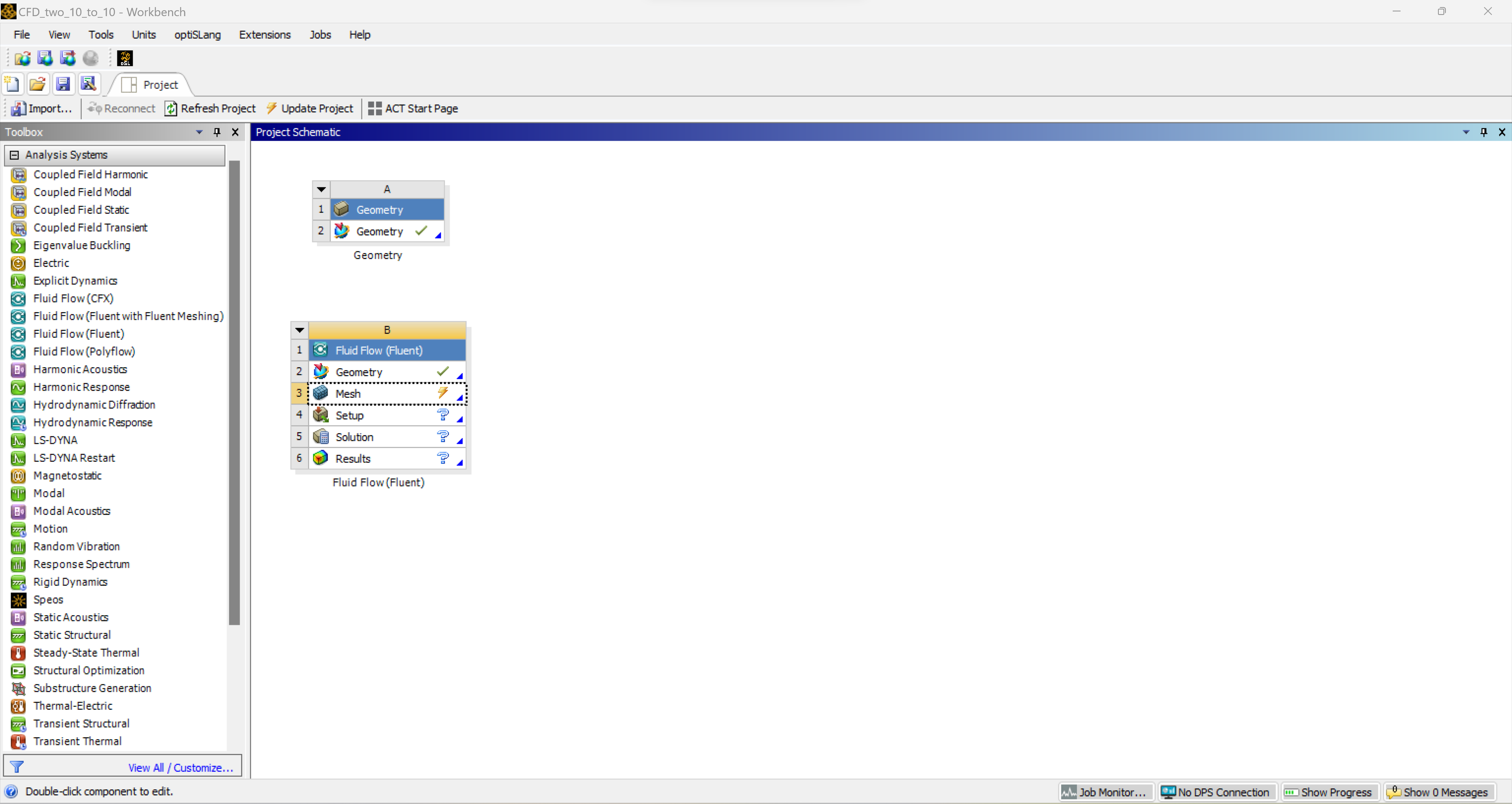

      Hello, I have a display problem that appears as I try to mesh for Ansys fluent. The software opens a second window which isn't scaled as the workbench is. I've tried to modify the DPI settings but it only affects the workbench and not the fluent console. Following is a screenshot from the workbench:
      Here is a screenshot when I am trying to mesh:
      I've also tried to rename the vxxx file from %appdata% to vxxx.old but it hasn't change anything. I ctried to change the DPI settings of every Ansys application. But hasn't change anything either.

      reducing the resolution (try 1920 x 1080) and then also adjust your windows scaling settings, reduce the scaling to 100% is the only solution working.
      It is howerver very annoying beacuse every other app doesn't scale properly then. Do you have another solution so I don't need to change the scale of the screen every time I am working with Ansys?
      Thank you, Samuel
