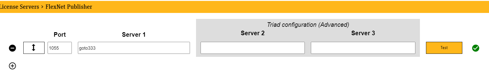

Maybe the port is not the problem. Because the student' PC connected professor' PC with a port. And I tested it. It is OK. Please see the attached photo 1.
And the student's PC can run the software before. But suddenly the PC can not run the software. It is so strange.

March 30, 2023 at 2:07 pm
ANSYS_MMadore
Forum ModeratorThis does appear to be a Vendor Port issue or firewall issue. The message here tells us that it cannot connect to the ansyslmd process.
  License file(s) on goto333: C:\Program Files\ANSYS Inc\Shared Files\Licensing\license_files\ansyslmd.lic:
  goto333: license server UP (MASTER) v11.17.2
Vendor daemon status (on goto333):
 ansyslmd: Cannot connect to license server system. (-15,10032)

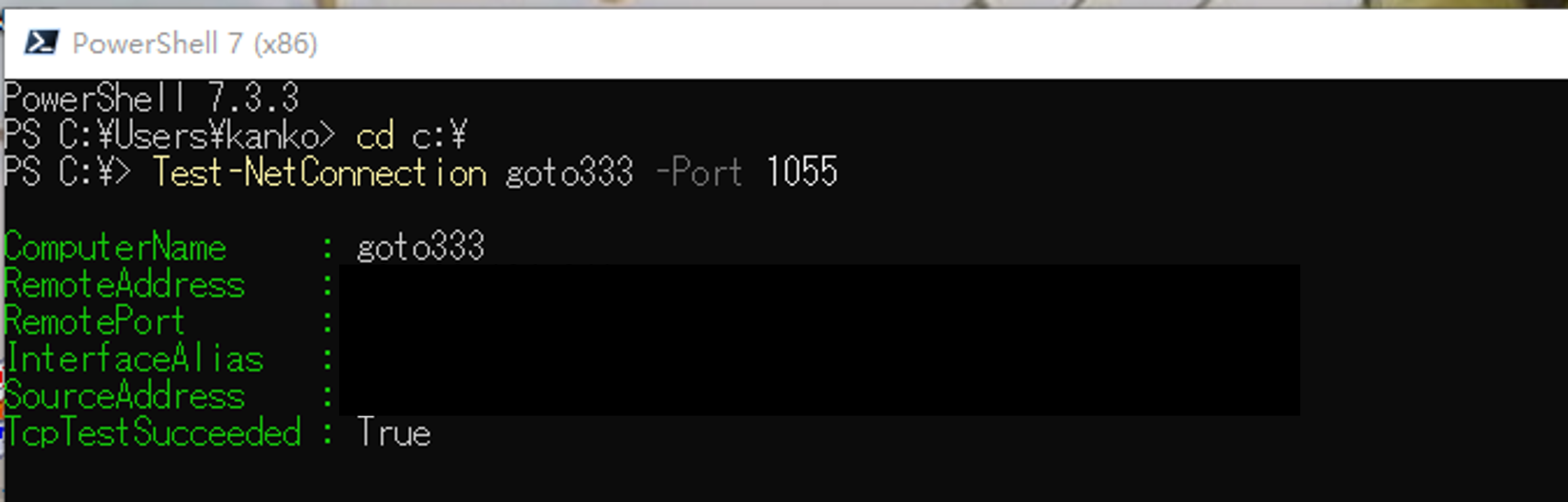

April 4, 2023 at 10:57 am
ANSYS_MMadore
Forum ModeratorThe issue is still with your connection to the "host" on the ansyslmd port. Please check the port that this process is running on on the host machine, then try testing your connectivity to it directly. Run this command from a Windows Powershell window on your client pc, replacing the xxxx with the port the ansyslmd process is running on on the host machine.
Test-NetConnection goto333 -Port xxxx
April 4, 2023 at 11:26 am
April 4, 2023 at 11:31 am
ANSYS_MMadore
Forum Moderator1055 is the port for "lmgrd", I need you to test the port being used for "ansyslmd". By default the port is dynamic and changes with each restart. You will need to ask the person running the host machine to check which port is being used, then test that port.

April 4, 2023 at 2:29 pm
ANSYS_MMadore
Forum ModeratorYou will need access to the host pc. In the C:\Program Files\ANSYS Inc\Shared Files\Licensing\license.log file look for the text "ansyslmd using TCP-port". That will tell you the port ansyslmd is using.
