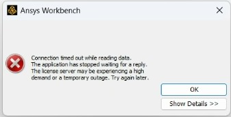

      Hello
      One of our users of Ansys 2024 R1 has recently been migrated to a new VPN, but is now experiencing a delay when opening an Ansys application when remote.Ansys displays status of ‘Checking Licenses..’  for approximately 5 minutes before it finally opens. When it does open it works without issue. Ping response to licensing server is approx 45ms and test connection to server does get green tick.
      Has anyone experienced a similar issue, and were you able to resolve?
      Thanks

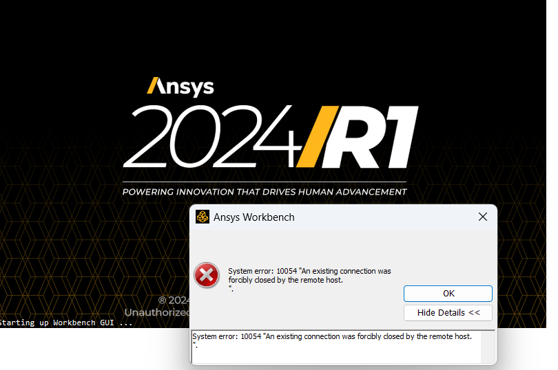

      We applied the settings you suggested, but it didn't work and now we have an error that we didn't have before. (10054 "An existing connection was forcibly closed by the remote host)
      We reverted the changes but the application won't open now at all. Any idea on how we should proceed from here?

      Also, check if the Ansys Client Licensing log files in %temp%\.ansys. Show errors which match the pattern:
      HANDSHAKE_ERROR                                                                                                                                             Could not make an SSL handshake with client 7604:127.0.0.1System error: 10054 "An existing connection was forcibly closed by the remote host."

      We tried renaming Ansys folder again, but it's now displaying a different error:
      The handshake error in the licensing log files: HANDSHAKE_ERROR                                                                            35368:GRANTA_SIM_MAT_DATA:e16010557@8FM4HX3:winx64
              Could not make an SSL handshake with server *****@127.0.0.1.
              Connection timed out while handshaking with the server.
      This is no longer a remote issue, as it's now not opening when onsite. We are contemplating a reinstall of the software.
